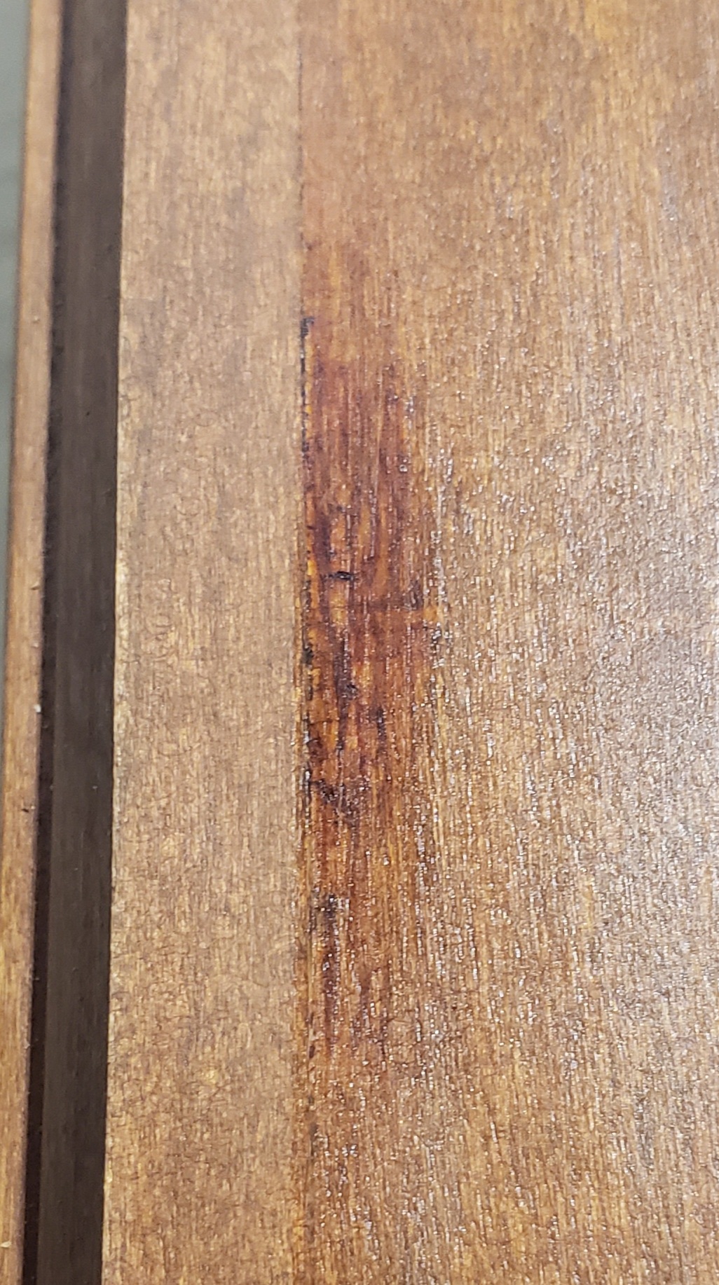

I'm trying to use Mohawk's brush tip graining markers and having issues with topcoat affecting the "ink". It make it look wet and much darker than when I applied it.
I am trying to use the markers over a catalyzed sealer, then topping with catalyzed clear conversion varnish. (my standard topcoat) I have also tried Mohawk's clear spray lacquer with similar, although slightly better, results.
Is there something I can apply to the affected area to lock down and seal the markers, then top coat as usual?

First, stop sanding through the veneer. Second, stop experimenting with product on a piece of the product, and third, if it's darker when you top coat it, go lighter shades of the markers. I also suggest you get professional training on faux painting. The markers are too wide to mimic wood grain. You need to learn how to use air brushes, flogging brushes, and really the whole tool set that faux painters use. You also have to learn how to fog on dry coats of finish to prevent bleeding. In my shop, that panel goes to the garbage and is remade. Said in another way, until you become a faux painting artist, replace the damaged panels.

its been my experience that you need to have clear coat on the surface before coloring damaged areas, unless its a really dark color. This allows you to go darker or lighter if you need, and there's no replacement for using the original color/stain and topcoat. the marker sets are for field repairs when the original/compatible products aren't available.
