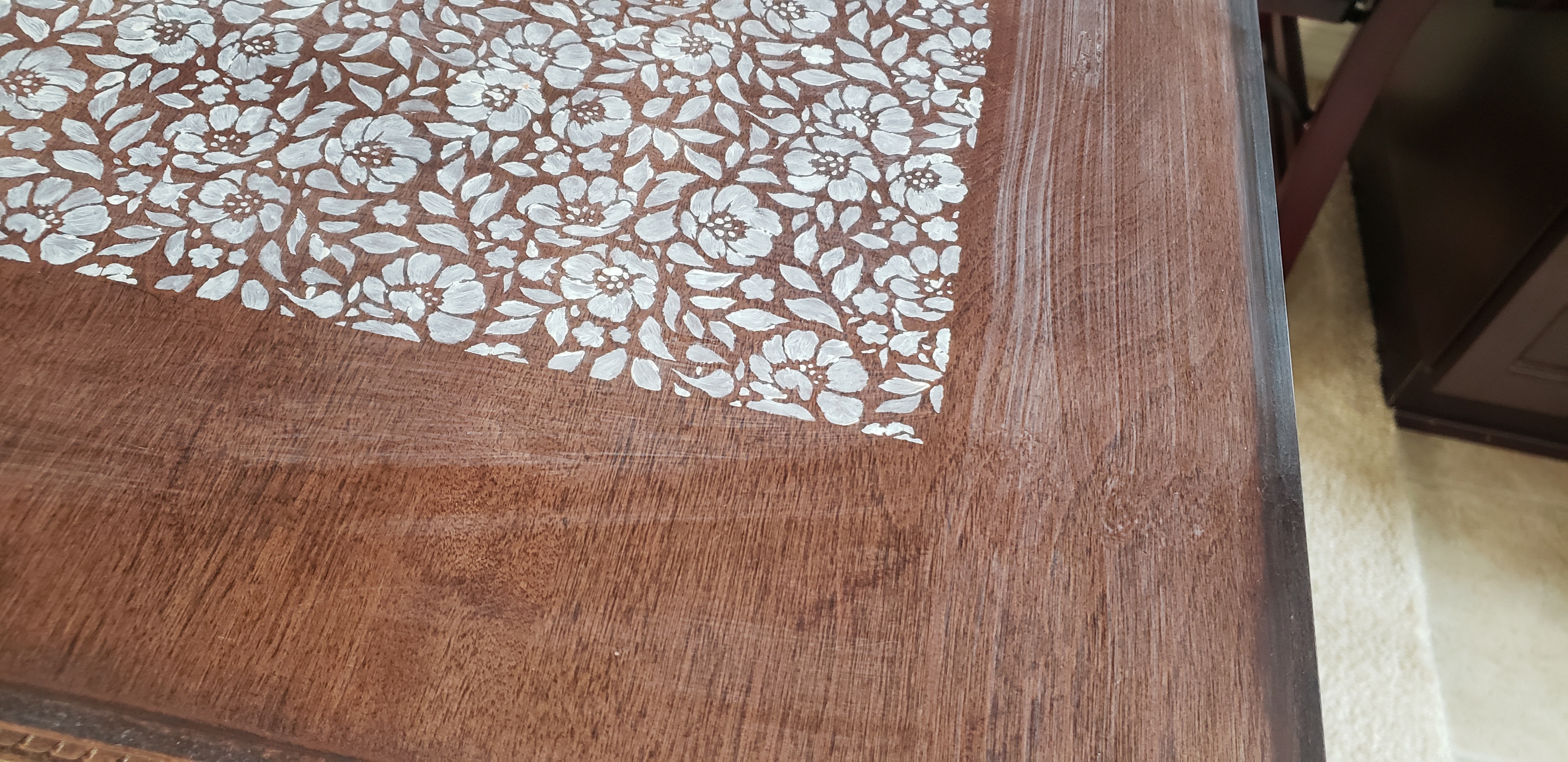

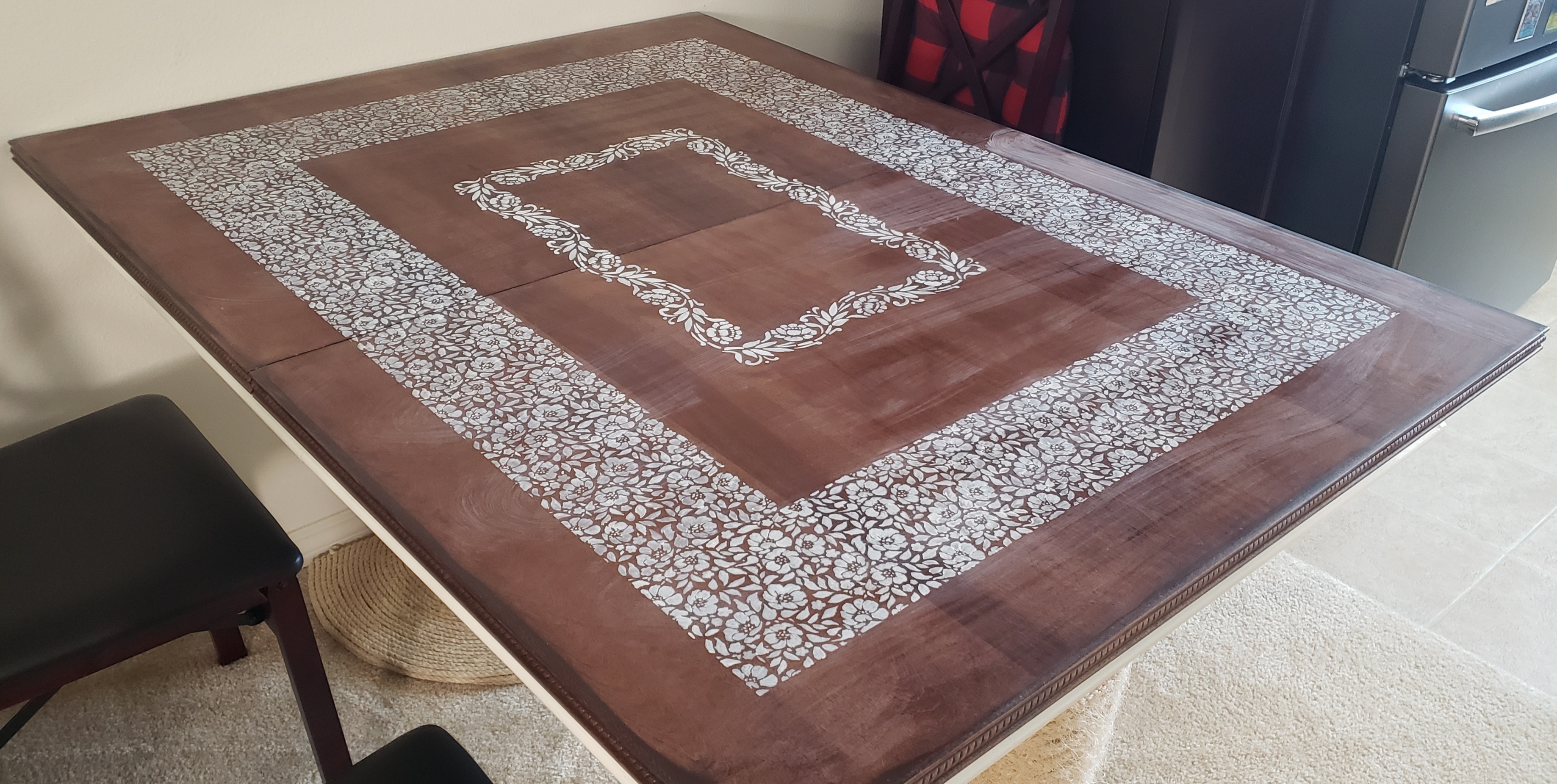

This table was stained with Varathane Classic wood stain, the paint is Behr Ultra semi-gloss acrylic (left over from another project) , and sealed with Varathane Ultimate water-based Polyurethane, crystal clear gloss.
It was recently exposed to an alcohol- based disinfectant wipe, and I'm wondering what's the best way to fix this?
Ideally, I'd just strip off the finish, but I haven't found any strippers out there that wouldn't also strip away the paint +/- the staining, unless someone has a homemade recipe for something like this? Otherwise, I'm thinking sanding off the finish, although that will likely affect the paint as well, so I'm not so keen on this idea.

This is a professional finishing forum. Not sure why you're here. But here's my 2cts.
Man that's a mess. So let me get this correct. You have a cheap DIY stain that's solvent based? A DIY paint that's solvent based and topped with a DIY WB? Well you've entered clown world.
Tape off the flower area off. Use the purple delicate tape W/paper. Sand into the WB finish gently with 320-400-synthetic steel wool.Super light rinse application of laquer thinner after sanding. This should help the trapped moisture to release. Let dry then scuff sand. Peal tape/paper over flowers. Lightly sand w/400 then synthetic steel wool clean and then a super quick rinse with laq thiner. Use a well saturated clean rag or a good quality paper towel. Be quick and don't rub aggressively . Let dry/off gas overnight. Then spray Zinnser De-waxxed shellac Seal Coat. The seal coat is a barrier coat/bridge coat to seal in the disaster and let you finish. One light coat followed up with a slightly wet coat. Not too much of you'll get wrinkling. Scuff between coats. After that you can put any top coat you want to. I'd say shit can the WB for a good marine varnish. Petitt Marine makes great products or you could go with a 2 component WB which is likely out of your wheelhouse.
cheers and good luck

Take the financial hit, learn from your mistakes..!!!
Strip it, start over, use a 2K professional poly next time around, with compatible stain and white pigmented opaque coating.!!

Do not ever clean a wooden surface with alcohol! It will act like acid and eat away at the enamel, stain and then start to eat away at the wood if left unattended for too long.
