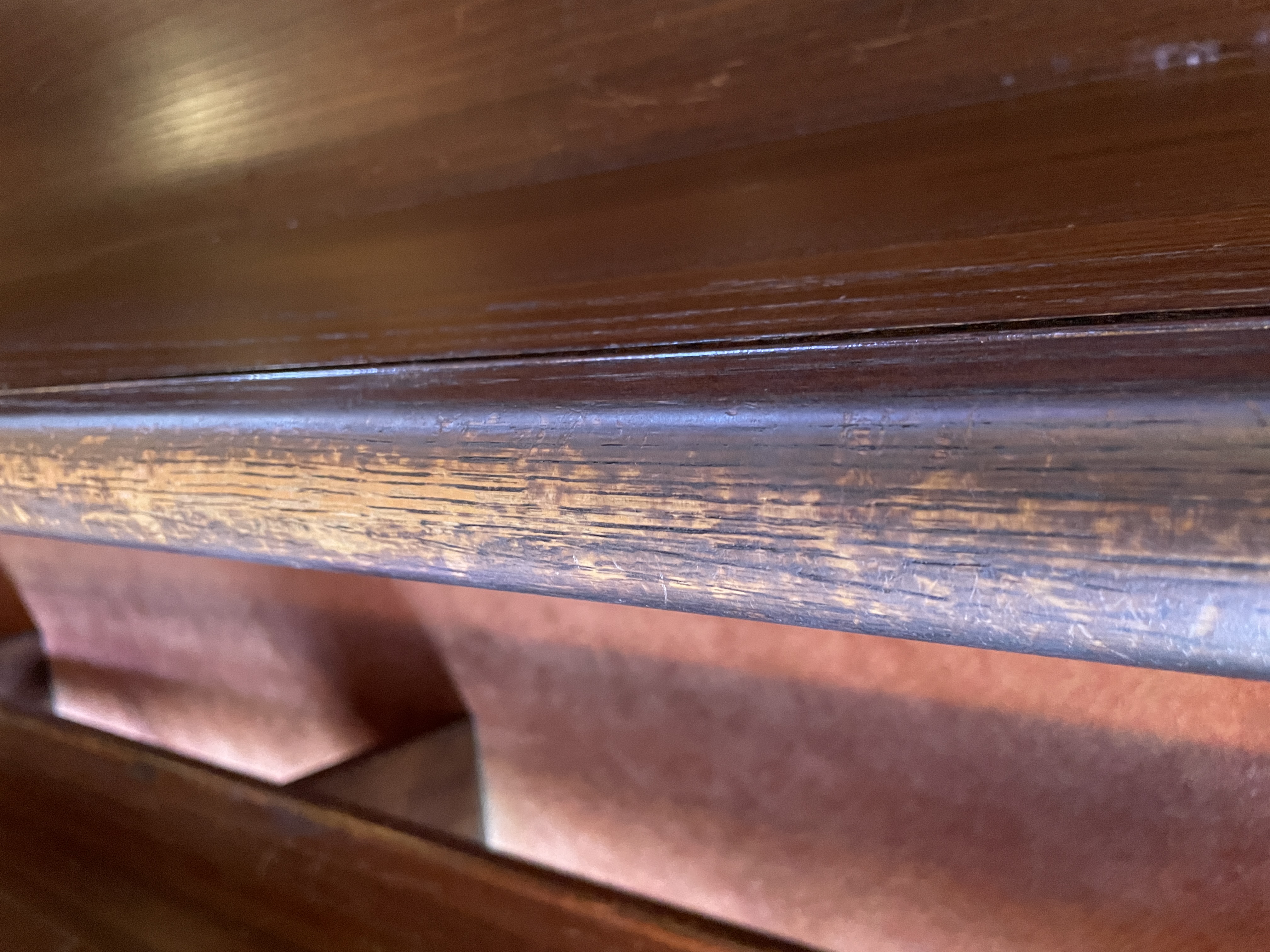

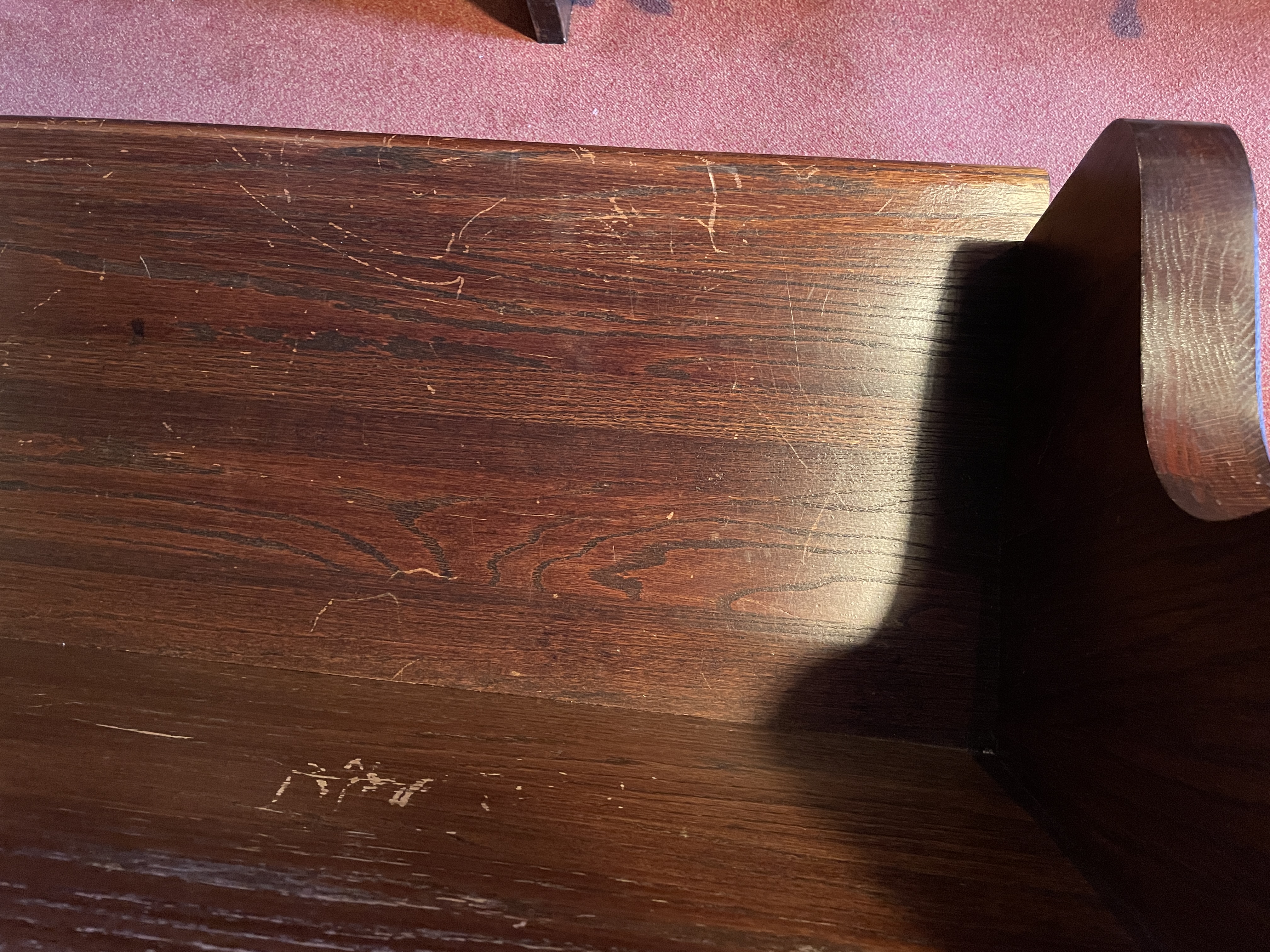

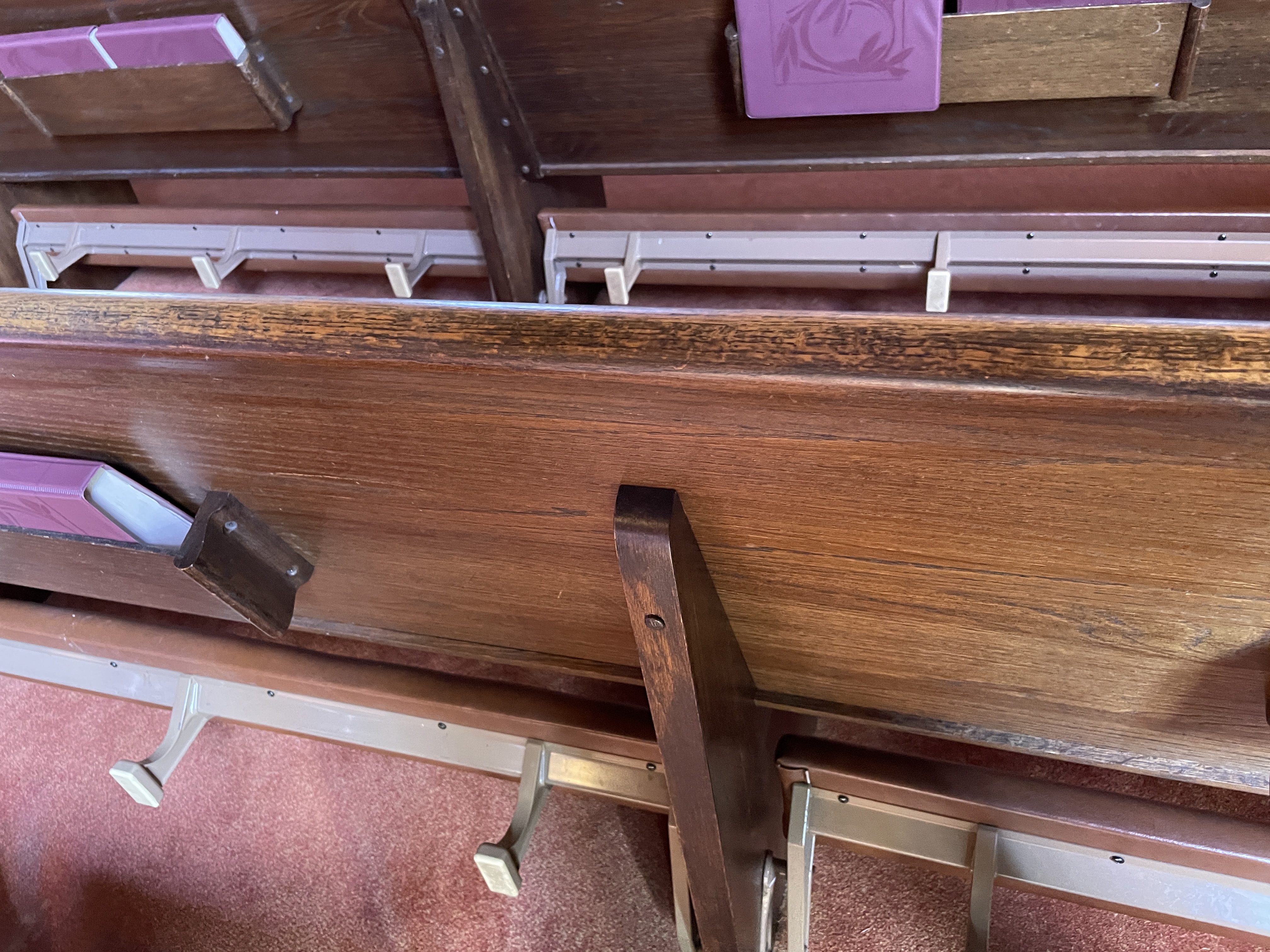

Looking for suggestions to touch up church pews which have scratches and lost color over the last 20 years!
Hoping to find something that can be done in place, which will improve the looks without doing a complete refinishing. I haven’t tested the finish so I don’t know what was used originally , but looks to me like a tinted finish.
Any suggestions will be appreciated!

Leo G
All those scratches and wear points are going to take lots of man hours to fix. Not sure what might be easiest. Taking out a few pews per day and fixing them up at the shop by stripping and refinishing.
Or maybe Mohawk Markers to fill in the scratches and coat with something compatible.
Nothing but strip and refinish is going to make them look newish.

Al
I would sand the top rail with a power sander with vacuum hook up. Sand it to bare wood. Where it meets the face side of pew back be careful and do that by hand. The back side of rail should not be a problem because it has overhang. Get a stain as close as possible to do top rail and use this to touch up seat scratches.
The top rail of pews took a beating during Covid because they kept spraying that part of pew with disinfectant.

FM
It might be worth trying sanding lightly with 320 and applying a gel stain. It would take a dry brush technique. It will take some practice. But it’s doable. I would be worried about it rubbing off on folks though if not topcoated with something and that opens up a whole new can on worms. Check for adhesion before proceeding with too far. I’d test and sample before committing. But I’m theory doable.

sam pettit  Member
Website: sheldonpettit@yahoo.com
As long as you realize that weeks after you finish doing whatever you decide to do to the damages, every thing that has not been rejuvenated/repaired, will continue to get damaged and make your efforts seem of being a waste of time, which it will be.... I would test to find out exactly what the finish is.!! For the few churches we did in the Chicago and suburb areas, where the finish was either lacquer or varnish types it was best just to take them to a stripping facility on a Monday, 12 at a time, and sand & finish them on Tues. through Thurs., and reinstall on Fri.! If you decide to go this route, then you can dye and stain the wood itself, which will make future touch up/ repairs, much easier, as well as much more professional...!!
