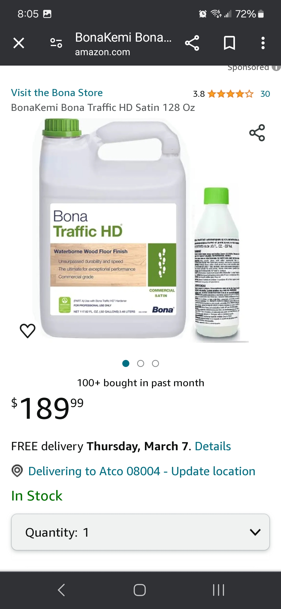

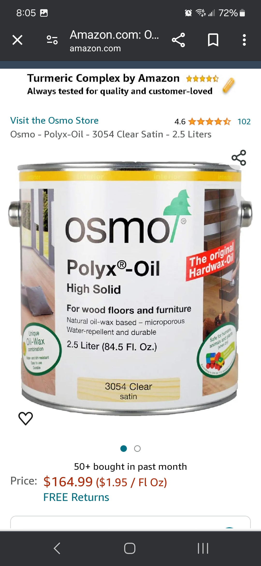

Thanks for the input so far. Just for clarification, I am a finisher of 34yrs now. 2 more and I'm dropping back to a Tu-Th schedule. I have no desire to sit home.
We are museum fabricators w/ a global presence. This particular project is so large that it will have a small in-house maintenance crew. My initial thoughts were down & dirty Minwax. The design team wants no ambering. My personal choice would be a 2K for sure, it's durable, but as said, there will be a lot of people passing thru the spaces.
I went thru my notes and found we did a project about 6 yrs ago where we used Bona floor finish from Sweden. It was very durable. I did not hear any bad remarks from the clients.
Looking online I also found Osmo wax. It gets very high ratings from woodworkers. Have any of you used this?

2/28/24       #6: Finishing opinions ...
I've heard about the durability of Bona, but don't know about recoating but I assume it's as simple as a scuff and apply.
3/1/24       #7: Finishing opinions ...
I would go with a waterborne floor finish. Ticks all the boxes. Clear, extremely durable, easy application. The Bona is easy for anyone to purchase in the future.

Thanks for all your thoughts. We're going to go with the Osmo. My original thought was to show 3 options, Minwax, Osmo and Bona.
But past experience in this arena shows if you give 3 options, you'll beget a request for 3 more.
So, no go.
Also, the Osmo had a decent # of + woodworker reviews and appears to be the easiest to refresh down the road. The dog and pony show is on the 27th. I'll post the feedback. Thanks!
