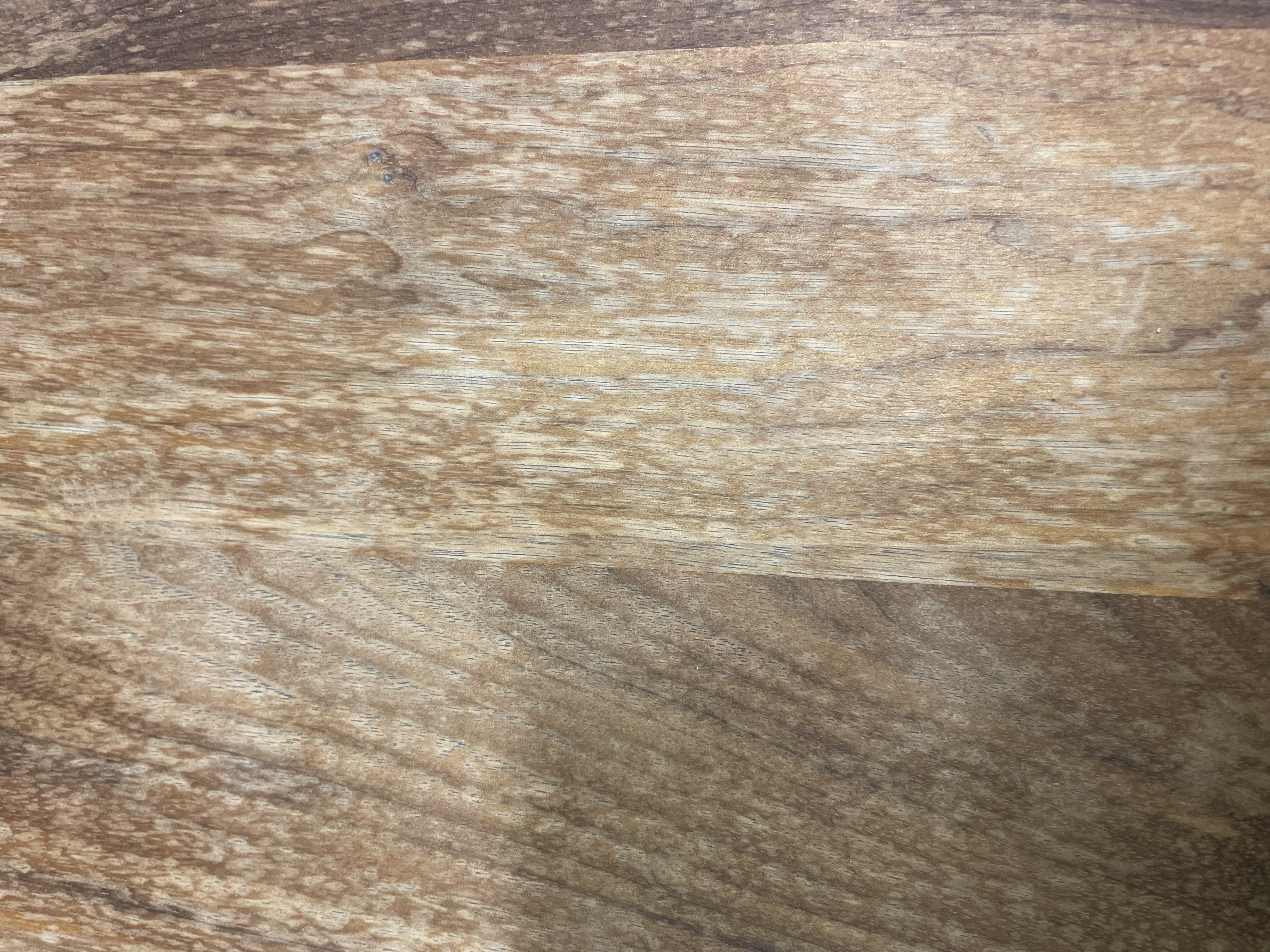

I have a solid walnut table that has white marks in it that I cannot seem to get out any help

Looks like a refinish job to me !!

Old finish has failed. Bob is spot on.

If you have already stripped the old topcoat off, then that is likely water damage from the old finish having failed. I would try oxalic acid.
