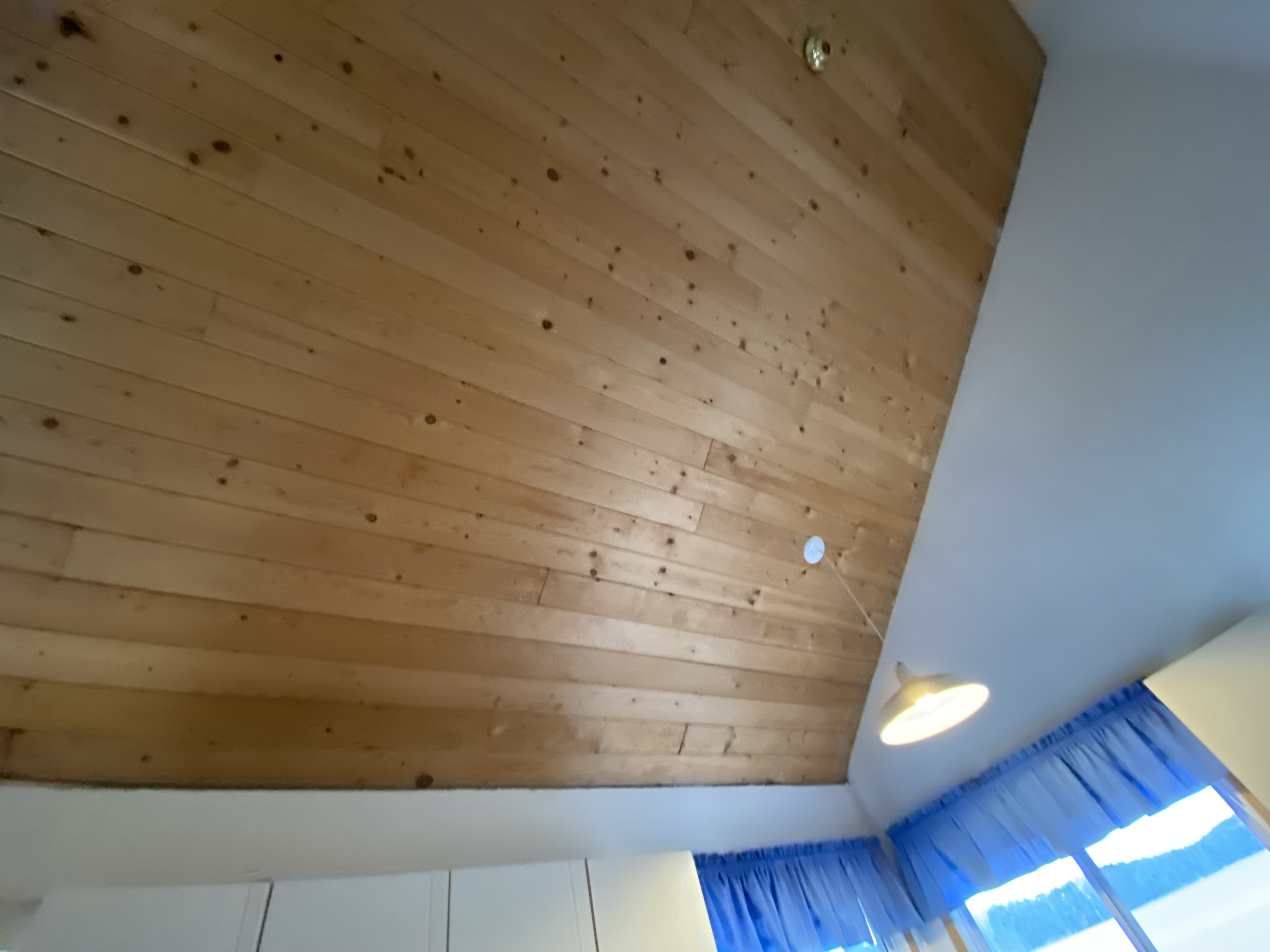

I have a pine board ceiling that was installed probably in the 80's. It has a clear coat of finish on it.The customer would like to make it darker, without painting it. I asked around if I could use a varnish that is a darker colour than the existing one (now it is clear). But I'm being told that I will have a problem with "overlap marks". The ceiling is 13 feet by 25 feet long. I was thinking of doing a few boards at a time, on the entire length, but when I start my new section, chances I will overlap the previously made section. Is there a product that would make it darker (not black) and avoid the overlap marks? We just would like it 1 or 2 tone darker.

You can brush it without too much visible overlap, just do no more boards at a time than it takes to keep a wet edge

Use a solvent based glaze.

If you are just going a little bit darker I would suggest adding a small amount of pigment to whichever clear finish you are using. Home depot is usually a good place for things like this, talk to their paint guy and try 5-10 grams of brown pigment in a clear base. If that's not enough go back and have them add a little more. The small amount of pigment needed for a small color change should blend well enough that there are no overlap marks.
