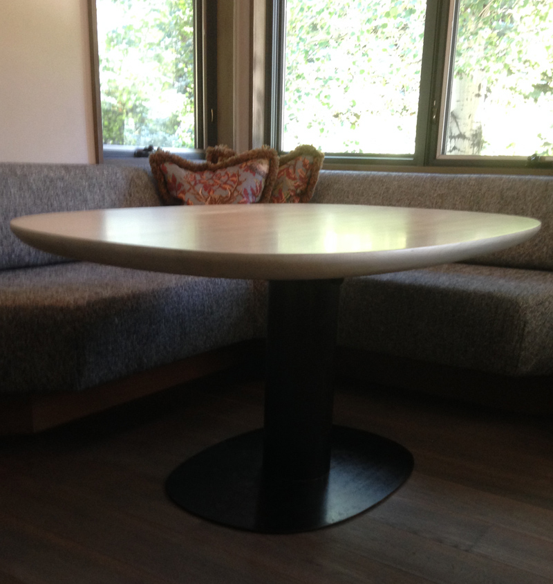

duster
I made this walnut table and used a 2 part bleach on it. It was pretty easy to do, but as Pete states, you don't have a whole lot of control on how intense the bleaching ends up. Perhaps you could dilute it a bit if you were looking for a reduced bleaching effect. I would definetly do some samples on scrap. We did some samples, and noticed that the bleach was raising the grain.
Since were were looking for a smooth finish, we sponged water onto the top, let it dry overnight and the sanded it smooth again before bleaching. This seemed to help a lot.
The client loved the final result, but to me it was a desecration of $1200 worth of walnut.
