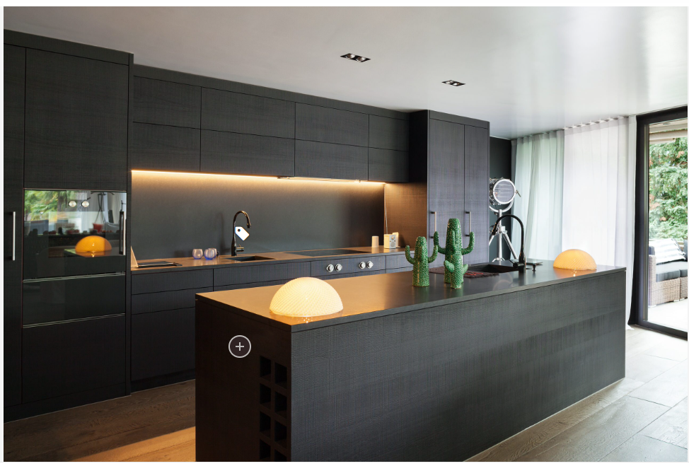

Hi
Can anyone help by telling how to achieve the finish for cabinet doors/kitchen island walls as in attached photo ?
View higher quality, full size image (974 X 659)

Looks like wire brush machine. But the picture is too small to get the details out of it.

Resawn veneers, black stain, flat finish.
Dont do it, it would be impossible to clean and the high points would wear through the finish over time from daily use.

Yeah some jobs are best to pass on . You will occupy a lot of effort with not enough gain , it usually isn’t worth all the effort you will have to invest into it.
Most will not understand the time this will take and you won’t be compensated for all your time.
By passing on it you’ll leave space for a more productive job .

Arun, It is not a wire brush effect and it is not re-sawn veneer. Most likely it is a fumed, figured veneer. It could be Eucalyptus.

Find a textured melamine or HPL that looks the same.

If you really want to take this on . I would try my best reproduce the canvas flat black applique.
First I would use Tinted / black White glue and squeegee out excess when laminating on the canvas . Followed it up with a few coats of tinted sealer / black toner .
Top coated dead flat . CV
Def would have put in time getting my samples down on this , but like I said before make sure you get compensation for all this time .

Thank you all for your responses.. Really appreciate .. yup looks like a lot of work.. Will try out a sample based on all the above points.. will get back ..

So it's definitely not impossible and surely not as hard as everyone makes it sound, depending on your finishing experience. Depending on your budget there's multiple ways you can achieve that look. Wilsonart makes a woodgrain laminate in an ebony oak wood grain you could use. If you're going to go with a veneer I would suggest using a vacuum bag to ensure you get a flat surface. If you can't go that route may I suggest rolling out some wood glue on both surfaces let dry and then iron on. Then you could go with a variety of wood species from Walnut,oak, mahogany, something obviously with lots of long grain. Then stain it with a black ica spray water stain, or a black spray solvent stain whichever your more comfortable with or have available. Sanding sealer and a coat or 2 of a flat finish and I think you're good.
