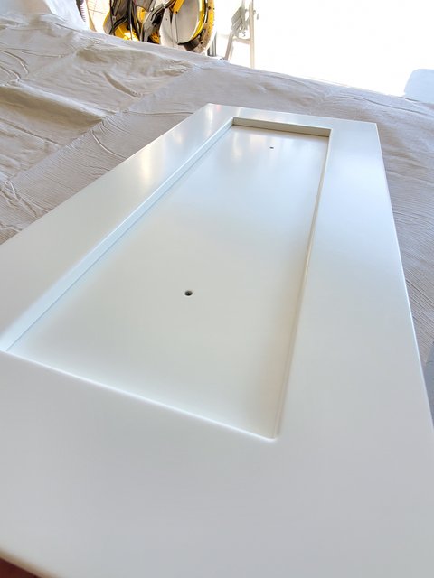

Yavuz
Hdf surface . 2k primer and 2k color coat
