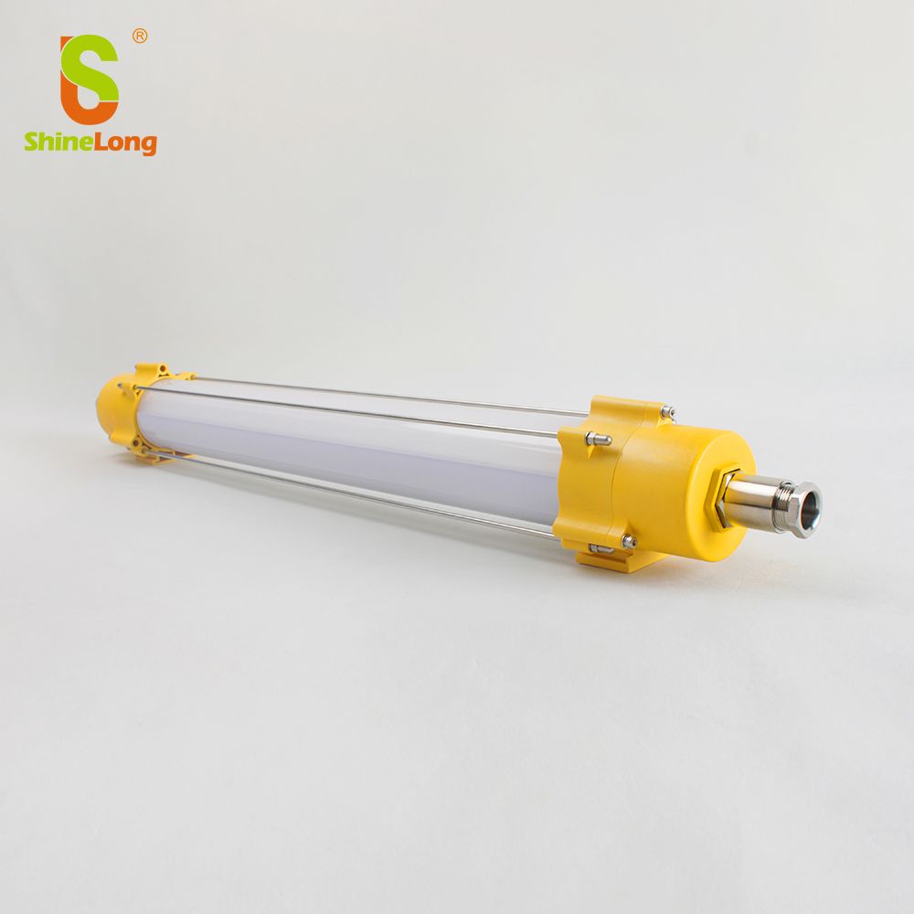

If you're sure you need explosion-proof lighting, I'd recommend going with high quality, once and for all.
View higher quality, full size image (1000 X 1000)
ATEX LED Explosion Proof Light
