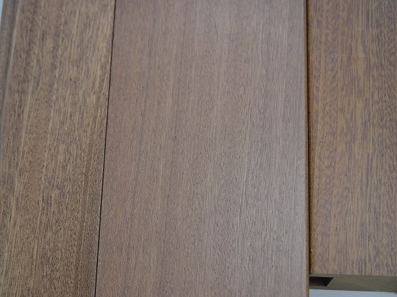

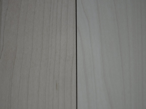

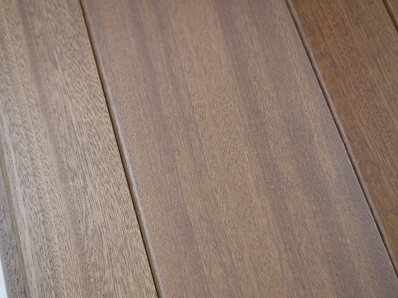

Here are a few pics. The problem wood finish is the piece in the middle, control samples to each side. Note the grey-pink haze, all the grain definition and wet look is gone. The maple lost all amber overtone, the finish made it bone white.
Looks like someone mixed dog crap with mud and shot it on. Can you tell I am upset about this?

Doesnt look like blush to me. Whenever i've had blush its pretty inconsistent, blotchy looking.
What product are you using? I remember there was a precat I used once, when the finish went on too thick the flattening agent would settle and look something like that.
Finished could be over catalyzing, I've seen similar results when thats happened before.

FM
All blushing I have ever seen/had has been when spraying precat lacquer and it comes and goes. It’s not uniform like this across the entire piece. It has an uneven appearance to it. Are you sure he is spraying the same product as the samples. It looks like bad water white finish or more aptly old school water born with the bluish hue. Waterwhite is preferred in many situations. Walnut and to a lesser extent maple are not instances where this is the case.

That said, as long as the finish has integrity (have you tested it for how easily it scratches and done an adhesion test?). These could be solved with a further toner coat or two if the finish has integrity. At least with what is in the photos. No reason to strip if the finish is not flaking off, doesn’t scratch easily, will not pull off with blue tape after doing a grid with a razor blade in the finish.

The photo is not the best, putting a toner over the existing finish would change the color, but the problem is it is already so dull- the wood is obscured, like a a dirty windshield.
Might as well use paint.
The piece shown to the left of the center problem child , is the control sample the finish shop coated a week before, because they messed up the PREVIOUS job. Not so badly, and on a lighter wood, so it was sort of acceptable, but because I could see it, I asked them to make sure it was not going to happen again.
I need a new career. Unfortunately we have some big orders already on the books. Gotta get them done somehow- this is so bad I am actually considering a hand rubbed oil finish on them.....

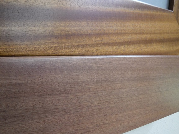

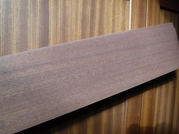

I took two more photos, against two different pieces of sapele.
It looks like they finished the wood with milk. It looks dead. All the reflectivity is gone. Like they turned it into plastic laminate.
