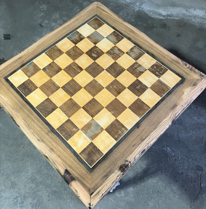

Total beginner here and have never stained any wood before.

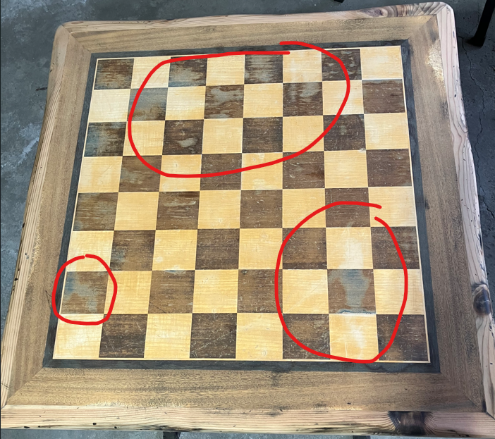

Is it possible to get rid of the milky coloured marks from this chess board table? It's veneer finish and I tried sanding it down lightly with 220 sandpaper hoping that it will get rid of them.
View higher quality, full size image (702 X 623)
View higher quality, full size image (702 X 713)

Depends on how thick the veneer is, as to being able to sand off the damage, if you sand all the finish off, and the whiteness has not disappeared, then unless the veneer is paper thin, and the marks are still there, you can continue sanding cautiously, checking every three or four passes to see if it's getting better. If not then you have a choice of continuing to cautiously sanding till you see your cutting through the veneer. But from what I see, it looks like the coating is affected, and not the veneer..!! You can also first try using a solvent to remove all the finish, but not knowing what the finish is, I can't tell you for sure what solvent will remove the finish, but I suggest staring with Acetone,and if that doesn't remove it, moving on to lacquer thinner, then a past stripper/paint stripper.
