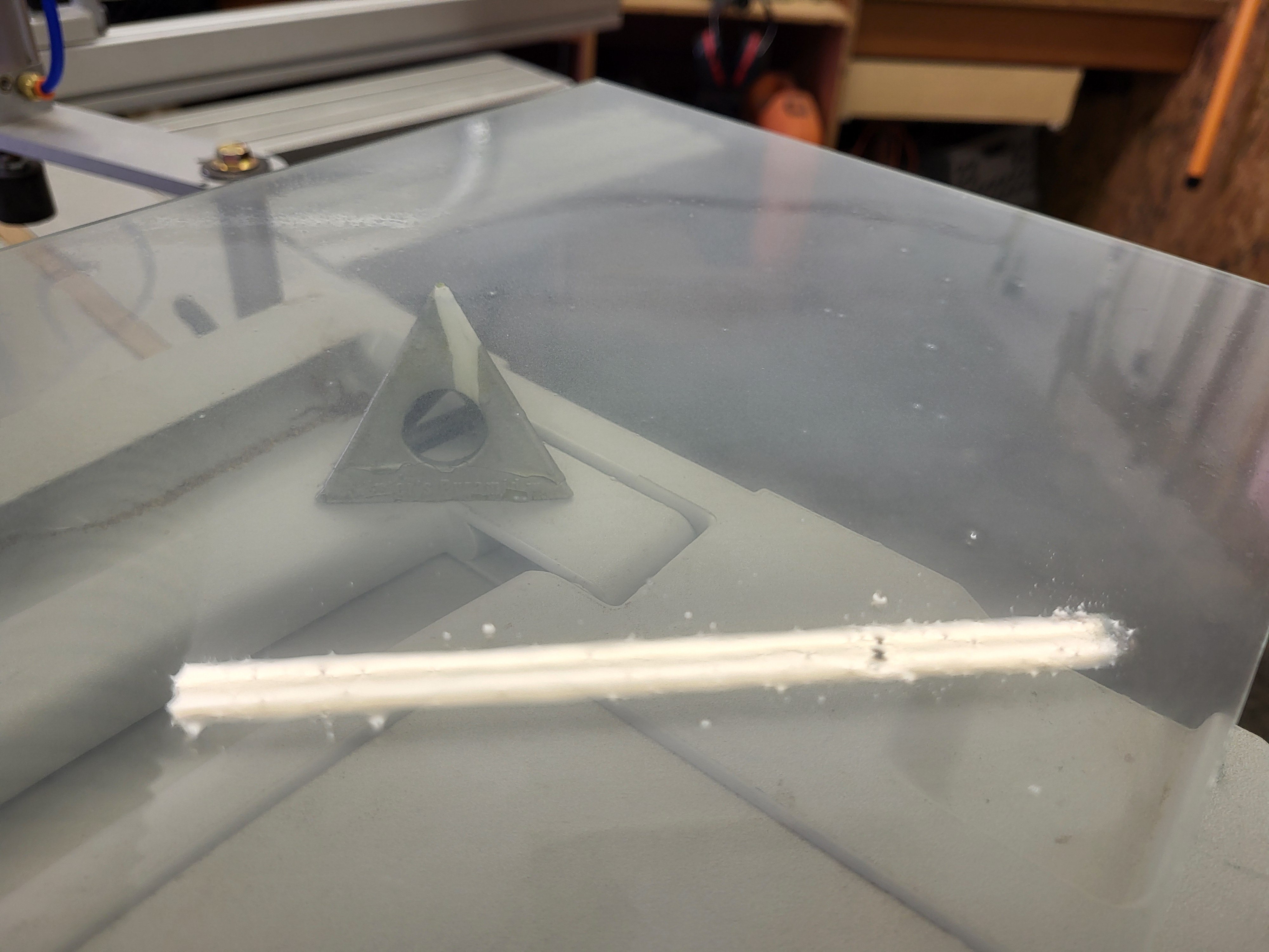

In the last few days I experimented with
a. 1.3, 1.5, and 1.8 mm nozzles
b. tack off with a lint free rag
c. drying with and without air moving
d. spraying glass
e. 15 psi, 18 psi, and 22 psi at the gun with the trigger pulled
The attached picture shows the bubbles a couple minutes after spraying on glass. I didn't see any obvious contamination.
The above iterations didn't give me solid results. At 15 psi overspray was minimal, but the end result was still too many bubbles dried into the finish.
My gut says lower air pressure, increased spray distance, thin coats, and added retarder would be the better of the tweaks, but I can't land a quality finish. If 95% of the bubbles dissipate during curing, the remaining 5% is too many, and it is time to try a different finish.
