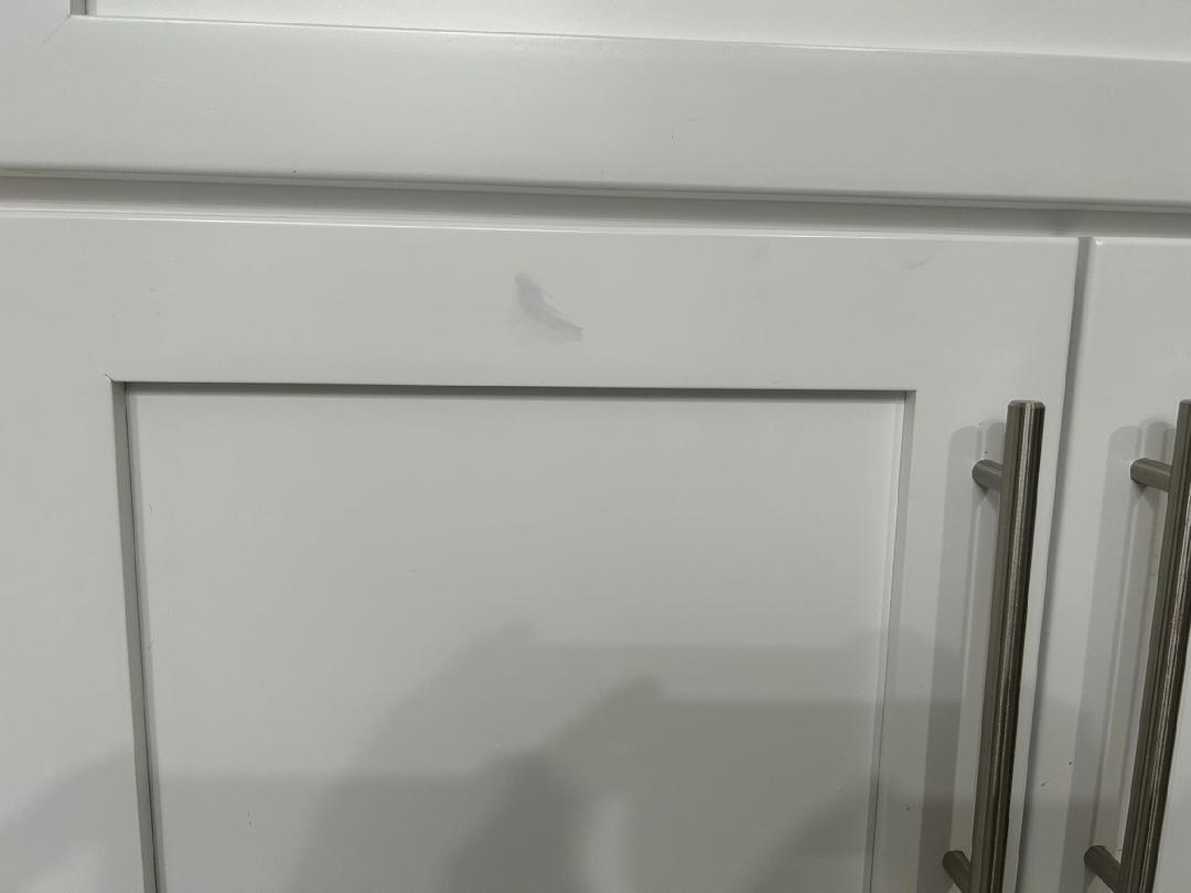

White coating with blue bleed through?

This door has a bluish area that looks like bleed through. This happened on 2 doors under the clients sink. This particular door had the same type spot appear on it previously (in a different part of the door). The door originally had 2 coats of m l campbell kwikclaw primer and 1 coat m l campbell turino in satin. I took the 2 doors back to the shop, sanded them with #320 grit and put another coat of turino on it. Looks perfectly fine going out the door, but then the blue appeared again in an entirely different area than before. Your thoughts?? Thanks in advance.

My guess is this is from filler hardener. I had one job where the finisher used a lot of hardener in his mix of bondo and the blue pigment bled through the top coat. I re-sprayed and it didn't return.
