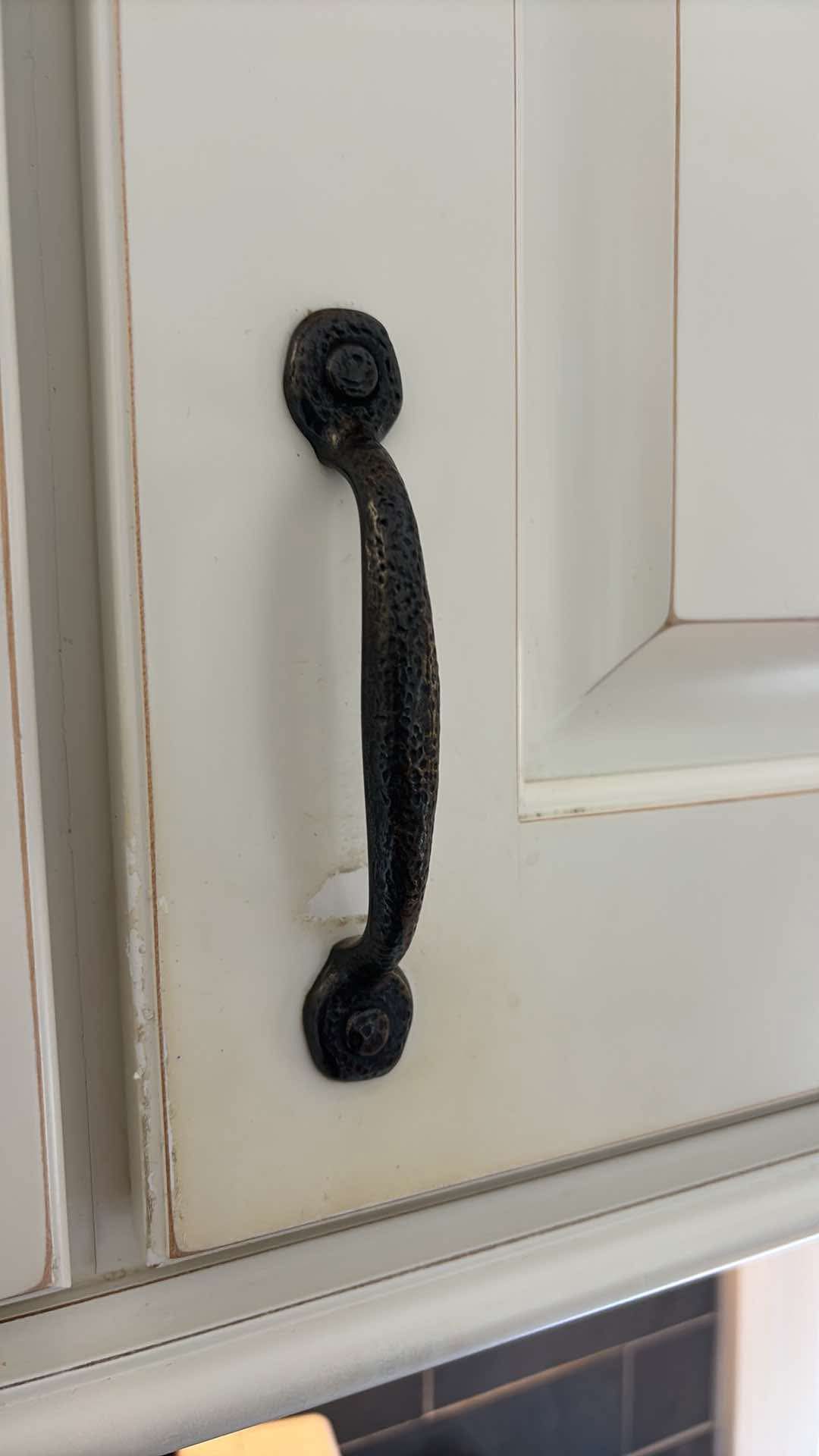

A long time ago I thought I remembered seeing somebody post a link to a glazing tool to get really straight lines like you see in this door. Can someone provide me the information of where I would buy that tool to do the glazing on this Door?

ca technologies out of colorado makes a tjr glaze gun, it is not air feed, it is a gravity feed gun that has extended pencil point nozzle. works like a dream

FM
That pic is not a glaze. They have burned through the paint back to the wood to create that look. You won’t get it with a glaze.

I only got the pics and I thought the exact same thing. Ill be going there tomorrow to confirm.

FM
I’ve been at this 25 years most clients, including contractors and designers, don’t know what they are talking about when it comes to cabinetry. That is a burn through. 100%, no doubt, I’d put money on it.

Fm. I agree with you that it definitely does look like a burn through, but I don’t understand what the glaze part is then. There may be a very light glaze across the entire door that was struck off. I find out the answer is tomorrow. I have been at this for 31 years and 25 years of self-employment so I agree with you that most of the time, customers don’t have a flipping idea what they’re talking about

Fm,
Just as you and I had suspected, it is a burn through. It didn’t make sense to me about reading the part about a glaze, because I don’t see any glaze on the fronts at all. The kitchen is only 10 years old and the finish is literally peeling off. They are MDF fronts from what I can tell. I can fix it, but as I explained to the customer, I cannot put this in my liquid strip tank otherwise I will destroy the fronts. This all has to be sanded out to a degree, chemically prepped and then redone on top of the existing finish pre-catalyzed lacquer products.

jeffa
I don't know how you can burn through the inside corners of the panels. It may be both. The Glaze can stain the raw wood in the cut through and also leave a hang up in the inside corners.
