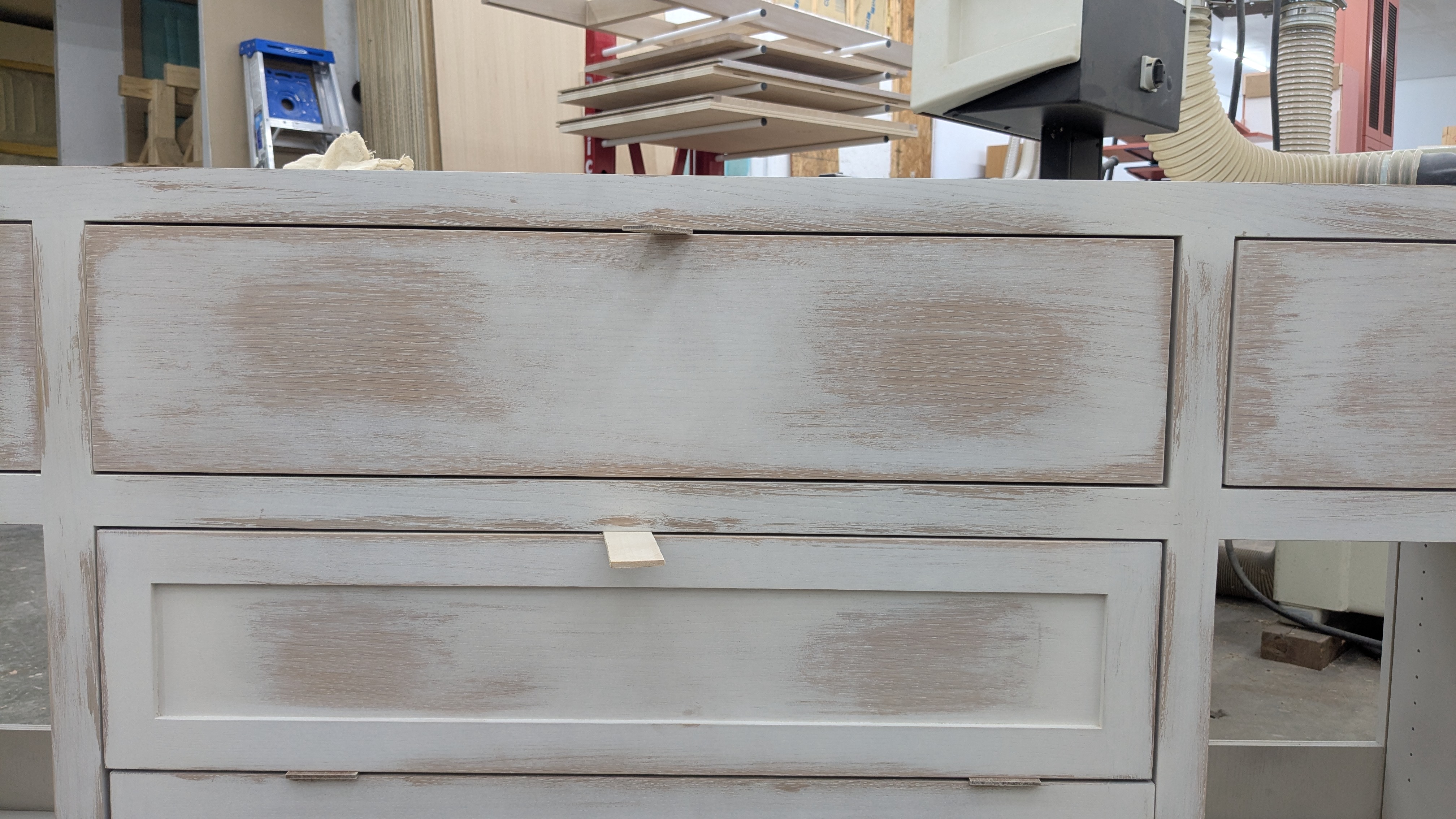

Hello,
I have a project sitting here and I am stuck. Customer asked us to build a rift white oak kitchen island with a antique finish. I made a sample and it worked out good but now doing the actually island I have problems to get the finish acceptable.
I am using all Ml cambpell products. Krystal sealer, amazing glaze and then it will be top coated with Krystal.
I spray on the glaze and after about 5 to 10 minutes I start to wipe off the glaze to make it look used and antique. My problem here is that I get these streaks into the finish and it does not look used.
I have no experience in glazing and I am wondering if my process is wrong. When I start to take off the glaze it seams it's not getting really powder when trying to take it off. Its gummy and wet. Even when I let it sit for longer time it does not change. I like the finish to be more blending in. And don't want these shape edges between raw wood and the glaze.
I hope that makes sense.

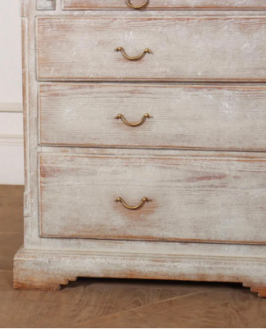

I will attach a picture of what I have right now and what it suppose to be looking like.
Any advise would be very helpful.
Thanks.

You're not starting with the glaze on raw wood?
I don't think you need to glaze it to get the effect.
To me that looks like a light distress on the raw wood and then a thin tinted whitewash coat. Use a dead flat or flat for the initial whitewash. Then hand sanded, synthetic steel wool and maybe a stiff brush. Also maybe looks like they may have splattered some white wash after relieving the white wash before clear coating.
I think I could get it in the ballpark but not exactly like the dresser.

Amazing glaze is suppose to go over a coat of Krystal that has cured for at least 2 hours so it doesn't bite in.
If you are going for the look in the pictures you posted may I suggest using a tinted primer and scuffing off areas with sandpaper and Mirlon pads. After that you can apply your top coats.

Thank you for your responses.
Bart, I will look into the white wash products. When I asked my paint supplier they said that glaze would be the way to go.
My thought was that glaze would be similar to a whitewash product. I will try it out white wash. Thanks for recommending .
Leo, that's a interesting idea to use the primer. I have some mlc Kwik claw primer. I will try it out.
I have one coat of Krystal sealer on the wood before I glazed over it 2 days later. The sealer should be dry.
I was experimenting more with glaze and when I used my hvlp cup gun I was able to spray very light mists over the surface. I did that multiple times ove the same surface and when rubbing it off it gummed up much less.
And I used a triangular bandage from my first aid kit. Somehow this worked well.
I got it this way to the liking of the designer.

What Leo and I are saying is you just need to spray the desired color you're looking for and then relieve the color by sanding, synthetic steel wool etc...to get the look. And then clear coat over it.
BTW, you can make any finish a "whitewash" by thinning it.

I wouldn't use paint because it's much tougher than primer to sand through. Don't ask me how I know that.
