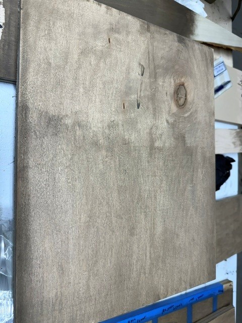

I am building a walkin closet out of maple plywood and did not realize how hard it would be to stain maple. I found a deskstain color that is exactly the color i want to use but it dries to fast when trying to apply it and wipe it off. it is more like a light tan/beige color.

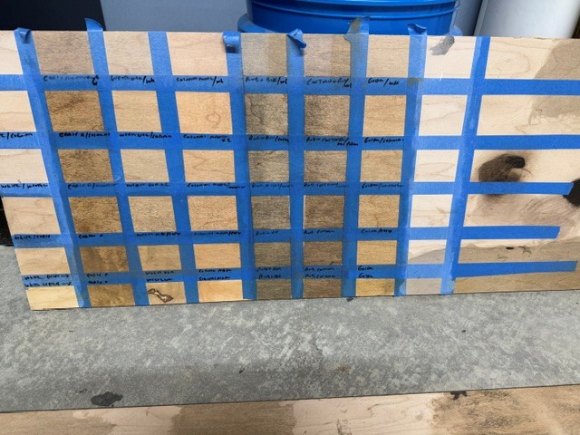

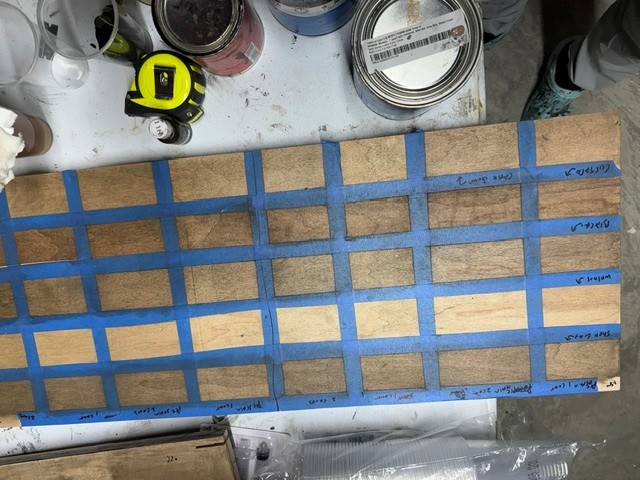

the problem I have is when trying oil based stains or water based stains to try to match it. Everything has a orangey look. I have tried to mix some together and use some white under tone (which helps) but cant seem to get the light brown look i am going for. Any advice on how to get the color I am going for on maple plywood. in the pics is the color I am trying to get but the samples I am doing are either too dark too light, or orangey hue

Brian, like Chemmy mix my own stains for the most part. For waterbased stains I really think for a quality job you have to spray application and wipe. I tend to use Chemcraft products and their clear stain base that stain if my screen is showing it correctly would have some lamp black, a little burnt umber, a little yellow oxide and a just a small amount of green. In the morning I could look at my notebook and give you approximate grams per gallon. Using a deck stain on maple veneer I think you’re just asking for trouble in many regards. Not the least perhaps adhesion issues with a topcoat. I respect your sample board a ton. That was professional. But I think you’re fighting an uphill battle.
