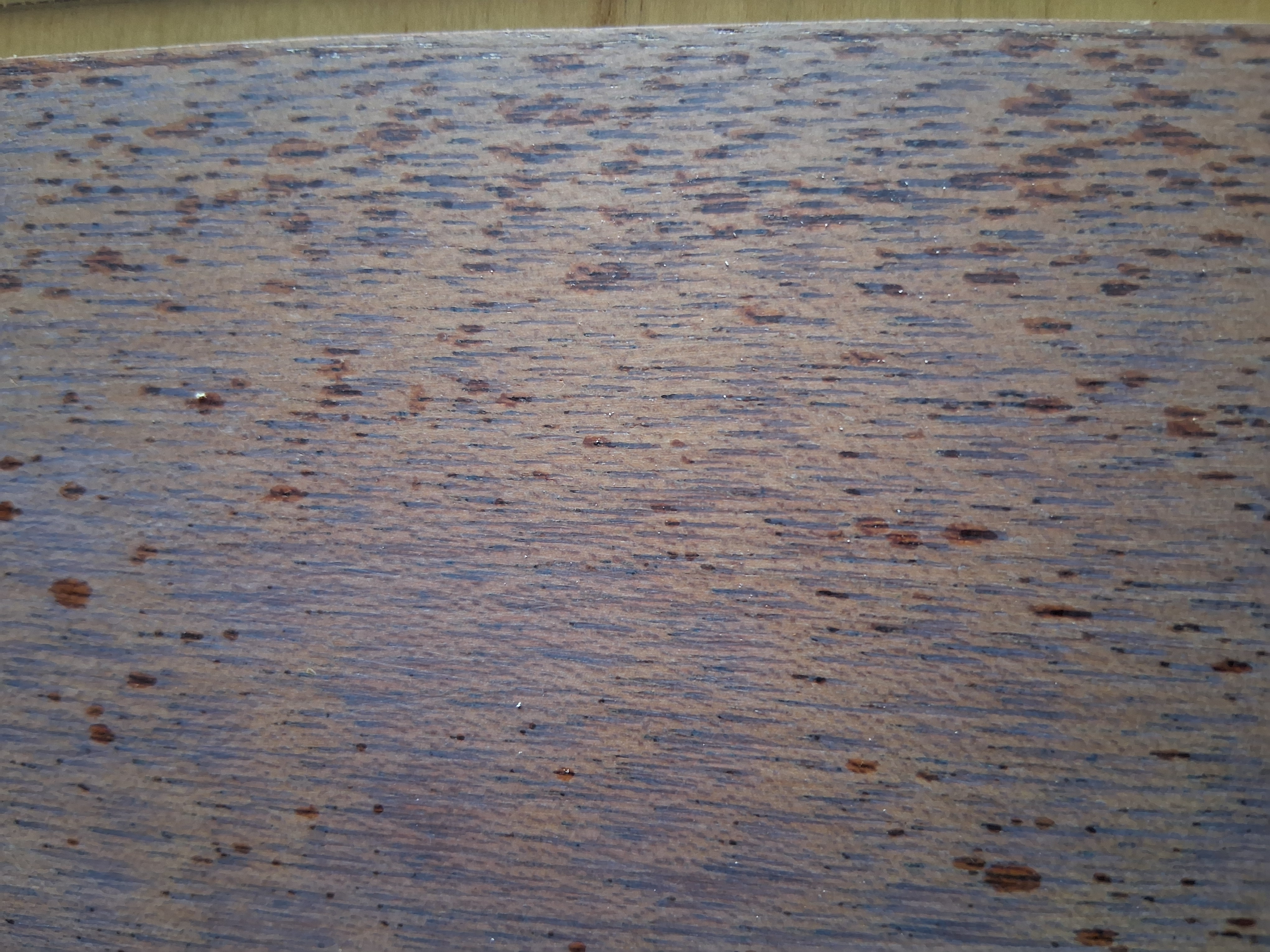

Does anyone have experience with SolarEZ UV cure grain filler? We've used it on some genuine mahogany after reading a glowing article on it in Fine Woodworking. The holy grail - fills in two passes, clear, and sands easily. The resin has been absorbed so deep into the pores that what's below the surface doesn't cure because it doesn't get exposed to the UV light. After sanding, the uncured resin makes it's way back to the surface and appears as dark (uncured) spots and blotches. Obviously we can't finish over these spots. The manufacturer tells us that we shouldn't have used it on mahogany which is "like, perforated". They say not to try spraying a catalyst like MEK on the parts. Sold me another polyester resin product; a "dual cure" which cures with either UV or the MEK. Said it might penetrate into the pores and "kick" the uncured resin hiding down there. Didn't give me a warm fuzzy feeling. Any ideas greatly appreciated before we try yet another guinea pig product. Really surprised at Fine Woodworking recommending this...

Fine Woodworking is a shadow of what it used to be. I canceled my subscription after starting with volume 1. I hope you are saying these problems are on a sample board and NOT the project. That’s rule #1 in finishing.
