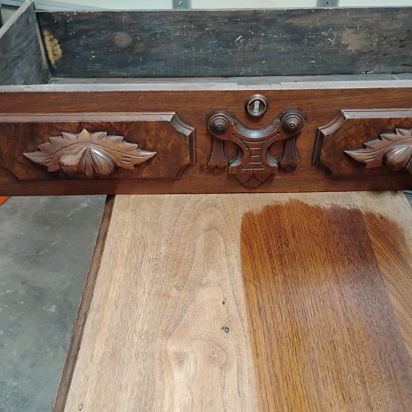

I haven't done any refinishing the past 35 years as I was busy varnishing teak on my boat.  I have Zero experience at matching colors being an old oil finish guy. I rescued this old chest before it was trashed. Hand dovetails, square nails but very poorly constructed. Re glued the drawers, repaired rails but unfortunately was forced into sanding the entire top. The photo shows the sanded (pretty sure it's walnut) top with a strip that is wet with mineral spirts. I have no plans on touching the 130yr old shellac as I like the battle scared flat,  almost oiled finish it shows.   On the inside of cabinet, I can see stain remanence of a very dark brown  reddish stain that may have been used.  Where do I start in trying to get a finish on the top to come close to the old somewhat muddy finish ? Dyes ? Stains ? wiping, gel, Glaze ?  a mixture ?  Currently I have no inventory of stains just some Keda power alkaline dyes and Garret shellac flakes.  My only local choices of stains are Minwax or Old Masters.  Just need to get it expectable-
Any and all suggestions and instruction is greatly appreciated.   Best Regards Stev

Hi Steve. My eyes are thinking cherry but maybe walnut. I would get some small pieces of cherry and walnut and start making some samples with different stains and or glazes to try to match what you have so you don't do anything to the chest befor you have the right stain and procedure.
Good luck
Jr

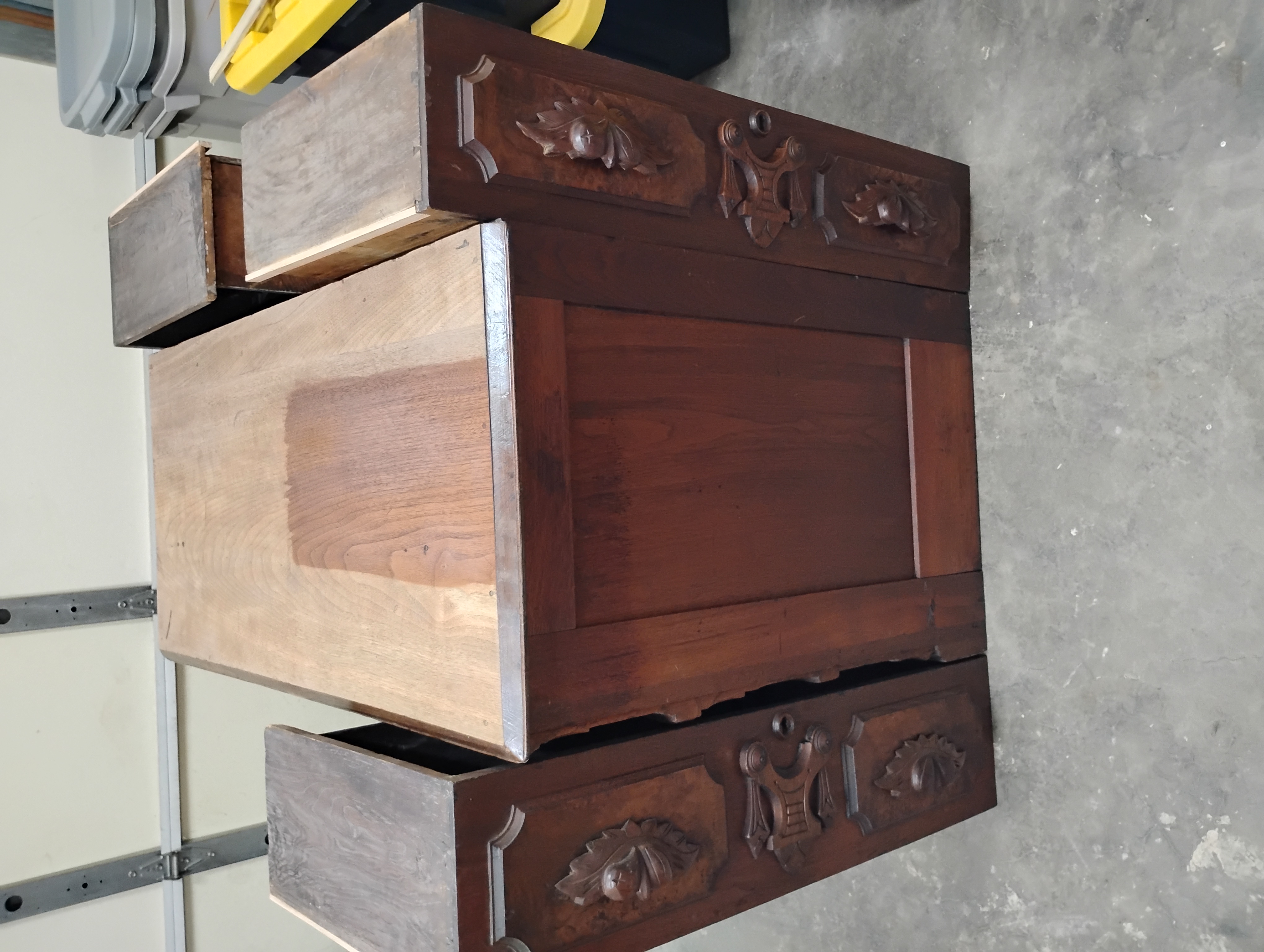

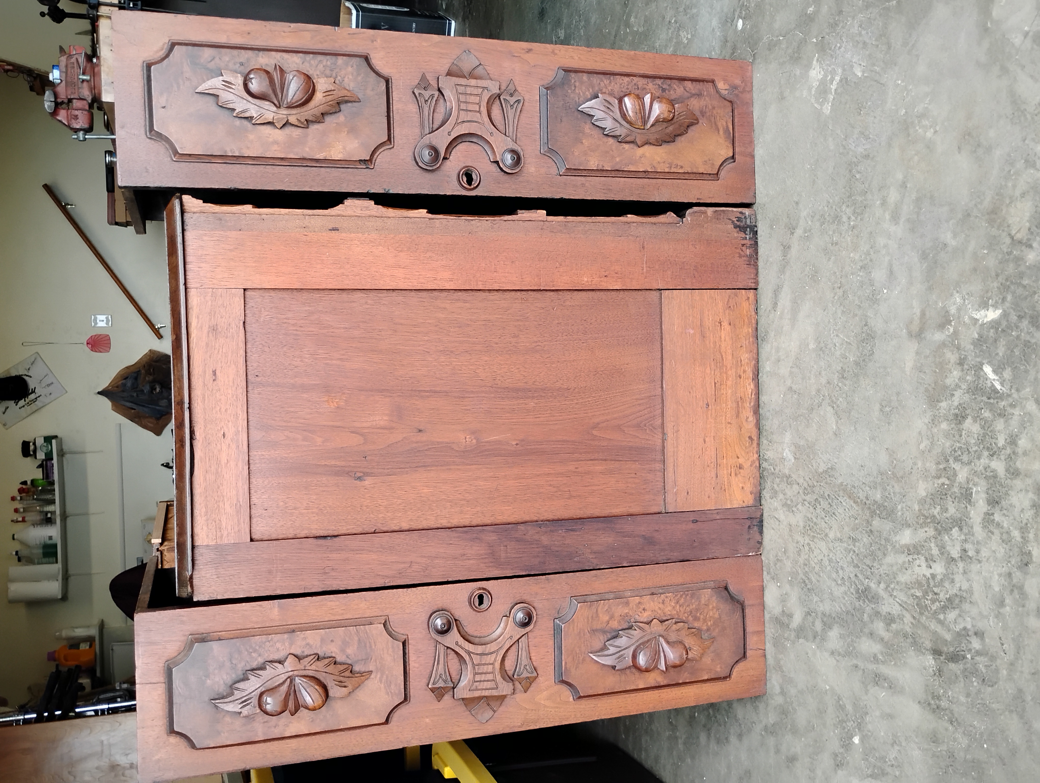

Thx for the reply- That is a major part of my problem - no access to scraps for experiments. This chest has all kind of shades. I thought walnut but those with more experience may chime in. I took photo in three types of light- they all looked a little different. Parts of the sides are much redder than the drawers.
View higher quality, full size image (4080 X 3072)

Its walnut the darker shades are mainly due to heavier figure as compared to the flat sawn wood you applied M as to.!! You can start,c fairly cheaply by going to any paint store selling water based latex paints. Buying a gallon of clear tint base, and three or Four small amounts of their color tints, in this case a yellow tint, an orange or reddish orange, and black.!! The pour a small amount of the clear face in a cup and use a eye dropper to put drop by drop of coloring into the clear....till you get close to that color you seek, if to light, then and just one drop at a time of black to darken or shade it..it may take awhile, but once your happy with it..scale up to the amount you need to do the entire piece(s)
The then also means you either carefully measure the liquid or weigh the liquid clear and drops individually, since your using small amounts, I recommend the measuring line cup of say
4-8 oz to upside the amount to say..16-24-32 oz. As needed..ok?

What chemmy says is the best way. But you can also find stains already made in quart size and buy those same colors like the most yellow one, a red one and a dark/black/brown one and do the same without buying the clear base. If you start with a ratio of 7 parts yellow, 2 parts red and 1 part black and see where that takes you. Just a thought.

that furniture piece looks a like a multiple layers of both dye and stain coats to me.
1. Use a dye to establish a uniform base color
2. Stain and/or glaze to build the color
3. Tone/Shade to add color and depth as well as improve uniformity
this is my finishing schedule.
1:light orange base coat
2:reddish brown stain
3:modified mahogany toner to even out the whole piece.
I know its very confusing and you have tons of questions in your mind :) been there.
All this works if you have a spray equipment.
If you do not have just stain and call it a day.
