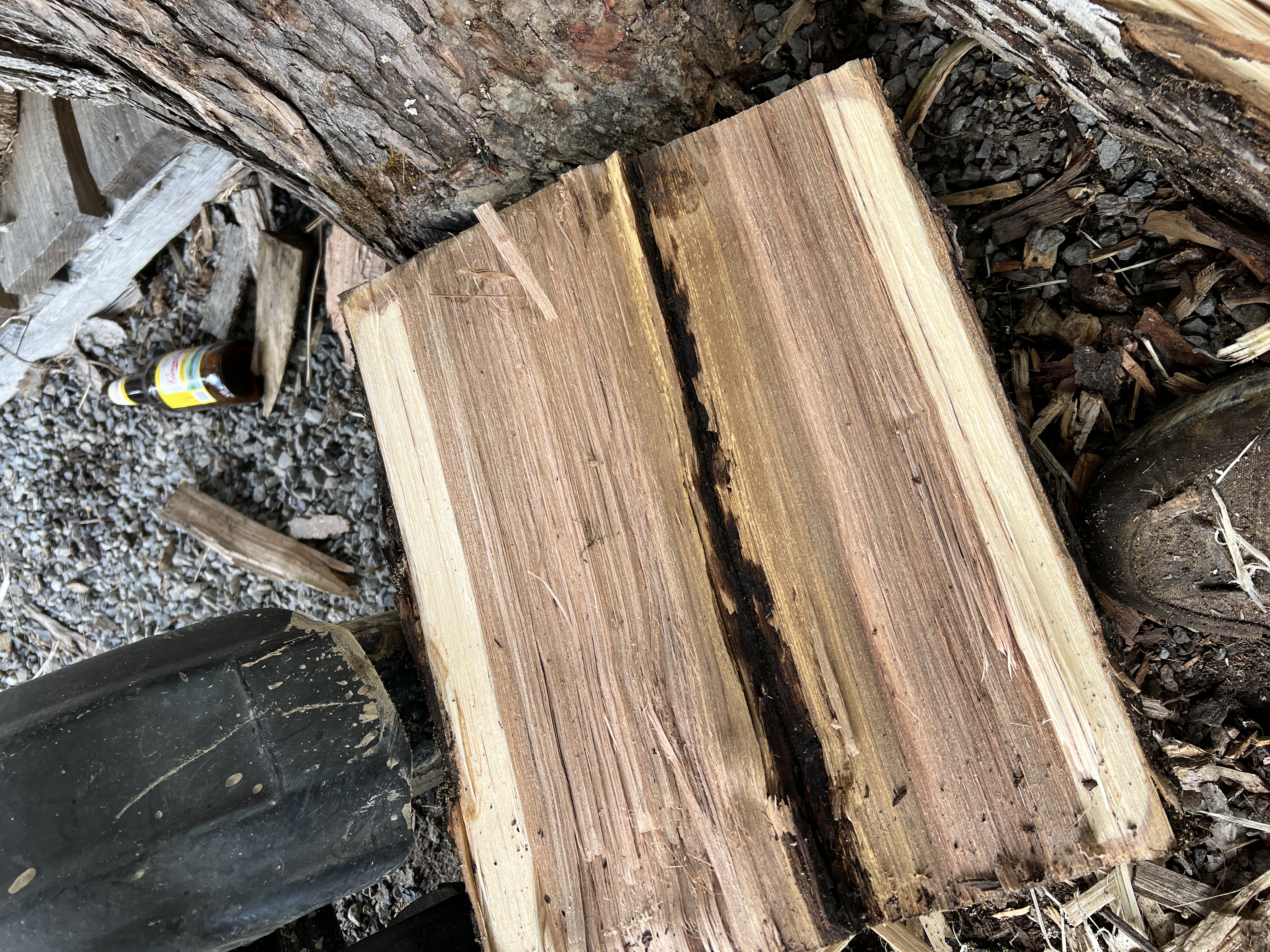

Tim Member
I have sawed walnut and yes, it has the wide layer of light colored sapwood and dark heartwood, the only reason I posted the question was I was splitting some hickory the other day and it seems to have the same color characteristic, see pic. obviously other stuff like work-ability, etc, must affect it’s appeal. I plan on sawing some hickory just to have some boards on hand, curious if it will look similar.

Mark B
I personally like Hickory in the right setting but perhaps when you get sawing a bit of it you may see that it tens to have a lot more varied and wild color than Walnut with a lot of pale white. Your split piece has a dark pith/heart and light sap but doest resemble Walnut to me. A lot will depend on what type of Hickory as well. Shag or Shellbark, Pig or Bitternut, etc.. All can have varied appearance. Its pretty stuff for sure. I have a large piece of property that in one 10-15 acre swath is loaded with Hickory but they tend to stay relatively small (<20")
