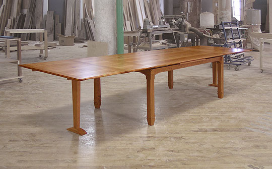

It can be done, we made one like this years ago. There are two leaves each side: one retracts per Frid mechanism, the other is added to it. Auxiliary leg required. Picture of table with one side opened below.
View higher quality, full size image (540 X 335)
