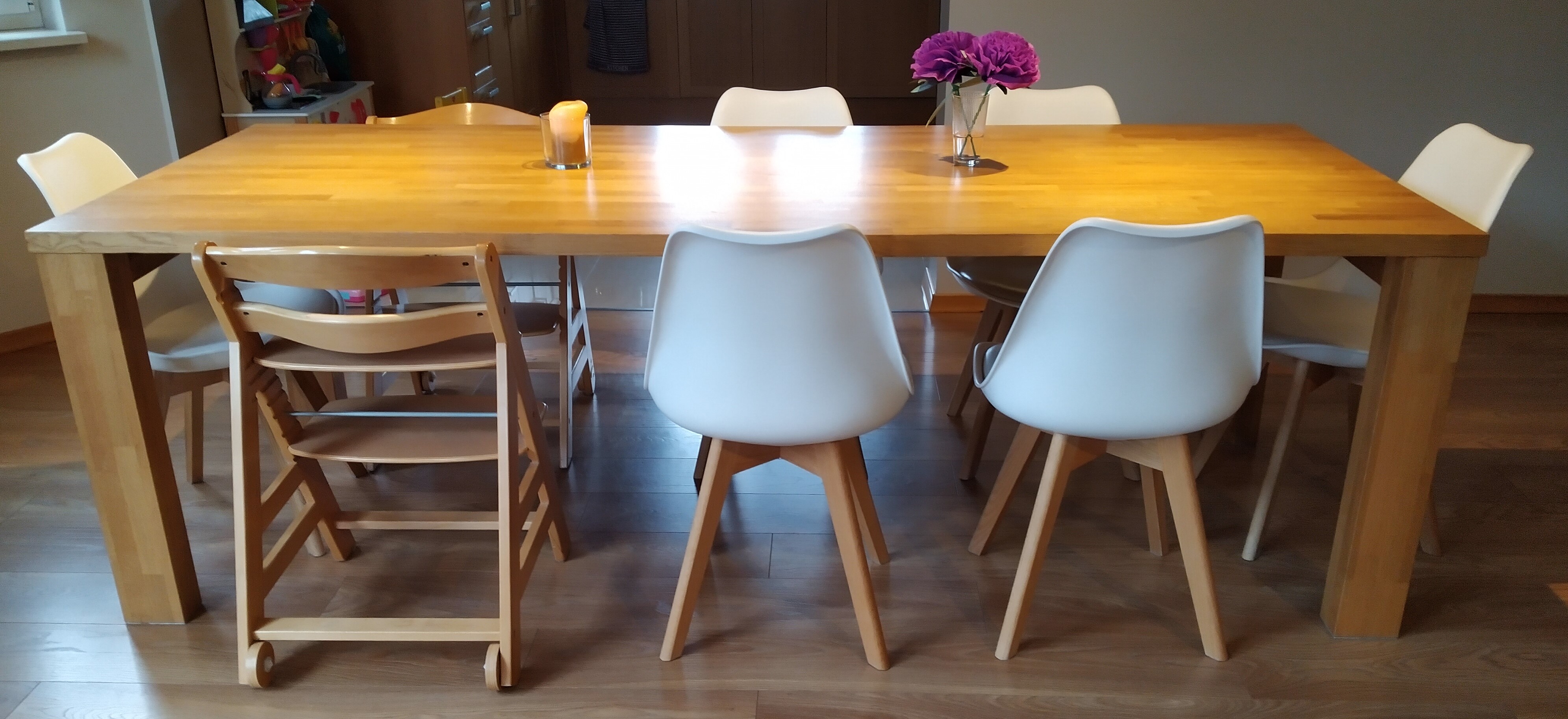

Thank you for this great idea of fixing the legs to the table top. I very much like the clean look. I wanted a thinner table top so I was afraid your solution wasn't going to be strong enough. I added some beams under the table ends to mount the legs with a bridle joint. It is really solid.
If you would like to see how I did it, please check my blog post.
View higher quality, full size image (3982 X 1825)
https://tmvhandyman.wixsite.com/tmvhm/post/a-solid-14-person-table-design-and-build
