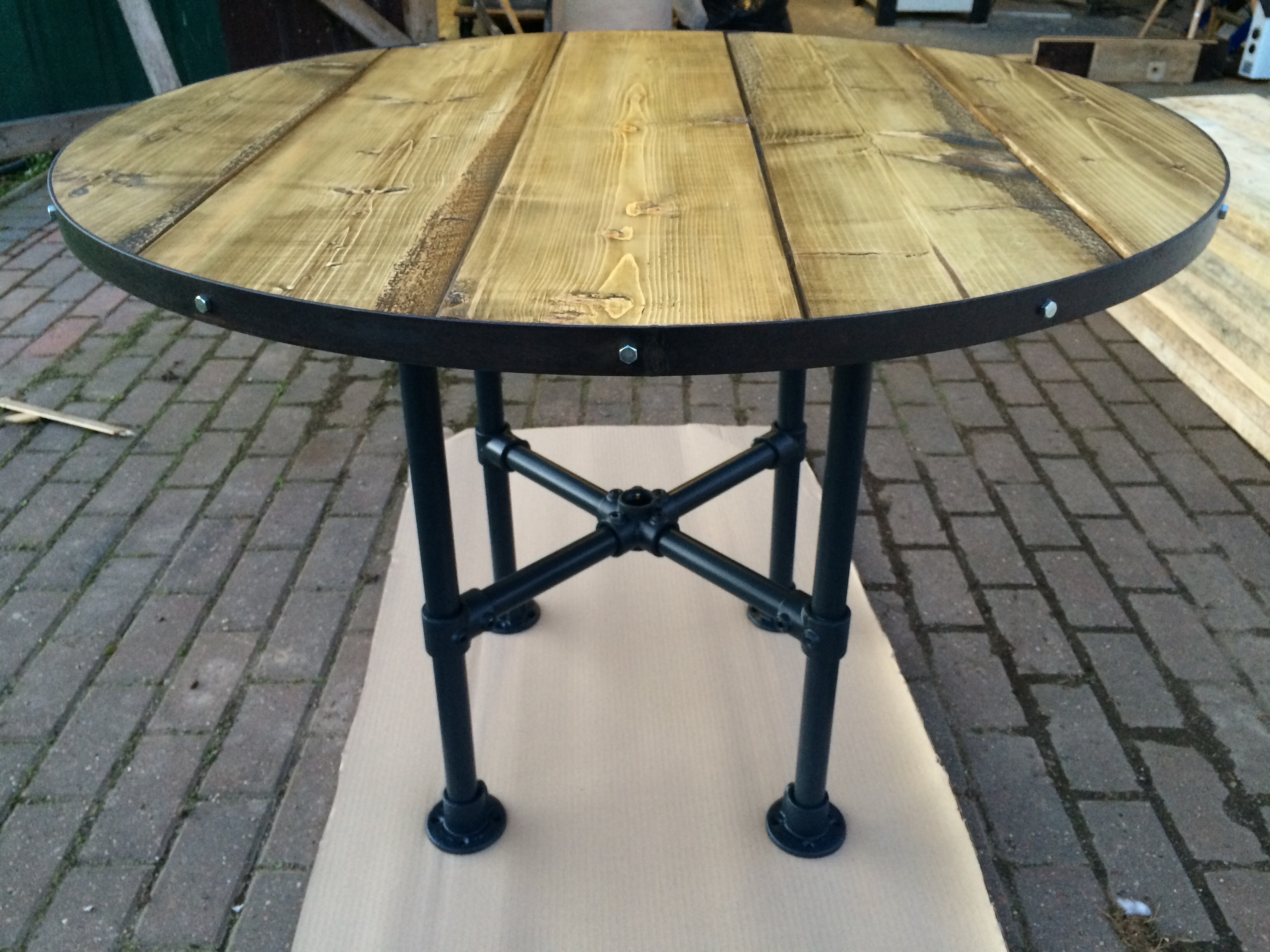

Hi all, I'm looking for some advice about slightly increasing the moisture content of timber rapidly. I make circular tables that I edge with a steel ring. I'm really careful to dry the timber in my kiln prior to joining and cutting the boards to create the top, and I then roll a steel ring that fits very tightly. The timber I use is Norway spruce and I try to get a <7% surface/12% core reading with my moisture meter so that when the tables eventually go into a home they'll take on a little moisture over time but not shrink (resulting in a gap between the edging and the timber). This has worked so far without any issues, but I have one table top that's undergone further shrinkage after fitting the edgeband because I had to keep it in the kiln overnight to cure a finish. I didn't switch off the dehumidifier.
I am currently attempting to rectify the problem by putting the top back into the kiln and injecting steam to increase the RH, but I don't know whether this will work in the time I have left prior to meeting the deadline for shipping. The worst case scenario is that I roll a new steel ring to replace the current one, but I'm looking for something that's a fix for future instances of this problem.
These tables sell very well and I don't want to change the design or stop making them. Can anyone offer me some advice?

With a moisture gradient between the core of the wood, and the surface, it's going to move. Steel frames and wood don't play well together. Wood is always going to expand and contract. No amount of kiln drying is going to stabilize it for no shrinkage in the future! It swells one time, it may crush some cells to stay in the ring, but then shrink away when the humidity drops. Especially considering those wide flat sawn planks. Quarter sawn would be a must for me, but if you don't want to see any gaps, you should run a rabbet around the table and have the wood set over a ring. I'd say you are still going to get some issues. Can't fool Mother Nature.

After looking at the table top I read your name and smiled. Anyway, I agree with the first couple of responses. No matter what you do the boards will expand/contract with changes in RH. There is no way to stop that. The way I would deal with the issue is make the steel hoop in two pieces, with one overlapping the other. Orient the ends of the hoops at the centerline of the table top. Attach each hoop to the boards but not to each other or, if you do, make sure that connection can slide. Now when the wood expands/contracts the hoop halves will move with it.

I have considered putting a flat ring into a rabbet to hide gapping and help support the edge ring, but rolling one accurately with my "hand mangle" would be very challenging indeed, and it would add cost to the customer. I have also considered making the ring in two or more parts, but because all boards are able to contract at the ends then isolated gaps are still possible IYSWIM.
