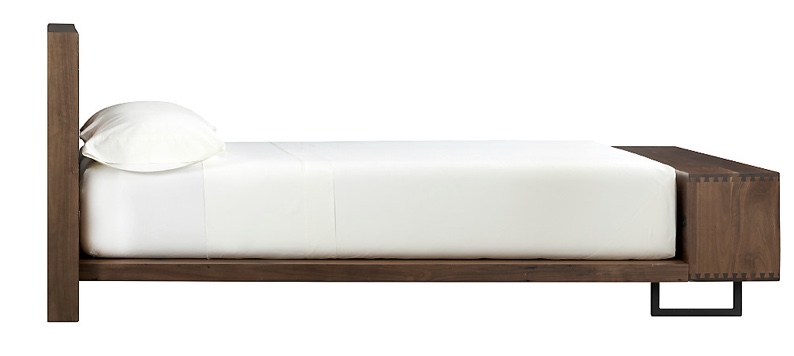

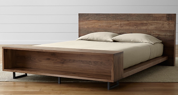

My wife wants a new bed as we are getting some Renos and new flooring done.
I have built one bed in my life, well something free standing that is, I have built quite a few Murphy beds, over the years.
She was going to buy one but with the state of the world these days she wants me to whip her up one.

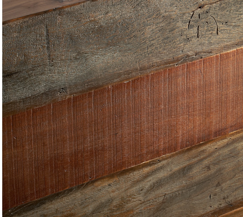

I took a look at it and it doesn’t seem to bad, I am not sure what to use for the head board part. I was thinking of using cherry or knotty alder . Do you think the headboard pieces should be solid or veneer. I guess if it is knotty Alder it should be solid. I was thinking if I used cherry I would use built up particle board with solid around the outside, mitred all four corners of course and then veneer it.
My concern is any movement or cracking with those large solid chunks.
Thanks for any advice.

After seeing the bigger pictures it looks like the headboard part has a 1/4-3/8 inch thick piece of trim all the way around it, I was thinking of maybe sandwiching a piece of 3/4 plywood with 4/4 solid, maybe that would work?

I wouldn't do a solid wood panel that size for your headboard and wrap it with a mitered frame. It's sure to shrink and or swell with seasonal humidity changes and either crack or blow your frame apart. Knotty alder is available in 4 x 8 sheets in a variety of thicknesses and cores. That would be much more stable than a glued up solid panel.
If you're looking to duplicate the footboard/box in the photo, solid wood there would be your best choice.
