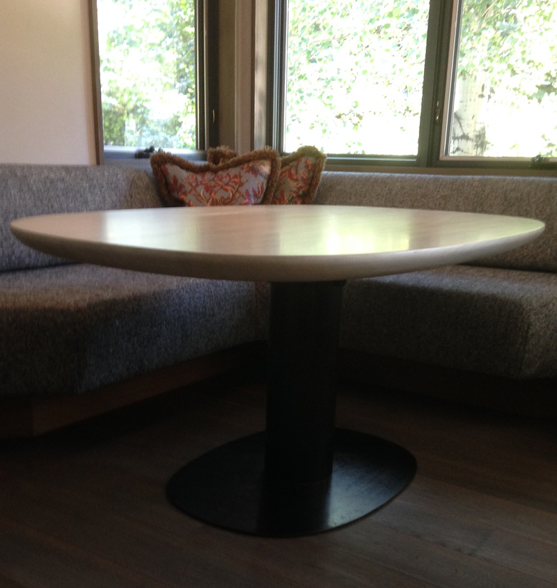

I've done this with my cnc on a few table tops. It would be difficult and possibly dangerous to attempt a radius this large with a hand held router. Pushing a large table top around on a shaper wouldn't be easy either. It took about 20 minutes to shape this 2.25" thick walnut top using a 1/2" chipbreaker bit to rough it out, and a 3/8" ballnose to finish it.
View higher quality, full size image (800 X 844)

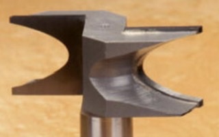

Thanks for the great input! That Amana radius bit looks awesome. I should have mentioned that this will be for a rectangular top, so all straight edges. I found this bit last night from Orbit, and it looks like it might fit the bill perfectly. Merry Christmas!
