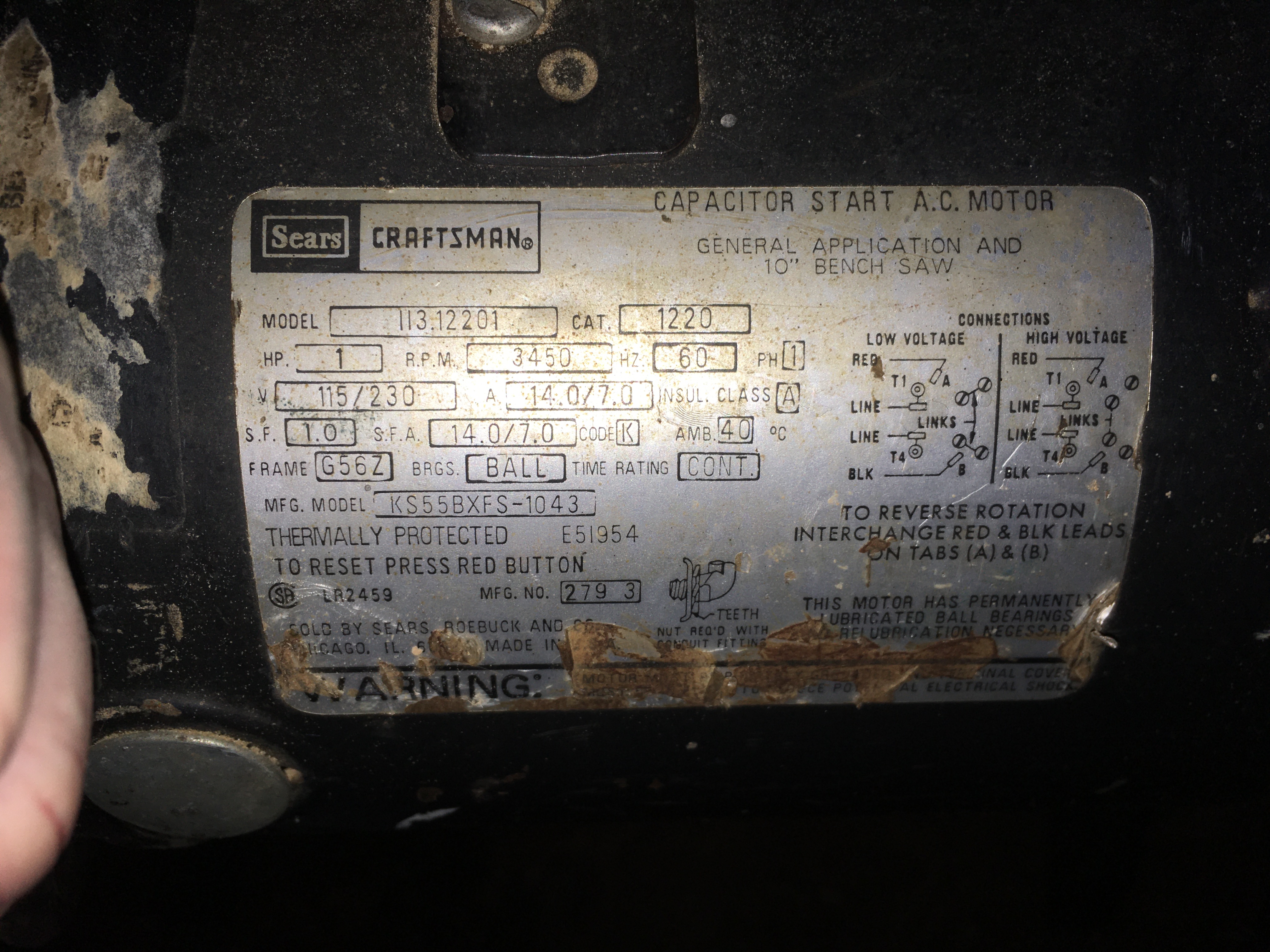

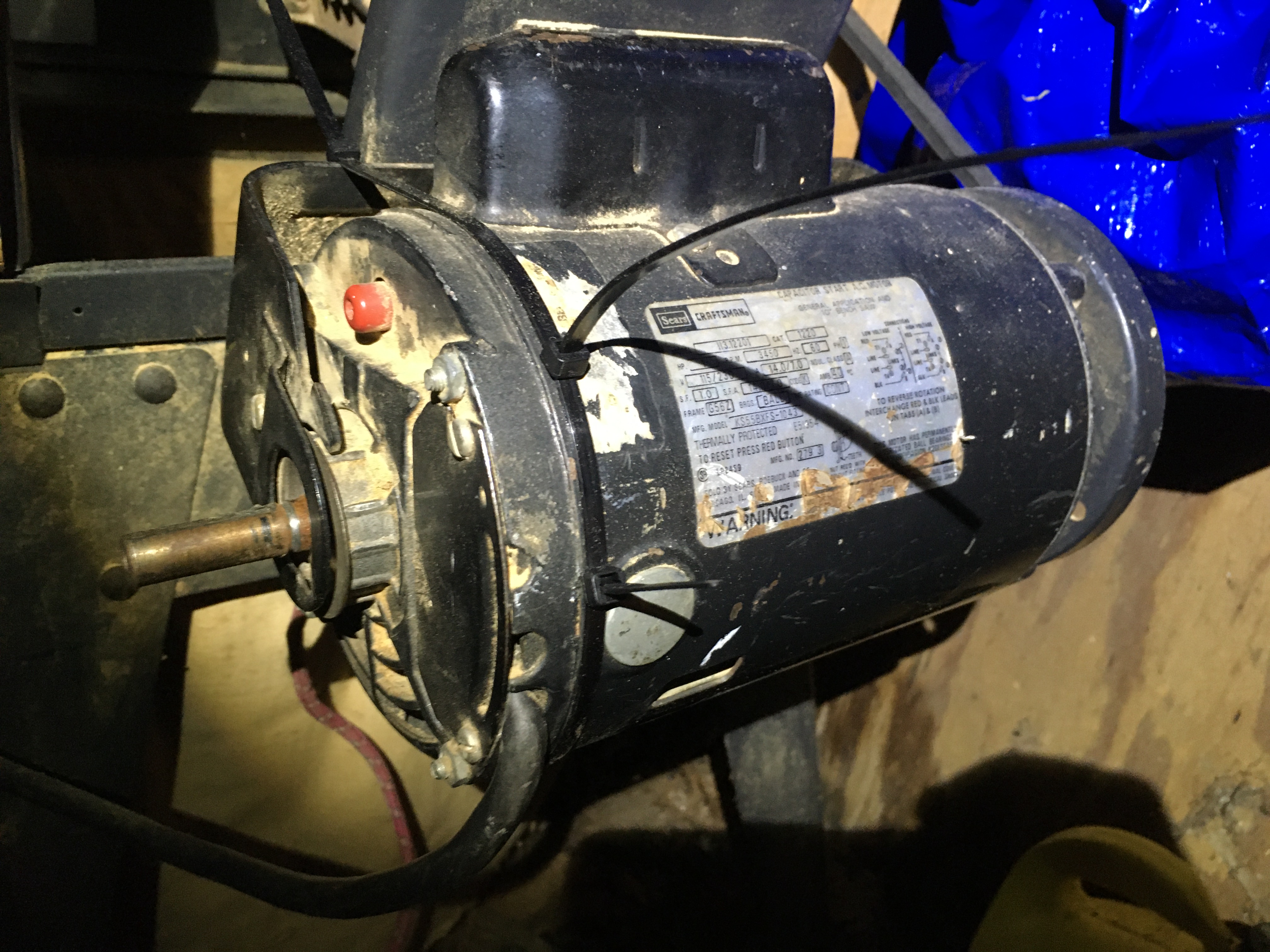

Just got this 30 year old Craftsman table saw for free because the motor's not spinning, 1HP 110v.  Before sourcing another I'm curious if I can get this one working again.  When you hit the power the motor makes a decent hum and sounds like it's trying to go.  Also there's an quick intermittent screeching that I'm guessing is a bad bearing.  If you take the belt off and spin the pulley it gets up to speed fairly quickly making no unusual sounds or vibration.  The notched arbor protrudes from the opposite side as well and I get the idea I could kick start it with a drill if I could hack together some kind of adapter.
If I can do say a $20 dollar repair I'd rather do that as opposed to $80+ for a replacement.  Any idea what's gone wrong with this poor old motor?

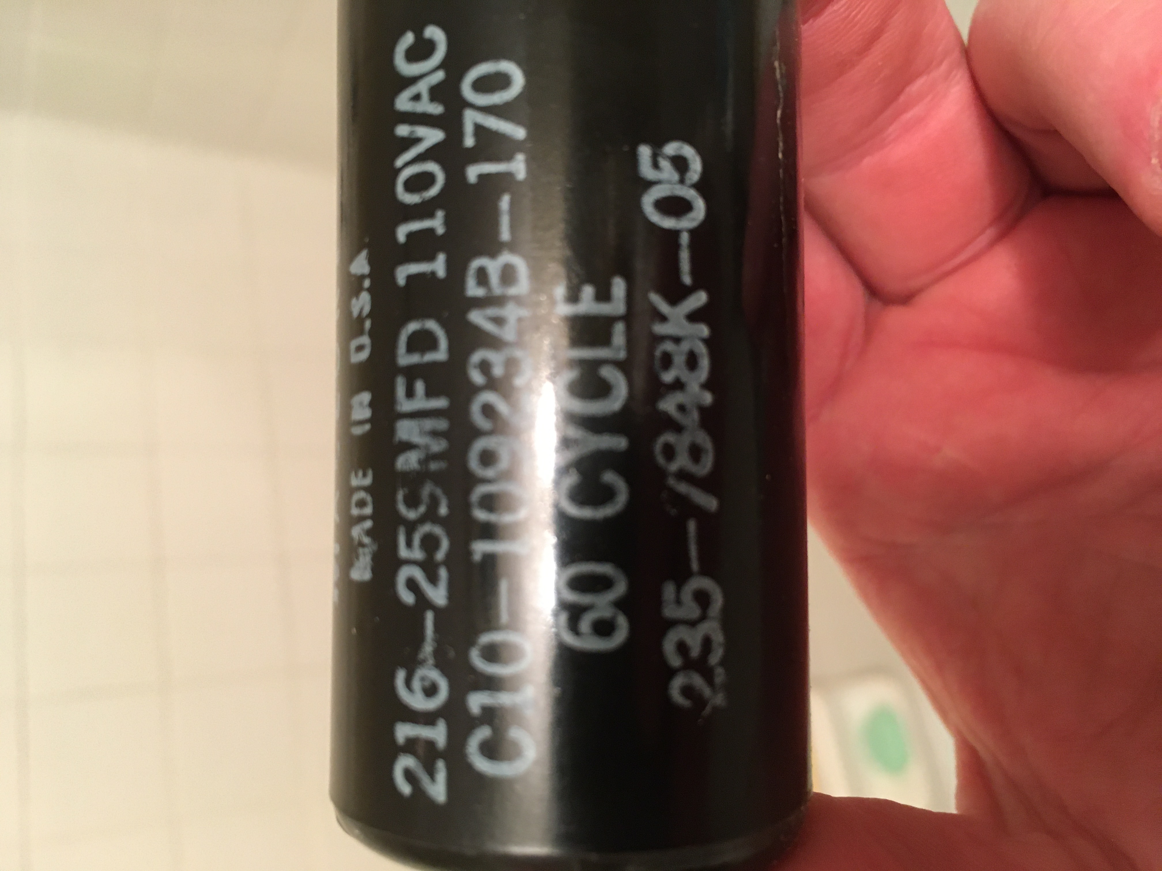

After watching a utube video on testing and replacing motor capacitors I'm sure that's what's wrong with mine. I've done some searches using the text on the side of the cap but I'm still not quite sure if I understand the code language yet. The word MALLORY is printed above the text.

That's a start cap (capacitor) just need one in the range of 216 to 259 microfarad (UF or MFD). But I'd get one with a higher voltage 250v. Just google start capacitor, a million out there cheap. Before you do that blow out both ends of the motor with an air compressor. There is a centrifugal switch in the end that loads with saw dust and gives problems.

Well, lesson learned is if it walks like a bad capacitor and talks like a bad capacitor, it very well could be a bad centrifugal start switch...and that's what it turned out to be. After getting the new cap in it did the same growl no start and after getting it all apart and cleaning the switch it starts like a dream. Well almost, I have a replacement bearing on the way but after that this 30+ year old motor should run like new. Thanks for all the direction guys.
