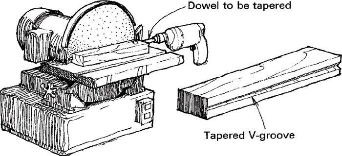

If you have a disc sander you could make some kind of jig that you could put the dowel in and spin it around for the taper.

We have made angled jigs to fit the taper we need for edge sander. Once you have the correct angle or slope, then you just start turning the dowel as you feed it into the angled jig. 80 grit paper will shape it pretty quick.

I spent some time at the end of the day today trying out some ideas; Thomas, the edge sander seemed to be the fastest way for a repeatable result (and I can have someone else do it while I'm working on the other parts of the pieces). I am attaching an image from Fine Woodworking that I found helpful.

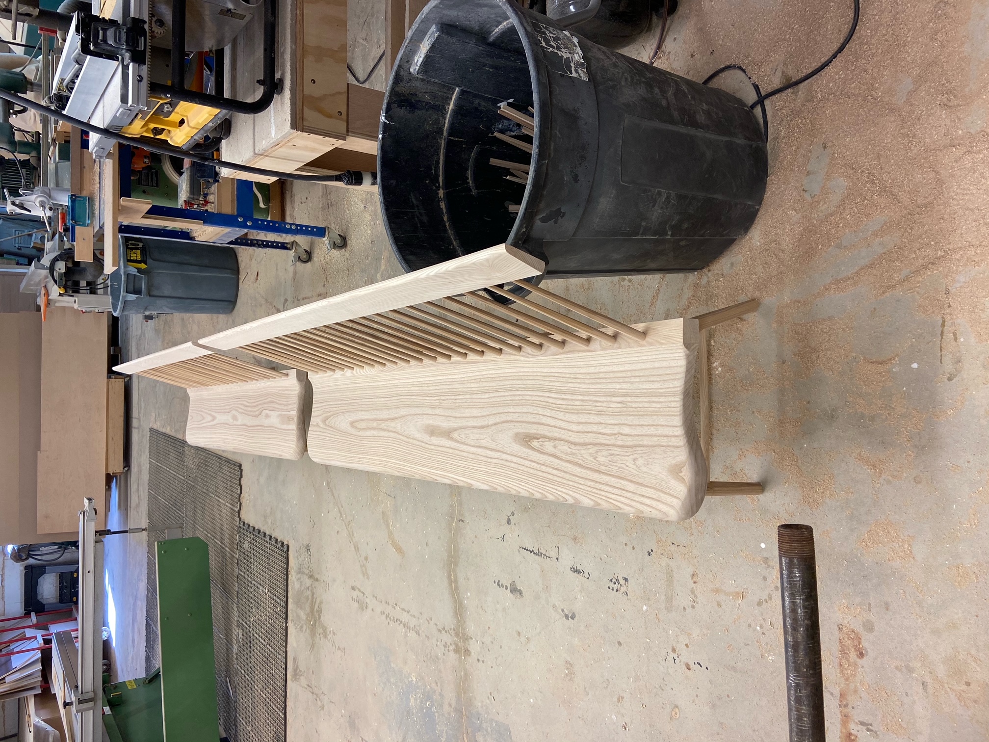

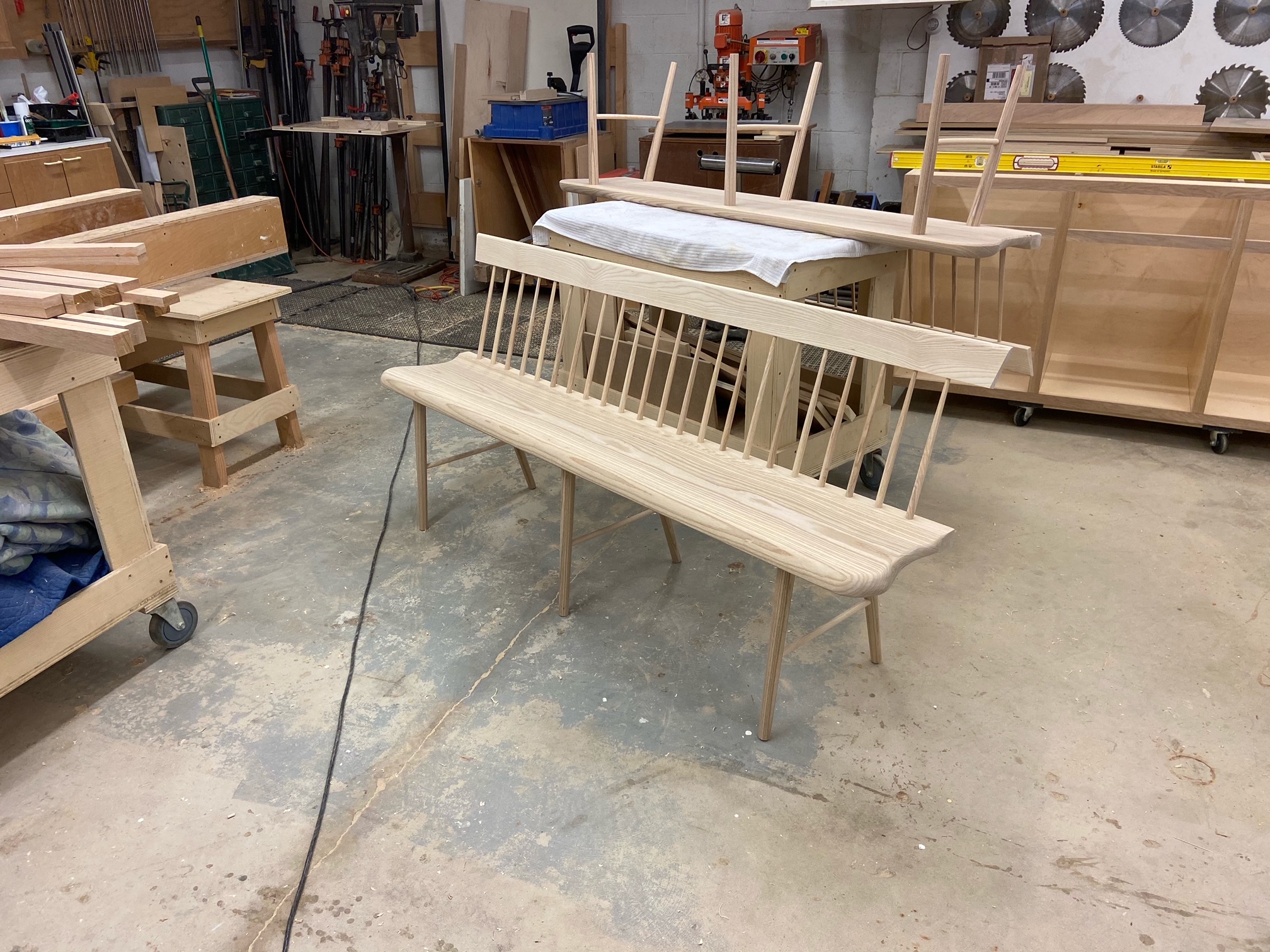

Thanks again for the all good ideas. The sander ended up not being as quick or accurate as I hoped; I ended up tapering on the jointer and fairing with a block plane. Took me about 75 minutes to do 44 spindles, and probably 25 minutes was setting up jigs and stop blocks to standardize my taper and fairing. Next time I have to do this that time should get cut down further.
If anyone would like to see, I’m including a photo of the completed benches here, pre finishing.
