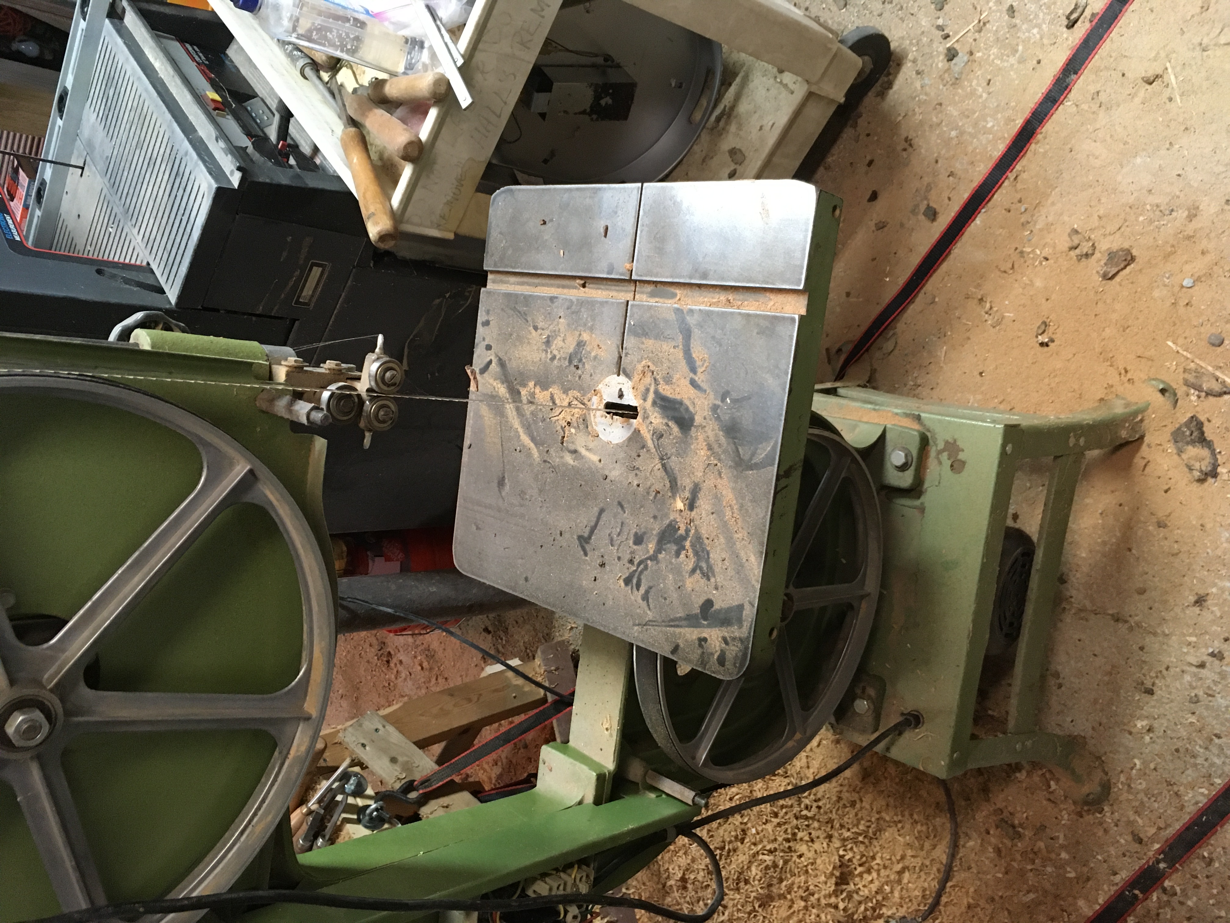

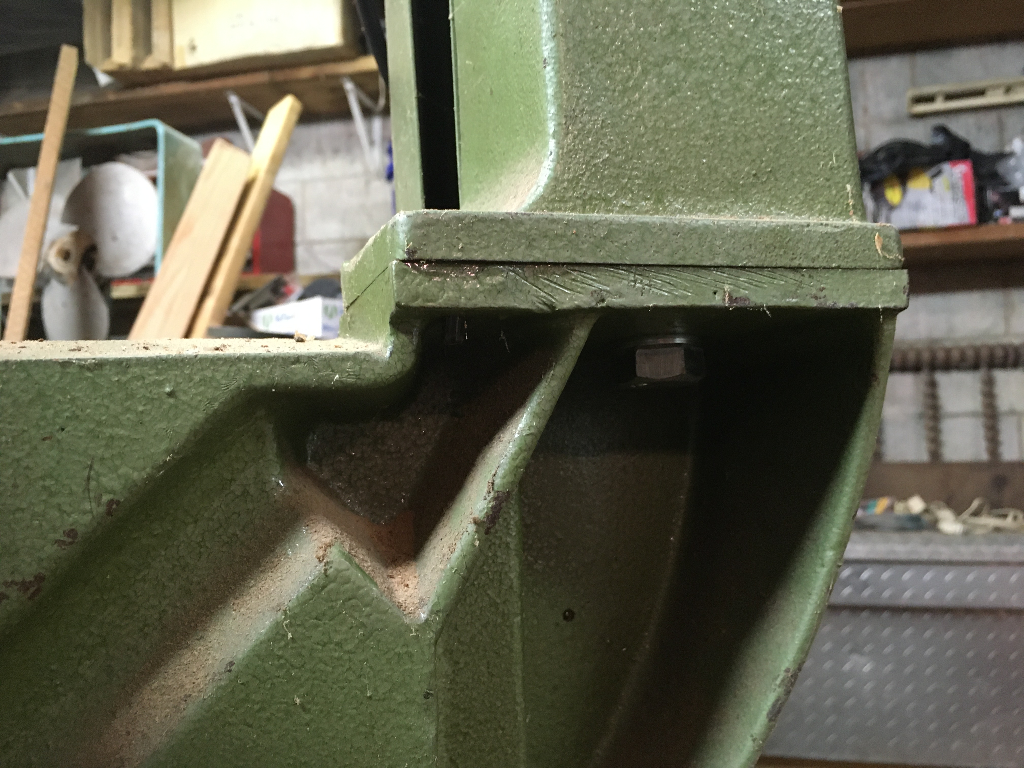

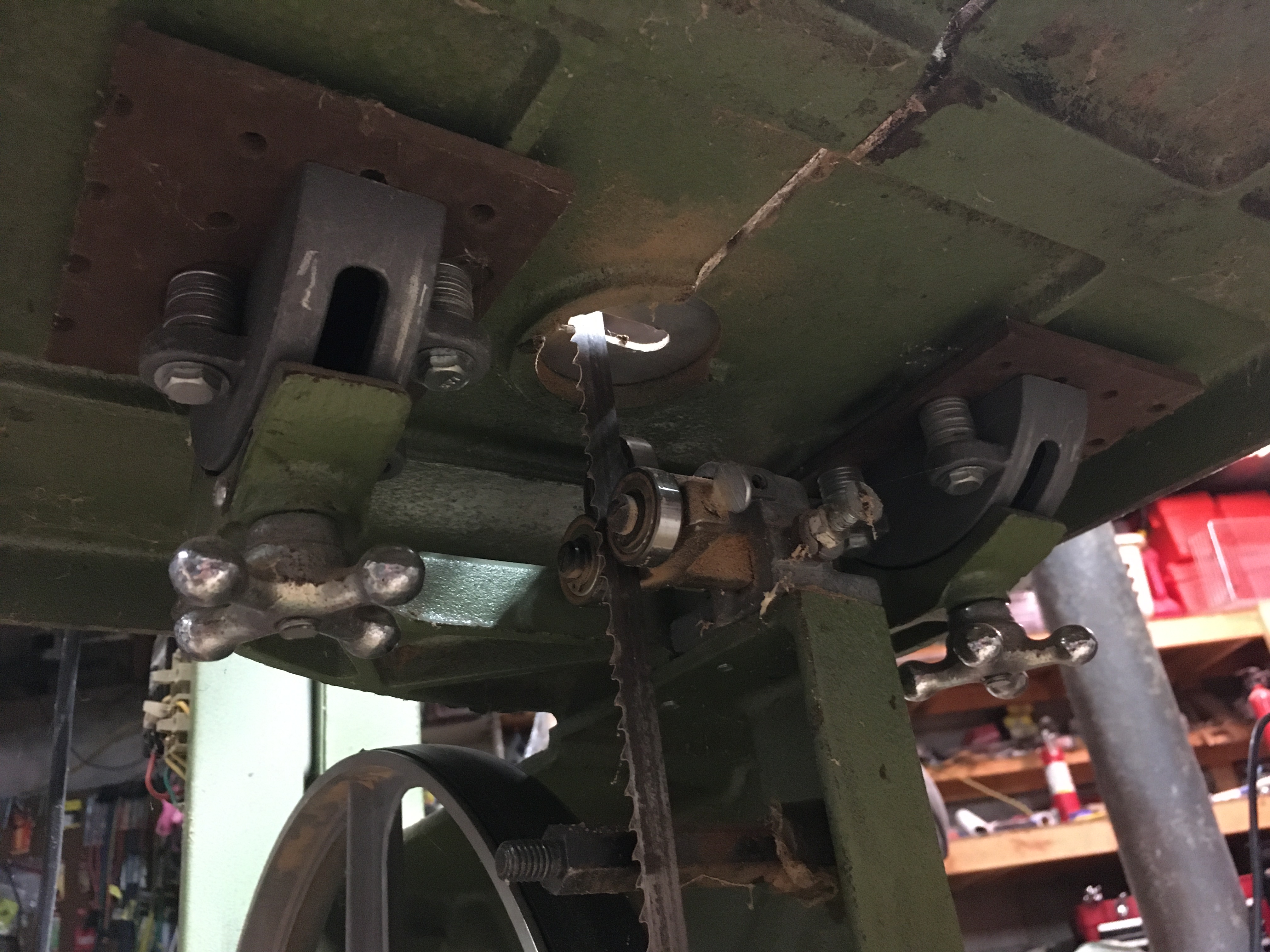

I need to upgrade my ancient 16" Grizzly band saw, but I'm not sure if what I'm needing is possible. I need a bigger support platform as well as increased cutting height. I think there are upgrades out there for increased cutting height but not sure about if there are options for installing a larger platform. I'm hoping my platform mount is of a universal type and there might be an upgrade option out there. Or if I can rig it somehow that'd be acceptable too. Any advice on where the parts I'm needing might be sold?

I don't recall ever seeing riser blocks for anything larger than a 14" band saw. Whether those will work for your particular saw is hard to say, as it might depend more on the dimensions of the arm than anything else, and if the accessories such as the guide posts and guards fit your saw, or can be easily modified.
If your concern about a larger support base is driven by using heavy lumber on the saw, and the extent to which the table cantilevers from the support trunnions, which are probably aluminum or pot metal, Grizzly makes a heavier cast iron trunnion assembly for band saws (link below), but I think it is for their newer generation of band saws. You may be able to retrofit it to your saw, but the flange holes on top of the trunnions may not align with your existing table, which will require additional retrofitting of the existing table, or the purchase of the newer table.

Thanks for all the advice TonyF. I've since used the table's tapped holes in the side meant for a guide fence and extended the table a bit with some angle iron. My goal was to have it support a circle cutting jig and so far it's working well. I was anticipating needing to cut full sized logs on the table but now that I've found robohippy's log cutting method I won't need to increase my cutting height...so it seems like things have worked themselves out. Glad to have your advice again though that you might as well buy a good quality tool that does what you need, buy once cry once.
