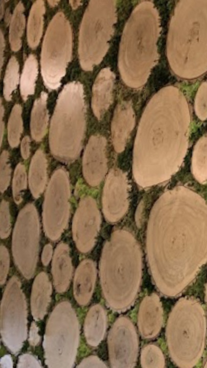

Just started getting into this, making table tops from crosscut sections from the stump of the tree, I think they're also called wood cookies. Several trees were taken down in a local park and we were given the chance to cut the stumps. We have been to this point a custom furniture shop. I seem to be getting conflicting views on whether or not to seal both end grain sides. I have Anchorseal which we use on log ends. So, should they be sealed or will this just slow down the drying time way too much?Appreciate any help in clearing this up.

What species are you using? How long have you been doing this? Are you able to dry the slabs without cracking?
In my experience end grain slabs of any size including the pith will crack as they dry unless the bound water is replaced with resin. I did successfully stabilize a 16" diameter oak cookie with Pentacryl but it was a slow process.
You could use Anchorseal but I doubt it will do anything but increase the drying time.

I'm curious why you are getting conflicting information, it's a miracle if a cookie doesn't split. Slow drying is always the best. https://wunderwoods.wpcomstaging.com/2014/10/19/round-cut-tops-almost-always-split
And information from this site;
https://www.woodweb.com/knowledge_base/How_to_Limit_Cracking_when_Drying_Wood_Disc
s.html
https://www.fpl.fs.fed.us/documnts/fplmisc/rpt1652.pdf

I guy in my town did these. I believe he used the Pentacryl Kevin mentioned. Time consuming, but a neat effect. Well sealed after stabilizing. He must have been in the good graces of God to be blessed with so many miracles!
