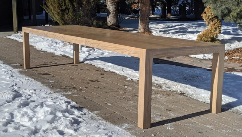

I've used lots of both types of slides, and I've come to prefer the steel ones over wood, especially for longer extensions. The ash table shown was 12' long with the 2 - 24" leaves in place. The steel slides were 72" long in the closed position, and opened up 50" No sag, dead level.

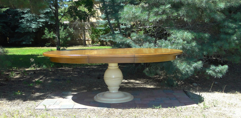

Equalized slides are for fixed base pedestal tables, like the alder one shown.
Wood slides work fine for smaller tables and are less expensive. For a large table and long term functionality, I go with steel.
My source for Watertown steel slides is Moin Hardware @ tableslides.com
