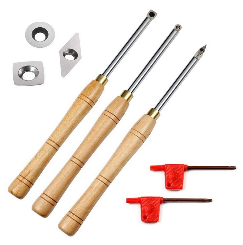

Hey everybody. I got this cheap 3 piece carbide tool set off Amazon and now I'm ready to upgrade to something with negative rake. Are there negative rake replacement carbide cutters for my set or will I have to go with a whole new set that's specifically negative rake?

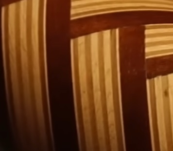

Also, I'm trying to find plywood similar to what's in the picture below but so far I haven't been able to find anything similar. The picture is of the side of a vase that a guy in Germany made, so who knows what stuff is available over there. As it's only the sides of the plywood that shows that's the only surface I'm interested in. I can find sheets of 3/4" baltic birch with 11 thin layers and poplar and others with much larger middle layers, just nothing with these middle size layers. I'm all ears on where to find something like this. I'm fairly sure it's 3/4".

Looks like you are still on the search for this stuff. I’m guessing it’s not plywood at all, especially considering it’s part of a turned object. Hard to tell with absolute certainty though as the image is a bit blurry. If the grain is all running the same direction there’s your answer, and the solution is to mill and glue up your own material to match. If it’s alternating layers of longitudinal grain and end grain it’s plywood. If this is for a one off object I think your best bet is to make the material yourself since it seems to be tough to find. I can’t really help on the specific cutters for those tools as I typically use traditional turning tools in my work, but the array of options out there these days is dizzying. Easy wood makes negative rake inserts, but I have no idea if they will fit your existing tools. Good luck

Thanks for the response John. I was leaning toward your idea when the originator of the piece got back to me and turns out it's 20mm European Beech paired with 10mm mahogany. Since it costs an arm and a leg to get that here in Appalachia I'm just have to reproduce the look the best I can. We'll see what I can come up with.
