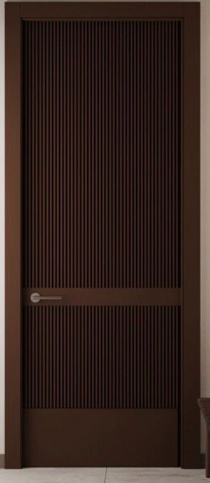

Hello all hope your having a good day
I have a project to make doors similar to the one in the picture
(I was thinking to place a 2.5 cm thickness plywood in the middle and hot press on both side hardwood thickness 1 cm and groove using a cnc)
What do u think about that any tips on how to make the whole door?? Any tip is much appreciated

Your plan to use plywood in the middle and hardwood on both sides with CNC grooving sounds promising. Here are some tips to help you along the way:
Measure Accurately: Ensure you have precise measurements of the door's dimensions and design. Accuracy in measurements is crucial for a well-fitting door.
Select the Right Wood: Choose high-quality plywood and hardwood that suit your design and purpose. Consider the wood's grain pattern and color to achieve the desired look.
Gluing and Clamping: Use a good wood adhesive to bond the layers together. Apply even pressure by using clamps to prevent gaps and ensure a strong bond.
CNC Routing: When using CNC, set it up carefully to create the desired grooves and patterns. Test on scrap wood first to ensure the settings are correct.
Safety: Be cautious when working with power tools. Use safety gear, including eye protection and ear protection if necessary.
Finishing: Sand the door thoroughly to achieve a smooth surface. Apply the finish of your choice, such as varnish or paint, to protect the wood and enhance its appearance.
Hardware Installation: Install the necessary hardware (hinges, handles, locks) precisely to ensure smooth operation.
Test Fit: Before finalizing the project, test-fit the door to make sure it fits the frame correctly and swings smoothly.
Maintenance: Educate yourself on proper door maintenance to ensure it remains in good condition over time.
Patience and Precision: Take your time with each step and pay attention to details. A well-crafted door requires patience and precision.

Leo G
A point cutting round over bit such as the Whiteside #1580 would be able to cut those bead grooves.

Kevin Dunphy
Website: http://kdunphy.com
2 cents the problem is machining solid wood that wide is prone to cracks and cracks, if you go thin warping will be a problem.
If you machine after all is laminated it has to be perfect.
Make strips and glue keep it simple .
Nice door I always hate to copy, need your design cabinetmakers are better designers than designers .I assume when they gave the picture no thought on how to make the door?

Your project seems like a fascinating undertaking! It seems like a good idea to use plywood as the core, hardwood on both sides, and CNC for the grooving. Make sure your measurements are exact, and think about the look of the wood you choose. When pressing, choose an adhesive that you can trust. I hope your door-making project goes well!

That sounds like a solid plan! Using plywood as the core for stability and hardwood for aesthetics is a good approach. Ensure your CNC settings are precise for accurate grooving. Consider sealing all sides of the door to prevent warping. Measure twice, cut once, and take your time with each step for a smooth finish.
