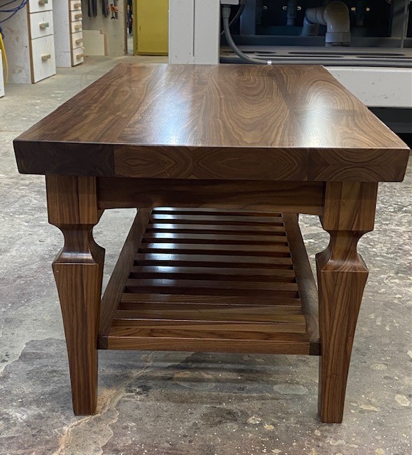

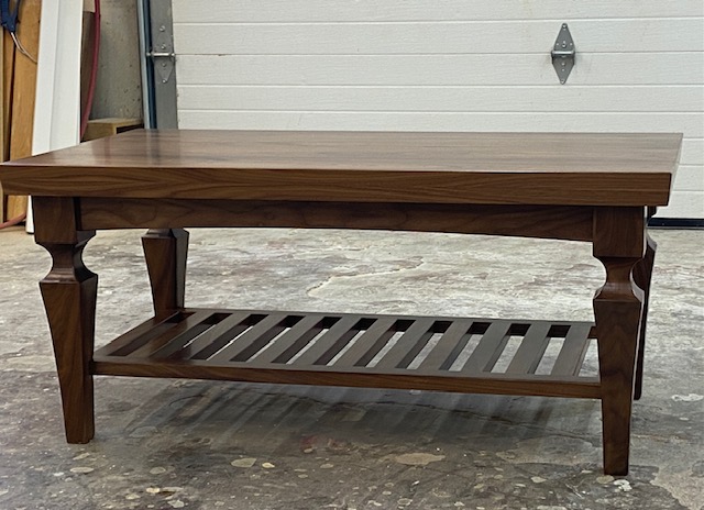

duster
I just finished this coffee table made with 5/4 FAS walnut sourced from MacBeath Hardwoods in SLC. It was top quality material, but it should be at $11/bf...
