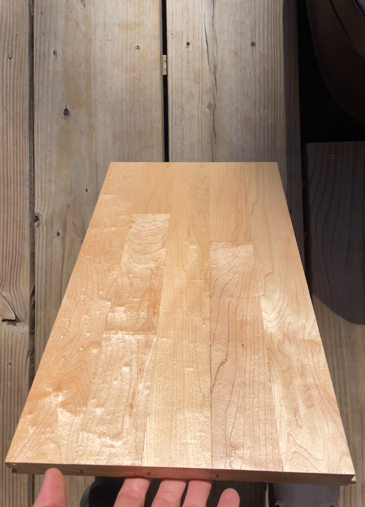

I've got a banquette bench seat I'm looking to make from find of some T&G 5/4 hard maple gymnasium flooring. Question I have is whether to glue this up as 2 blanks for the seat and back, or nail it in place on plywood much like a traditional flooring install.
Total length is around 155" right now +/-. I have the panel clamps to be able to get this properly glued but only have the ability to plane 12" widths and I'm making the seat and back 18". I can glue it into 4 sections that I'll join after cleanup and only need to deal with the single seam by hand. My first test I glued up has stayed very flat ( even in FL humidity swings ). However, I may be overcomplicating this and possibly better off just tongue nailing them board by board after I resurface them.

I would glue it up myself. But the T&G of flooring isn't symmetrical and will likely not glue up flat You might have to cut off the tongue and joint the two edges to make a decent glue surface.
In your picture it does look like the T&G are glue-able which would be unusual for a T&G flooring system which is designed to look tight on the top and leave an opening on the bottom so things can be nailed tight.
With gluing the boards won't separate, with nailing they will move around with the seasons.
