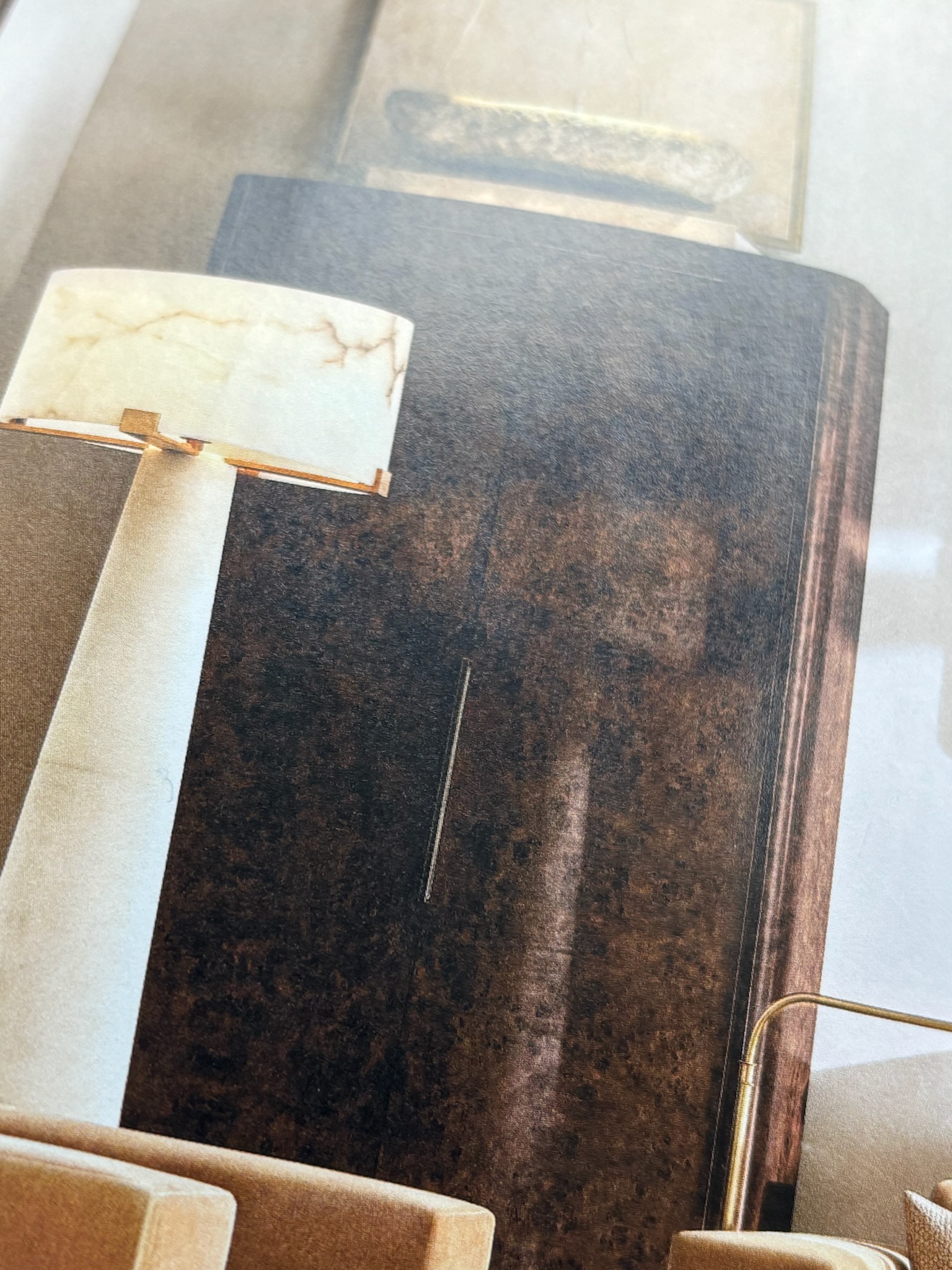

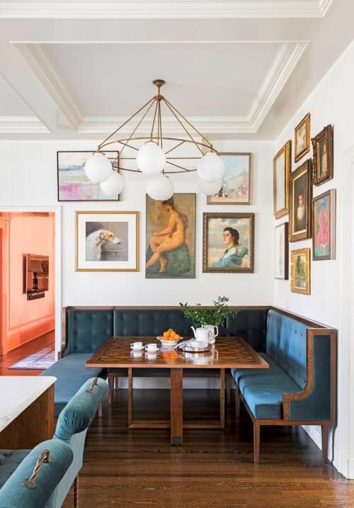

A client asked for a quote to build something similar to the attached photo in a dark "espresso" stained burl wood.Legs. Photo also attached of the finish/figure she is after.
Am I best off planning this as veneer over mdf? I have done a little veneer work, but never built curved furniture legs.
Is solid lumber an option?
What species would be best in your opinion?

Apologies. Curved bench end.

I would tell the client to veneer the table top in burl and do the banquet seat in solid walnut. Veneer the top on whatever core you want with a solid wood edge. If they want everything in burl, its doable but time consuming so charge accordingly. If they want everything in burl, veneer it on a stable solid wood.

if you are going to veneer top i would use mdf and make sure you balance the panel crossplying each side so you use 4 sheets of veneer. 2 on each side.
And solid wood for bench.

Do you mean a lesser grade of veneer running crossways under the walnut burl veneer?
If so, what type of veneer for the one under the burl?
Also, I assume I can use cheaper veneers like oak to balance on the bottom of the table top?
2/21/24       #10: Dark Burl Banquette and Table ...
chris
yes. we currently use sapele. it is a nice closed grain wood and not too expensive.
I would use that on both sides or something similar.
