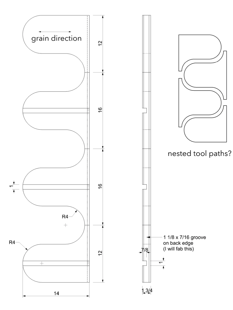

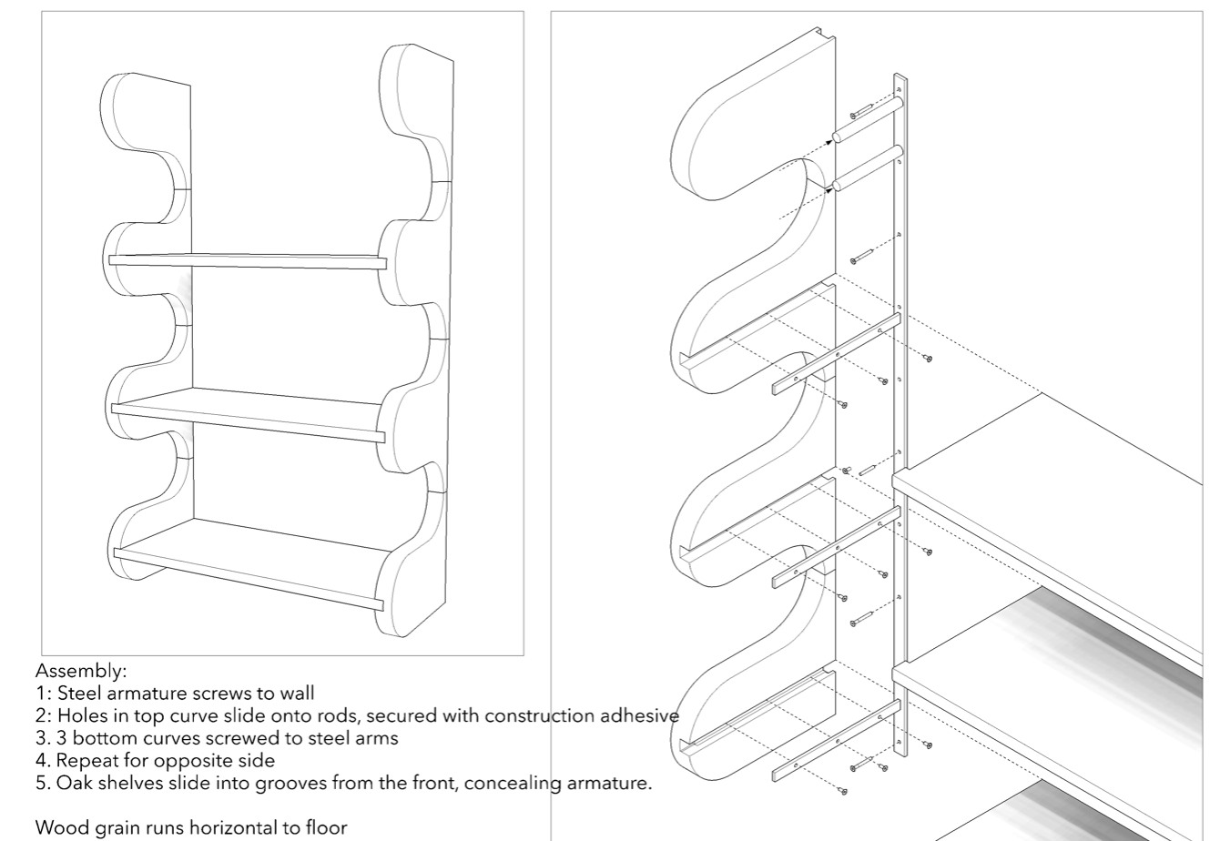

I have a tricky job to fabricate, and I can't decide which way to run the grain, both options have pros and cons. It's a typical situation where the project was designed by someone who knows nothing about wood. Material is 1 3/4 solid white oak.
Current plan is to run the grain horizontal:
Each shelf side is made of 4 separate pieces that are joined by a concealed steel armature.
Pros: looks better, more stable-each curve stays flatter, less end grain cutting - better finish. More efficient use of material, parts can be cut nested on the CNC
Cons: fragile short grain at wall, potential misalignment of sections, cross grain assembly with shelves, movement along vertical axis may spread gaps.
Grain runs vertical:
Each shelf side is made single continuous curve - same steel armature
Pros: easier install as everything is one piece, sides and shelves have parallel grain, vertical expansion is not restricted my armature
Cons: Lots of end grain cutting, curve may bow out of plane, not as good aesthetics. Still very fragile at back wall.
Am I missing anything? Any helpful opinions much appreciated.
View higher quality, full size image (1340 X 924)
View higher quality, full size image (958 X 1274)

The parameters set out by someone other than a woodworker have you hamstrung, and unable to deliver a good project. Tell them how it needs to be built (veneered product, stable panels). Run the grain however you need to visually, limit or eliminate the steel.
When they go to the dentist, do they tell him/her what tools to use and what to do? Then why are they telling you. You are the professional, you need to be in charge.

With Dave, we as cabinet makers are sometimes being told how to cook by people who barely know how to make cereal.
The thinnest part of the shelf the grain is crossed will crack and the metal is bizarre not to mention the dowels.

For good or bad the only way to make this out of solid wood is with the grain going vertical. The expansion/contraction factor would be huge if the grain were horizontal and that alone would cause failure.
