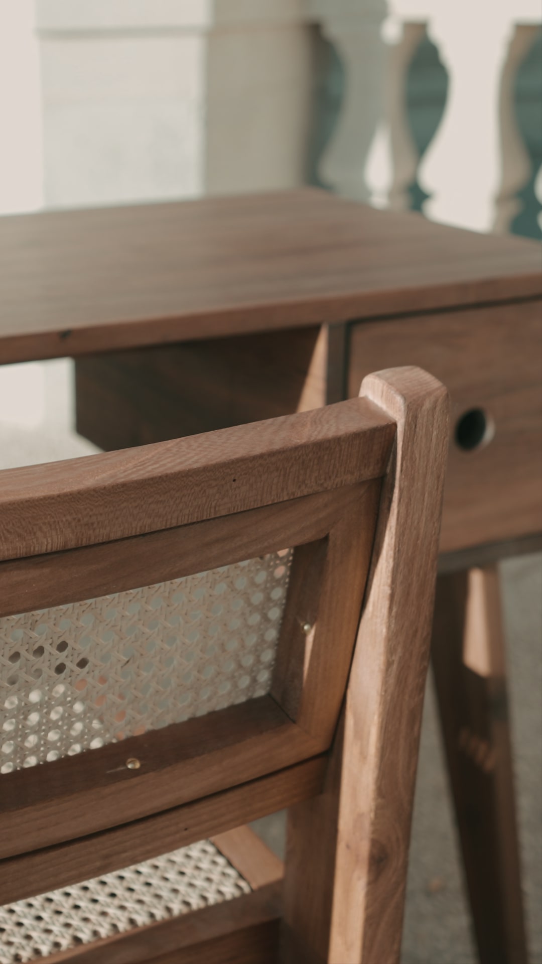

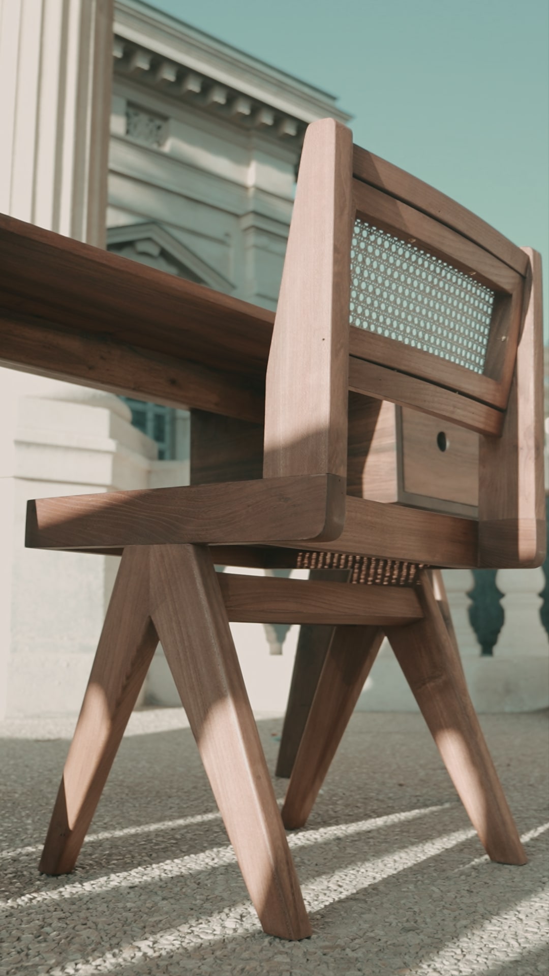

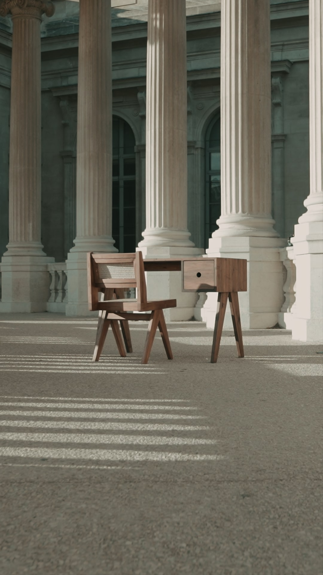

Hi guys ! :)
I built a chair and a desk inspired by pierre jeanneret and Detjer with the Chandigarh series.
it's a lot of work, i truly loved it !
What do you think about it ? What advice can you give me to get better ?
I also made a tiny video if you are curious,
thanks :D

Overall theses pieces look good. It is not a design that speaks to me but that is just me.
When working on "simpler" designs it is very important to pay attention to the details moreso than more complex shapes. Joints have to be crisp radii have to be true and blend well. Spend the time to mitigate the glue squeeze out and clean up before finishing. Make sure you don't get blast-out on screw holes and joint cuts. If you plan to make the designs as production pieces you can design your templates and jigs to control for these.
I worry about the strength of the seat and desk cantilevered over the legs. I see that as a potential source of failure particularly on the chair which can take plenty of abuse.
Finally sanding and finishing is the make or break part of the process. I would want more of a finish build on the wood. Again, my taste, not everyone's.
