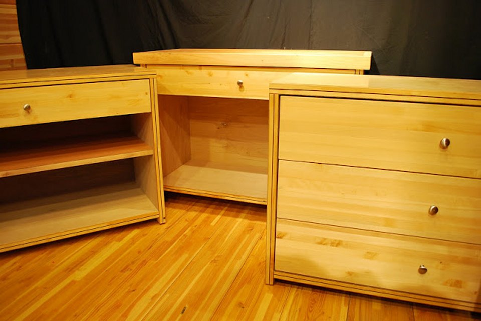

Here's some Foam Core Furniture I made.
I feel like I setup everything for great photos to show off my work, but the photos are just basic. I feel like the lighting was okay, and the backdrop was fine.
Maybe I need to invest in a better camera?

Your lighting needs lots of work first. Never get a shadow on the front of the subject. Really Foam Core? Furniture from foam and paper?

- Lighting first, alright. Might have to go watch some YouTube videos on how to properly light.

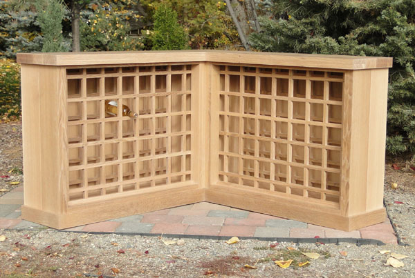

I alway use natural light whenever I can. Low angle morning sun works best. Try to position your piece so the front, top, and one side have a relatively even amount of light.

Here's an example.

Two things stand out for me. There is little contrast between the floor and the furniture. The pieces lose some impact from this. The second is I don't think it is effective having the pieces run out of the frame. There is quite a bit of distortion foreground right that makes the knobs seem oddly placed. I am sure you took individual piece shots - I think they would be more effective.

Thanks Tom and Duster for the photo advice.
Tom, that's a good point. I didn't really consider distortion.
duster, woah, yeah. Your photos look great. - I'll have to try some outdoor photos. - I'll show off how they turn out.

In addition to the other comments I'll add that a draped sheet is not much of a backdrop. You can purchase paper roll backdrops that do a proper job. I used to have a 10' long roll of light gray backdrop paper. When an area of it got wrinkled from getting unrolled repeatedly it was just cut off and a fresh section of the roll was used.
