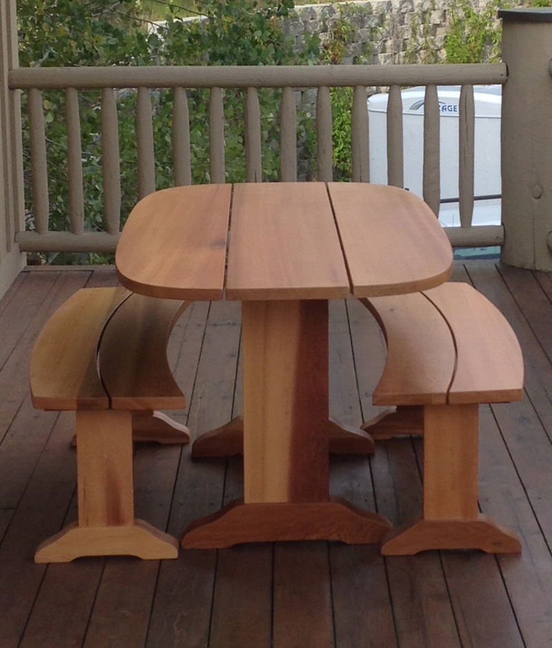

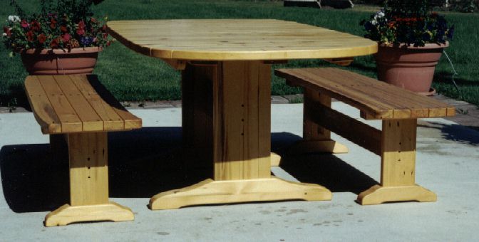

duster
I've made some nice pieces using clear western red cedar and alaska yellow cedar. White cedar is just too soft for anything that is expected to last more than 2 or 3 years. I've also made a lot of pine pieces, usually with furniture grade white pine. It's soft and dents easily, so it's not great for dining tables, desks, coffee tables, ect. I have made dozens of bedroom pieces with pine and it's held up fairly well. As far as damaging machinery, I don't think that's really an issue except pine can gum up saw blades, planer and joiner knives, router bits and sanding belts.
