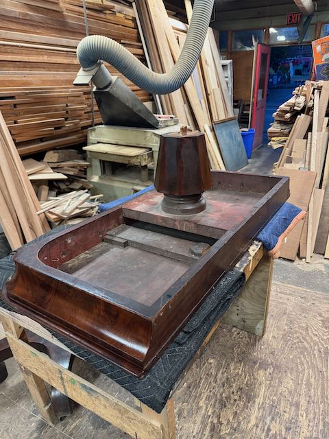

It came from our public library, and I would like to see it go back on display there. I've already recoated it with several coats of shellac, and am now thinking of putting something harder over it.
I know better than to use polyurethane because of adhesion issues. Can anyone recommend another varnish that I could put on top?
I prefer to spray but could brush as well.

could spray dewaxed shellac over the waxed and then polyurethane or spray lacquer.
10/23/25       #4: Finishing over Shellac ...
Pete
Just leave it with the shellac on it. If you put poly over it, the poly will eventually crack and fail depending on how much shellac is on the piece. You are really not gaining much by spraying lacquer over it now.
