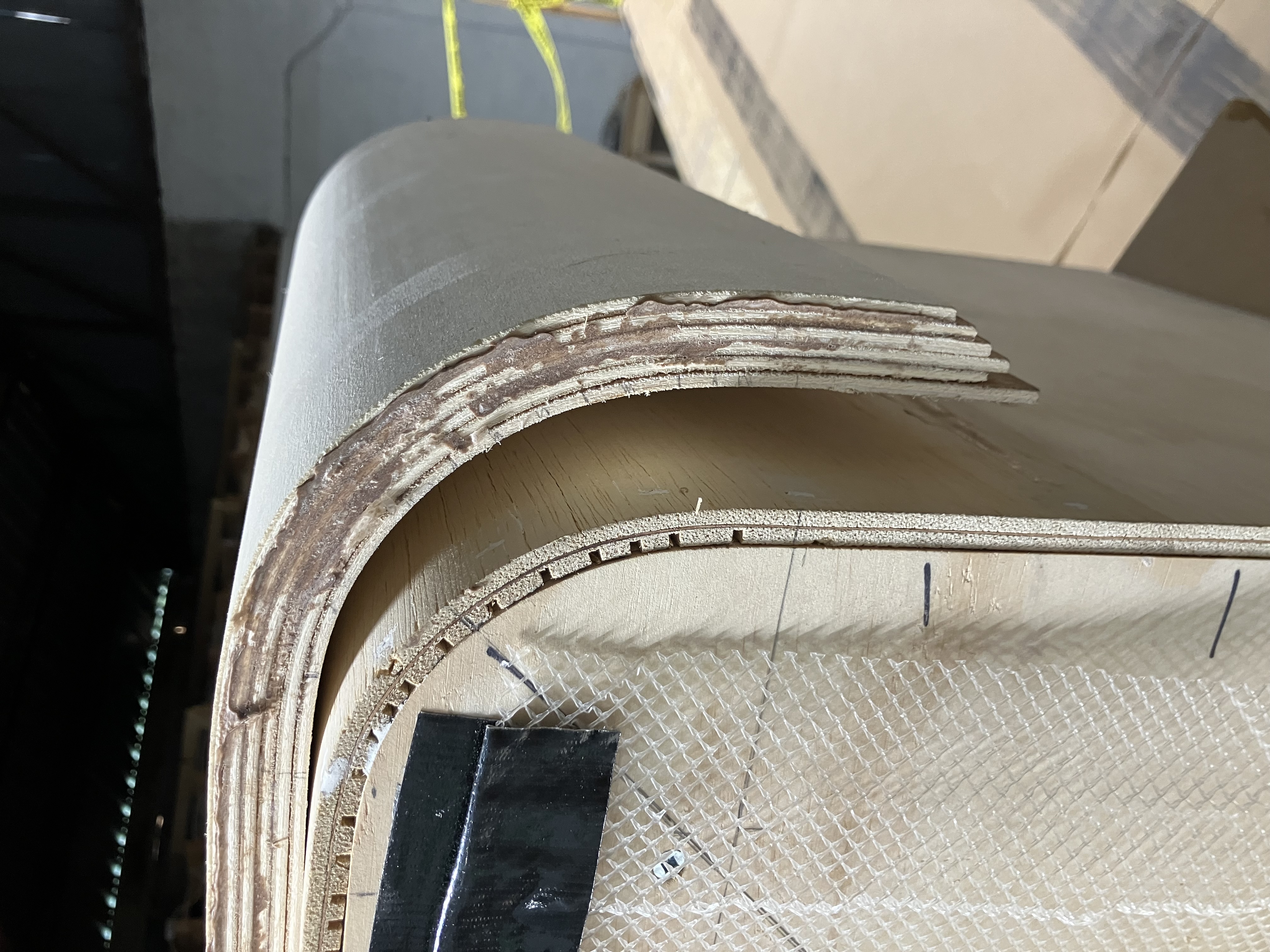

Greetings, working on a desk that has radius corner on several outside corners. Plan is 6 layers of the 1/8" and veneer on the fromt and back. In the vacuum bag with unbond.
The radius I designed to is a little tighter than the 1/8" bendy wants to go - approx 3.25" (80mm) inside face and 4" (100mm) outside face.
Playing around with damp towel and iron to soften the radius area, then dry clamping it to form. Then glue up to follow. Sorta steaming first.
Anyone ever done this? Do I need to worry about the heat and moisture in the bendy ply? Test from last night looks good so far. Could I maybe use a wall paper steamer in a bag to get this done faster?

these are about 16 1/2" wide, which will be the height of the cabinet. they finish at 3/4" thick. that'd be a lot of wide layers thin stock. these usually go good, just tighter radius pushing things.
9/18/26       #4: forming 1/8" bendy plywood ...
cwebb Member

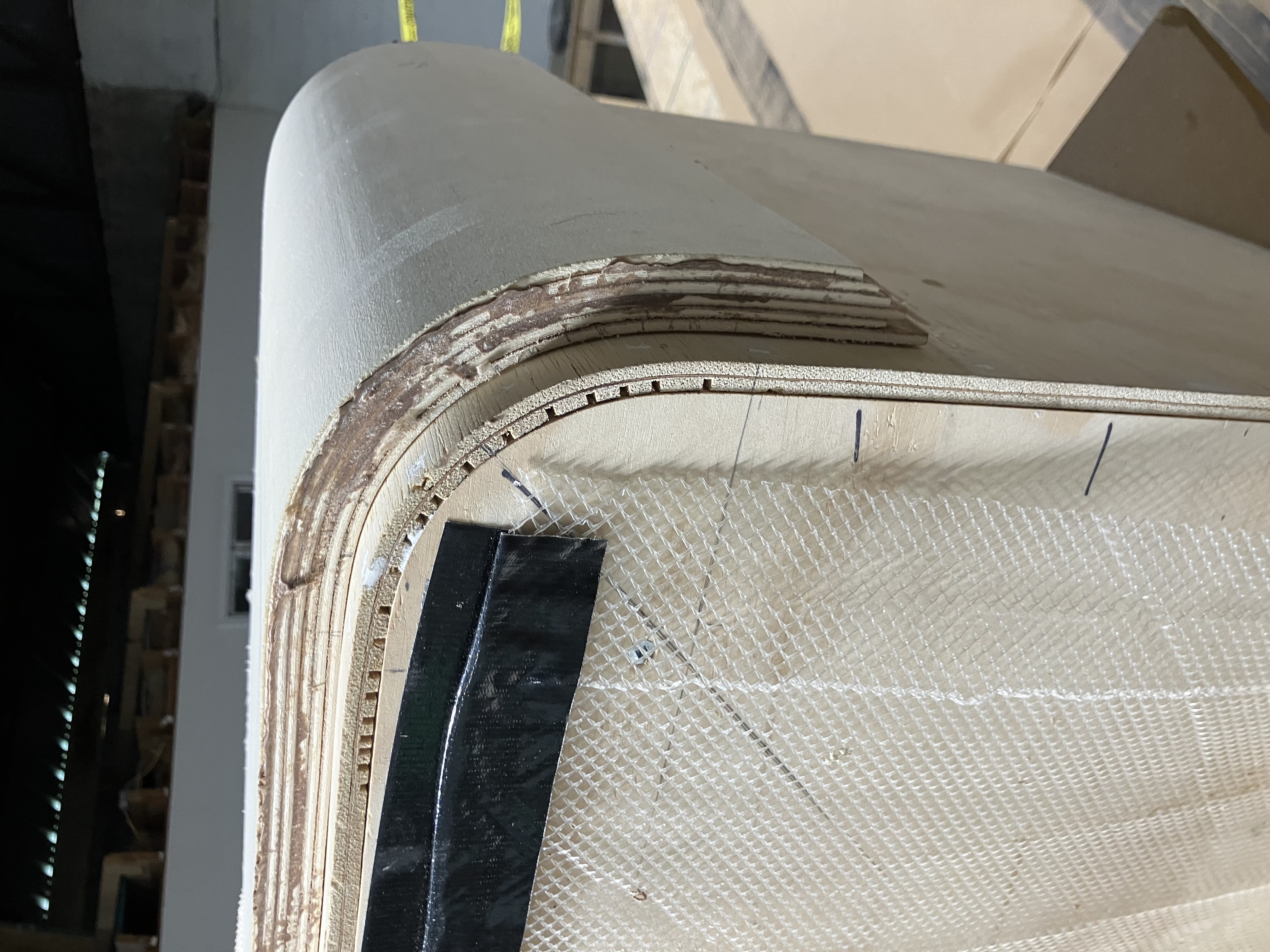

first glue up went good. no spring back.
did take a few dry runs to get the bag sucking down right. wanted to make its way under the layers on the vertical side before it all sucked down tight.
