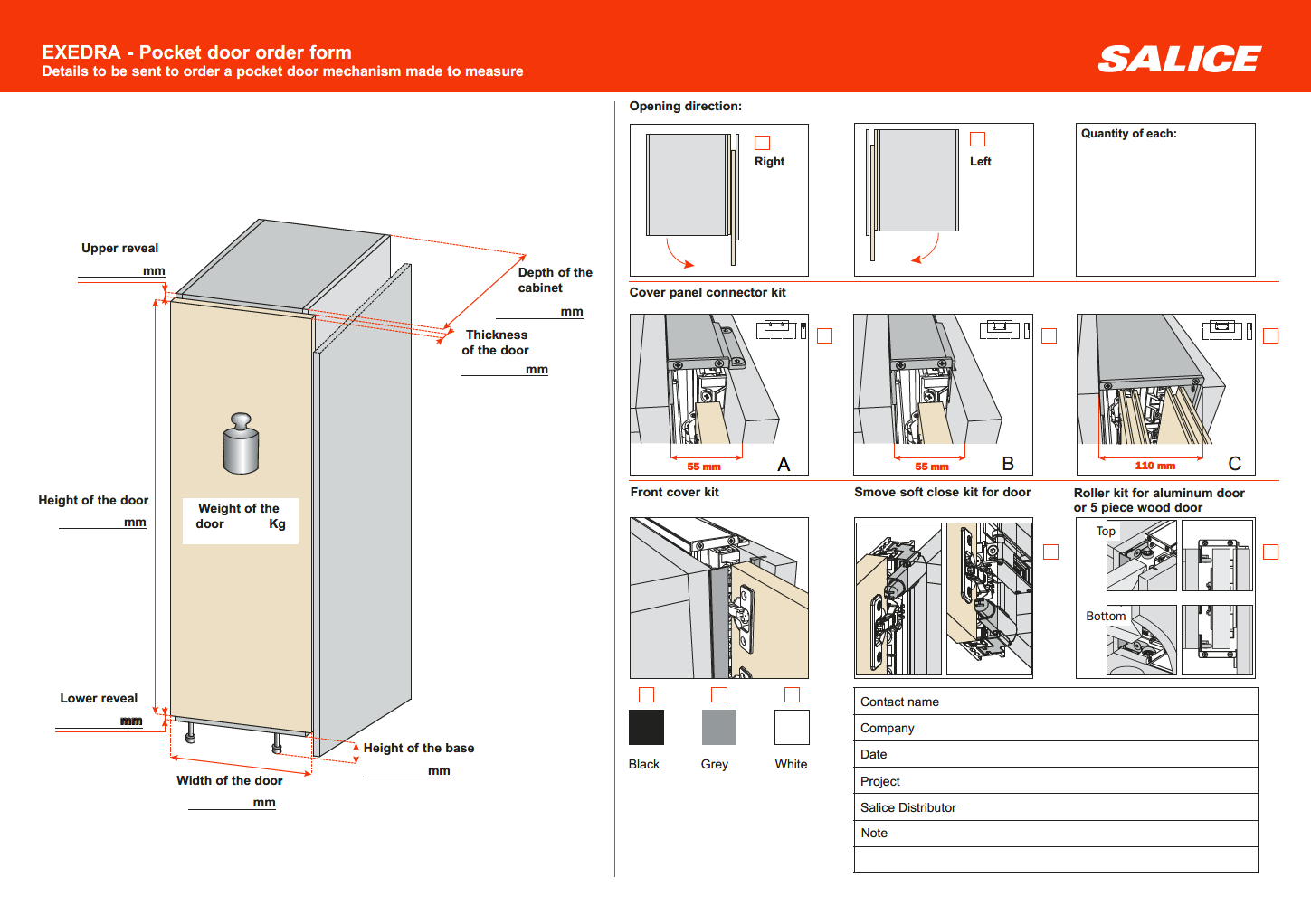

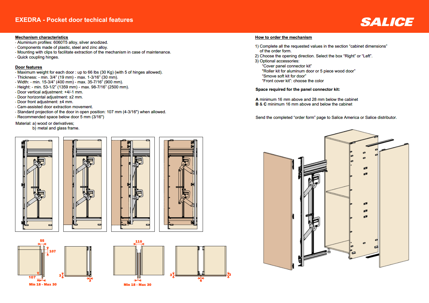

Hey Craig,
I actually thought you were someone else (that I know) and didn't realize you are in Mexico. I will pass your questions on to our agent handling business in Mexico. In the mean time, here is a form to help you determine the system requirements. Inn short, it is possible but the door size must be considered.
Dennis
View higher quality, full size image (1449 X 1022)
View higher quality, full size image (1450 X 1025)

Hi Rich - Just off the phone with Salice and they say such a system is possible given certain parametrics re height, etc. with the Excedra above. They adapt the system to the metrics. The wall has yet to be built, but Salice said a 15cm interior space would be sufficient. Interesting. I need to shoot them off a drawing.
