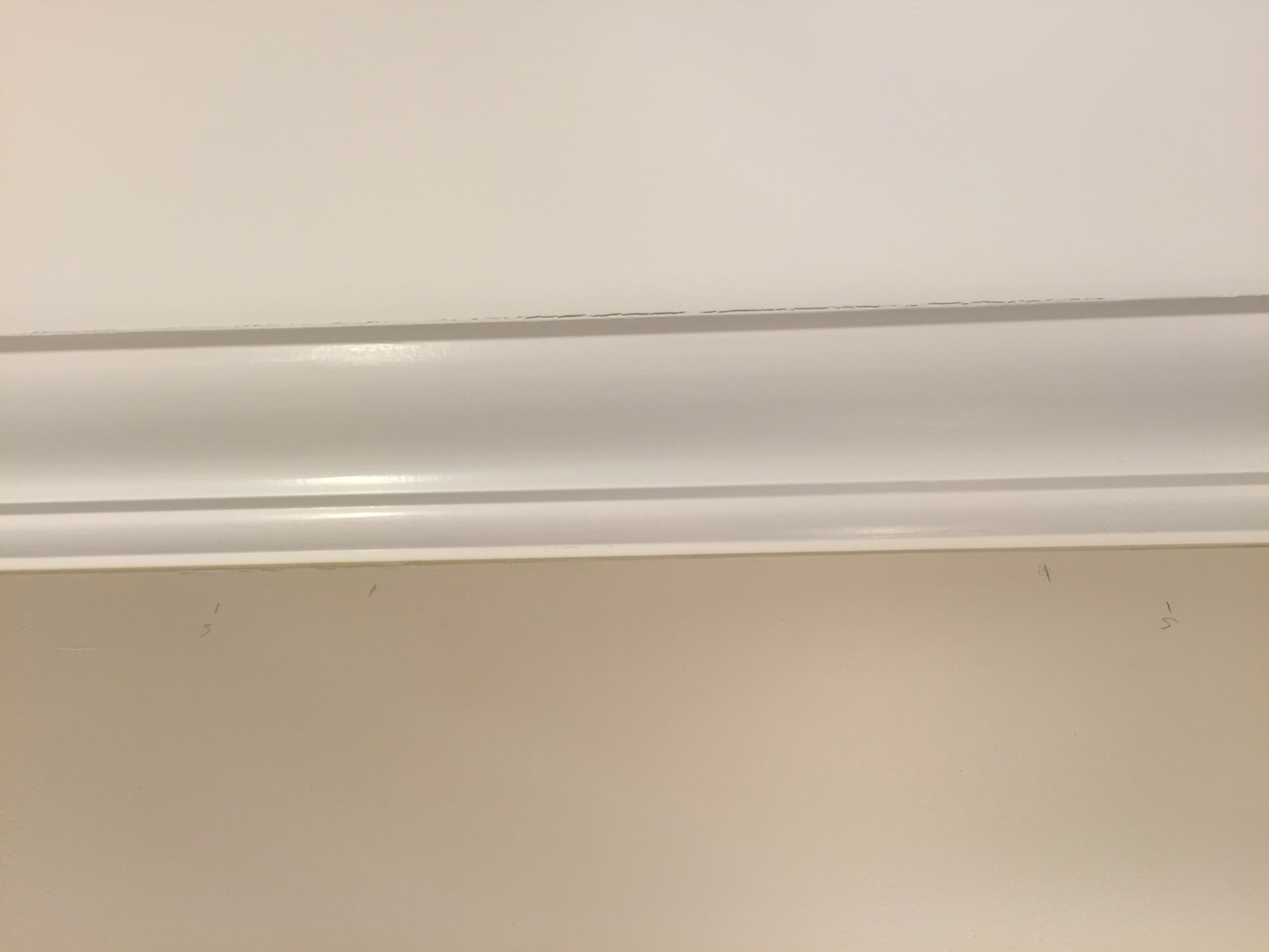

Im back.... 5 months later... Crown is still cracking. I took 3/4" solid poplar and cut triangular blocks, used the last caulk i noted a link for and glued/nailed it to the wall studs and studs and ceiling joists on the two walls.
Why the heck is it stil cracking? This is at my inlaws who have notability told me the humidifier for the second zone (second floor where crown is at) hasnt worked correctly in months). Could the not so moist air do this (no matter what I do)? I used 18 gauge 2" brads.
I'm at a loss for what else to try. Should i run a full 2x4 of pine behind the crown or spent a bit more and mitered solid poplar to nail to? Full piece
