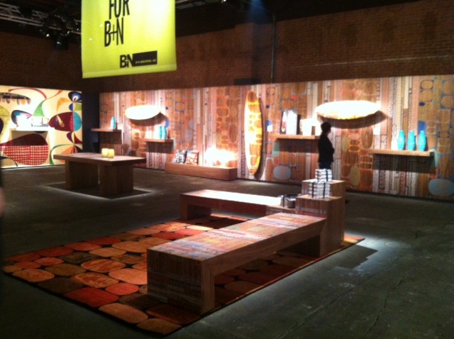

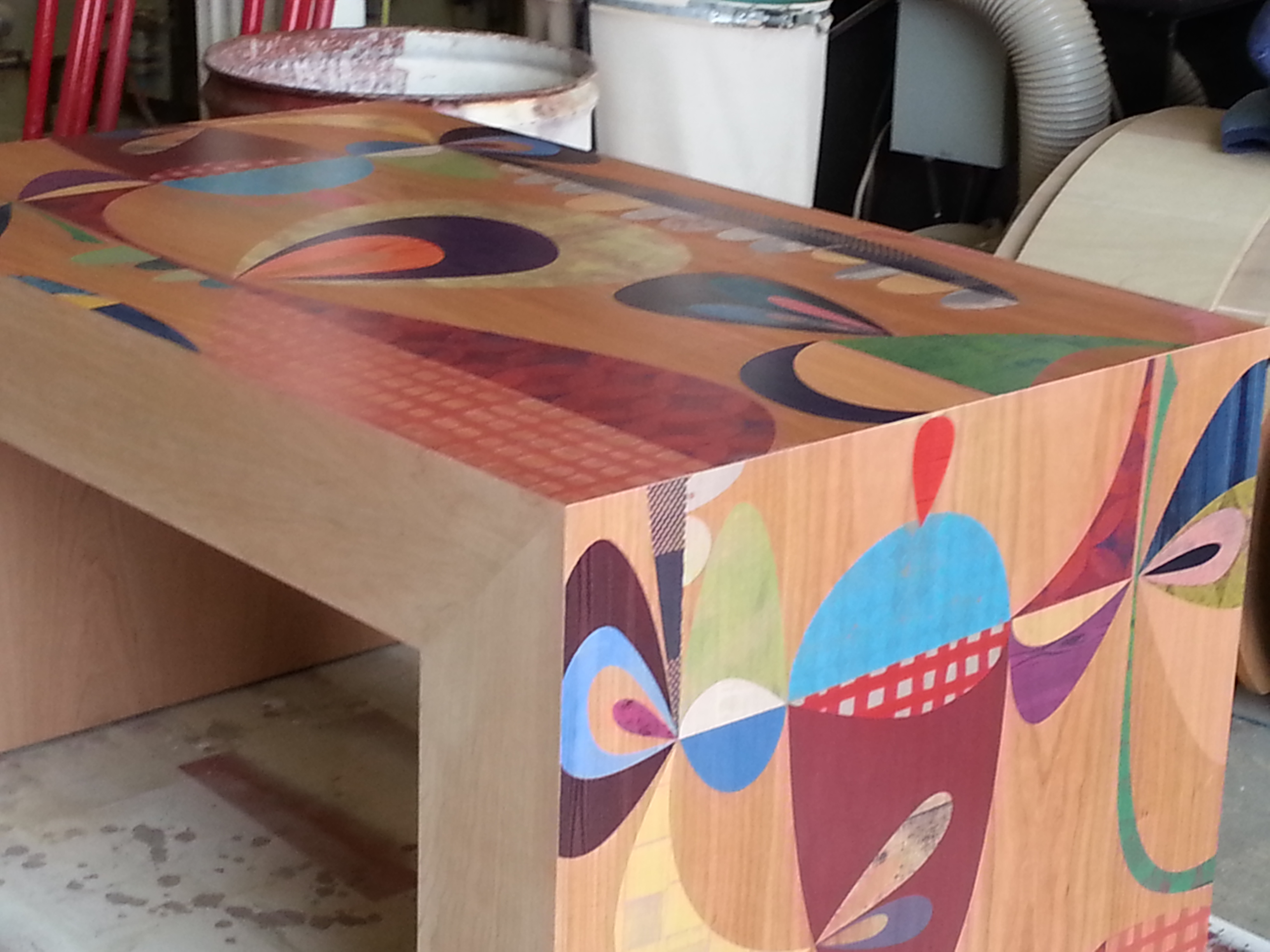

The laser companies can do some pretty trick stuff. We did a whole store a few years ago.
4/8/16       #8: printing on plywood ...
Alan F.
Here is a partial picture of the store
View higher quality, full size image (640 X 478)
5/2/16       #9: printing on plywood ...
Gary B.
Alan,
That is pretty cool. Was it a wear resistant surface, or do you have to clear coat it?
