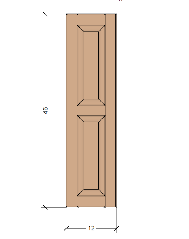

Hi Everyone,
I am making some raised panel doors for our laundry room.I am using 3 " rails and stiles I know how to figure out the sizing for a single panel door eg (12 " W X 24 "L).How do you calculate the panel size when you have two panels one on top another with a 3 " center rail eg(12" W X 46" L) Is there a formula to calculate the panels
Thanks Don

Measure your cutter depth and figure the math. There is a formula, but you to make it to correspond with your cutters and stile and rail size.
Probably the easiest and safest way for you is to make the frame, dry assemble it, center the mid rail, measure the opening, add the groove depth - about 3/32-1/8" for panel movement or space balls.

I have attached a pic of a 12x46 door you described. I also attached a cutlist for the door as I make my raised panel doors.
When making hard wood raised panels doors, I use a cope and stick construction method.
The grove that accepts the panels is 3/8" deep.
To allow for wood movement I leave a 1/8" space and use a rubber barrel to maintain the space. The are just like space balls, but do not weep oils.
The math to figure the length of the panels is (Stile length) - (Top rail width) - (mid rail width) - (bottom rail width) + (the grove depth on Top rail) + (the grove depth on Bottom rail) + (the grove depths of the mid rail, there are two sides). So it is (46-3-3-3)+(3/8+3/8+3/8+3/8) now subtract the 1/8" (x4) for movement in each rail.
(46-3-3-3)+(3/8+3/8+3/8+3/8) - (4 x 1/8) or (1/2). Now divide by two and you have two equal panels.
Do the same for the width. You end up with two 6 1/2" x 19" panels.
If it would help. Post your door sizes, the groove depth you plan to use, and how much you wish to leave for your movement a, I can generate a cut list for you. Not as much fun as figuring it yourself, but it is accurate. When you make as many doors as I do, it helps.
Good luck
Joe
