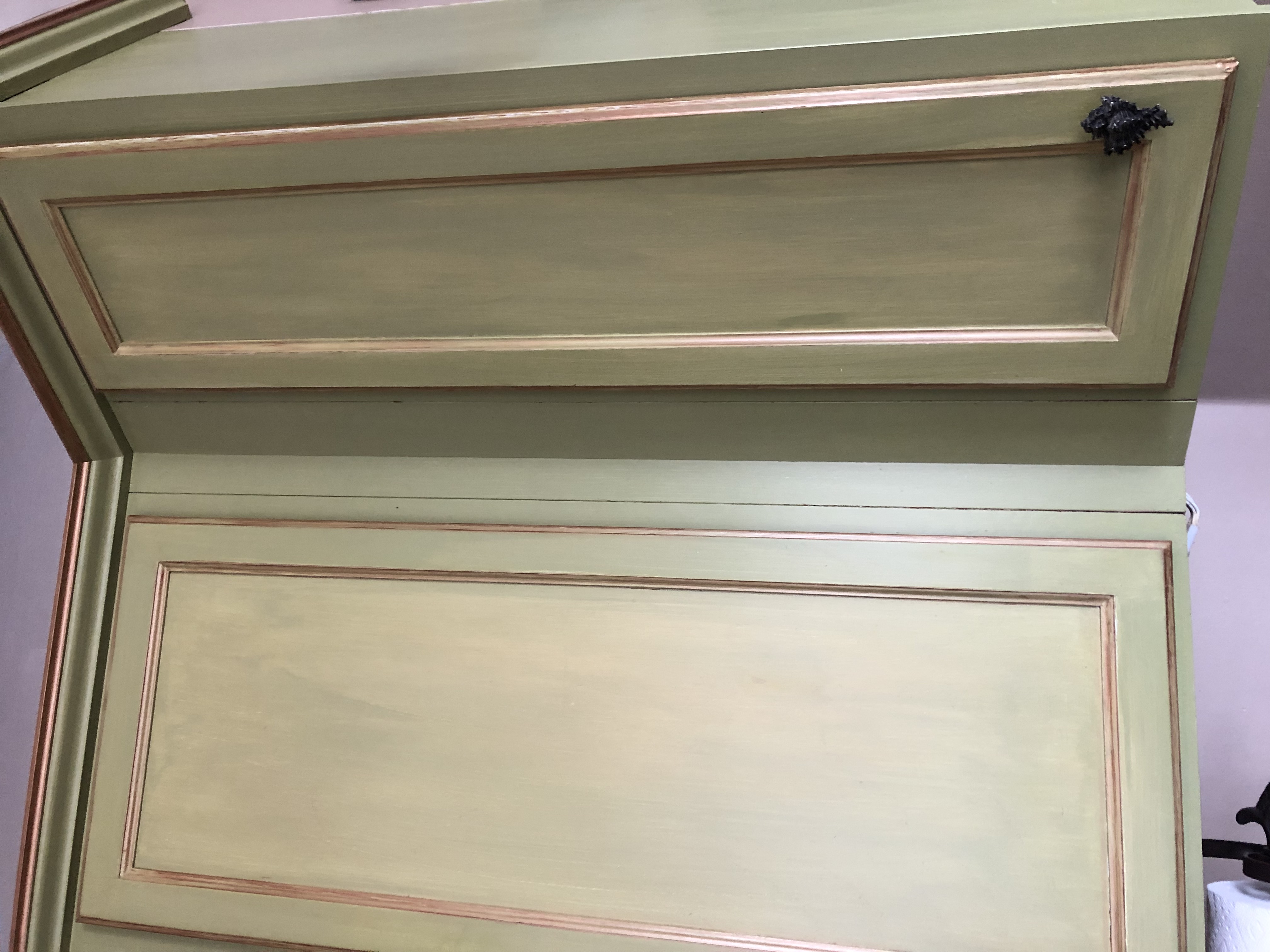

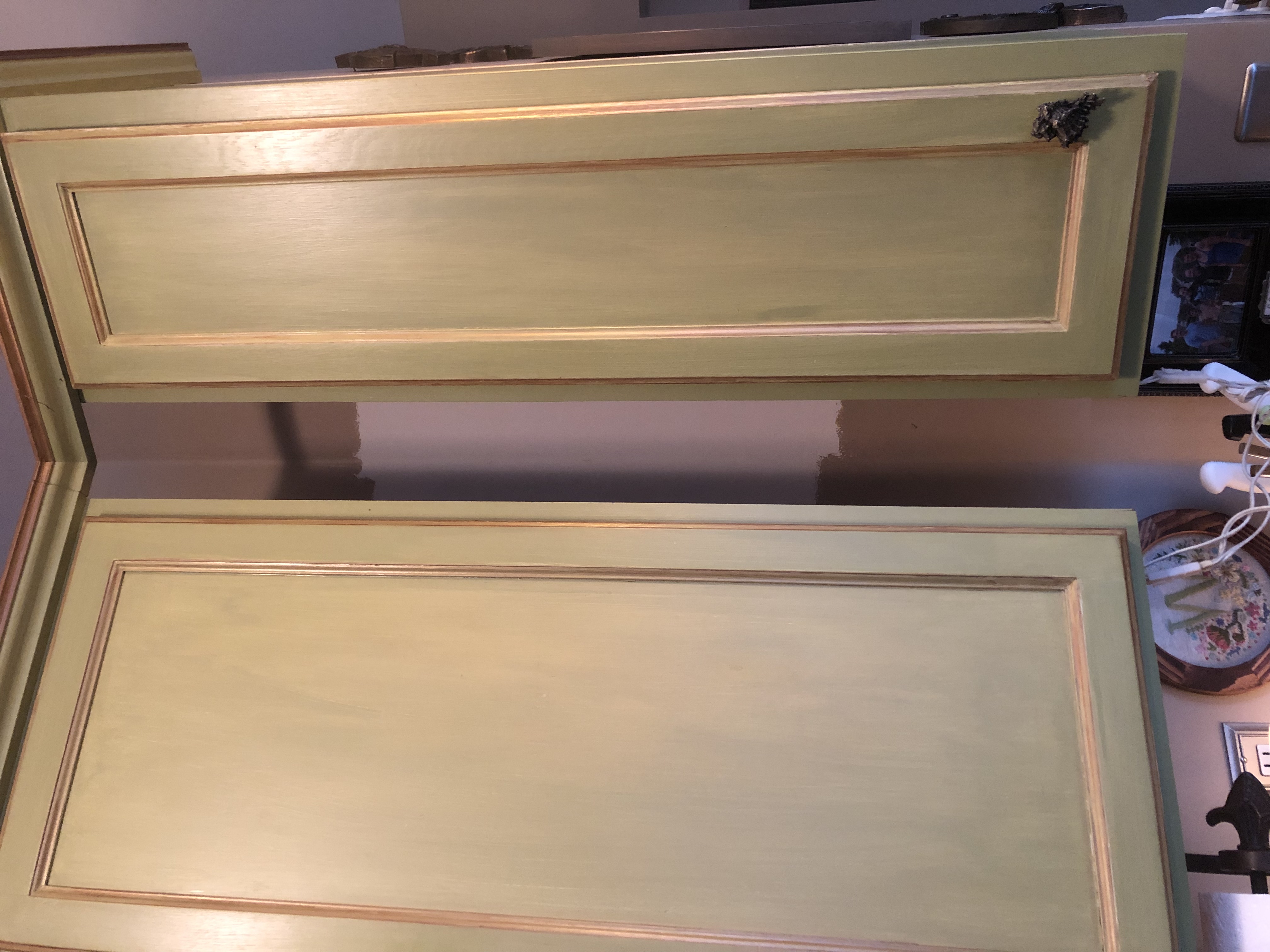

I am installing a Rev-A-Shelf upper wall spice cabinet into a blind corner where I have removed the filler strip. The manufacturers instructions suggest affixxing to an adjacent cabinet but as I stated, it is in a corner. My question; is it best to secure to adjacent cabinet in which it will pull out at an angle to the corner, or create a shelf to secure to so that it pulls out straight from the corner? If option 2 is the way to go, which is more pleasing to the eye, any suggestions on how to go about making the shelf? Thanks in advance for your assistance.

Client specified but my default would be for it to pull straight out of the corner. If there is an appliance there however it may be best for it to pull out at a right angle to the face of either cab.
Would seem your customer would dictate what they want for use?

Since it's a corner installation without a filler strip, it's better to create a shelf for the Rev-A-Shelf cabinet to pull out straight from the corner. As for aesthetics, a custom-made shelf matching your cabinets would likely look more pleasing. You can make the shelf using plywood or a similar material, ensuring proper support and alignment. Good luck!
