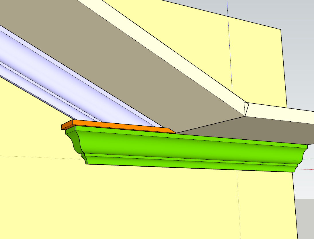

Gene Davis
Here is a pic of a way to handle the interface. Think about exterior trim, how a raked crown at a gable resolves down at its bottom end atop a roof return.
You don't have a roof return, but you can apply the concept. Run the level crown past where the ceiling springs up, and far enough so you can self-return it to the wall, cap it with a piece of 1/2 inch something (miter the cap if you are anal like me) and then your raked crown can begin from there.
View higher quality, full size image (1095 X 835)
