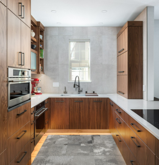

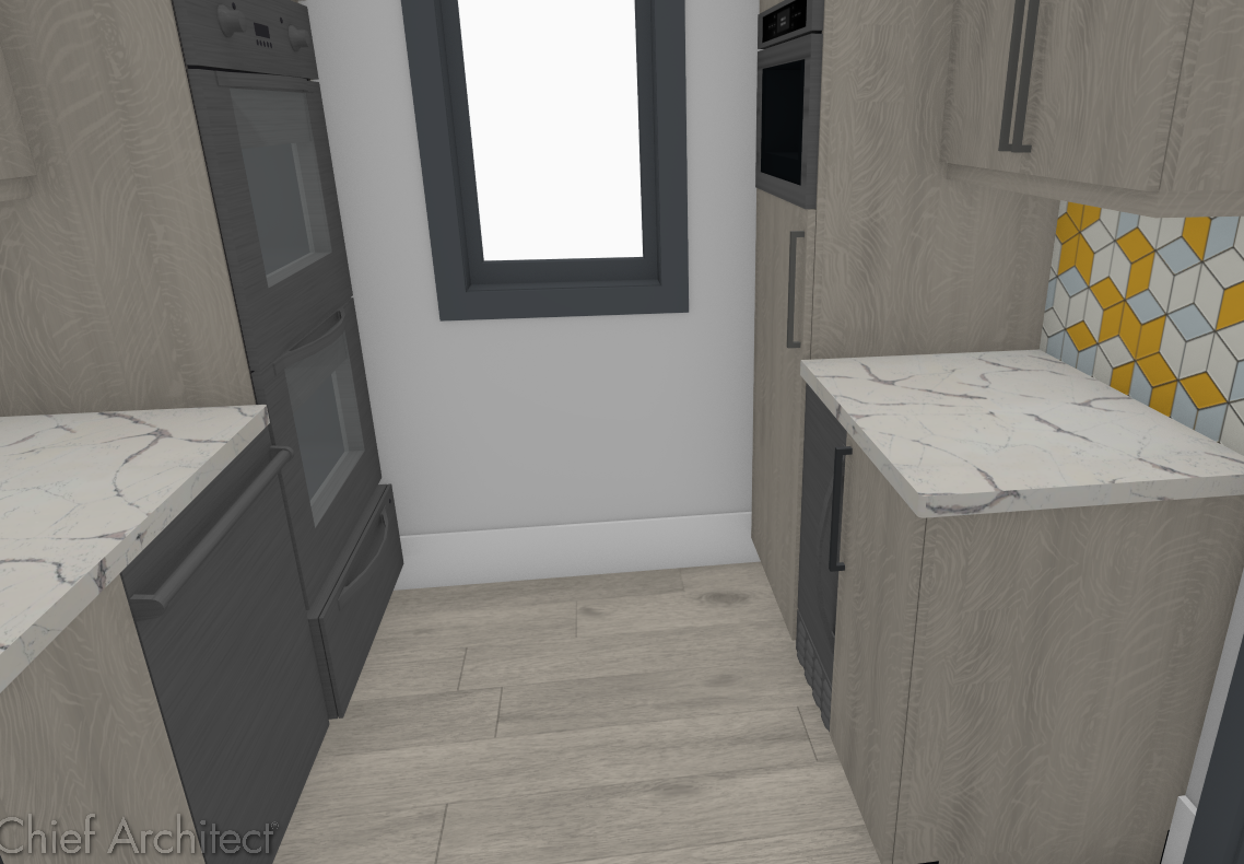

I'm a fan of having the tall cabinet front out from the front of the adjacent basecab run, just enough so the countertop resolves nicely into the side of the tall, without its edge sticking past and needing a radius corner.
Tall cabs can be ordered from most all the manufacturers with an extended side sticking out the rear. 1-1/2" works nicely so the installers can screw 2x lumber cleat/spacers to the wall right behind where the tall cab goes. It's easy for us because we get our jobs CNC cut and the cab build software permits any extension we spec.
Are you seeing this extra-depth-side-for-tall thing never, or mostly, or just occasionally, and what is your opinion of doing this, versus not, and letting the countertop supplier just doodle the corners?
Two pics attached. One a photo, showing the tall with its face out just enough to make the c'top resolve, the other a 3D render of flush talls, and c'tops needing the radius corners.

I have the exact same scenario going on with a bathroom project right now.
It is a linen cabinet next to the vanity. They are inset cabinets so the linen cabinet I am building it to be 1-1/4" deeper than the vanity cabinet. I feel that looks much better when the counter top can die in to the wall of the tall cabinet rather than stick out the overhang dimension.

Mark B Member
I always run the tall cabinets deeper than the bases for the same esthetic you mention but if I have an instance where the tall must be the same as the depth I specify horning the countertop around the edge of the tall cabinet. Countertop fabricators (especially quartz/granite/etc) belly ache about it endlessly but I just demand it. If we are running solid surface in-house we just do it by default.
Nothing to me looks worse than a countertop overhang not horning around the adjacent cabinet even by 1/2"-3/4". It just shows intent.

I usually make mine 25 1/4" deep for inset cabinets.

I do the same. Everything has good detail. Not eye catching. Especially in modern cabinet design.

Jim
Oven/pantry/refrigerator cabinets 24 3/4" deep with 25 5/8" applied finished end
Kitchen base cabinets 23 3/4" deep
Usually countertop at 25-25 1/4" depth

D Brown
I make the tall cabinet 2" deeper than the base to allow the inch and a half overhang of the countertop to die into the edge of the tall cabinet looks very deliberate instead of an oversight.

It's typical to treat the oven cabinet as a unique appliance cabinet, just like the pantry or refrigerator. When you are building a custom kitchen, I would expect it.
