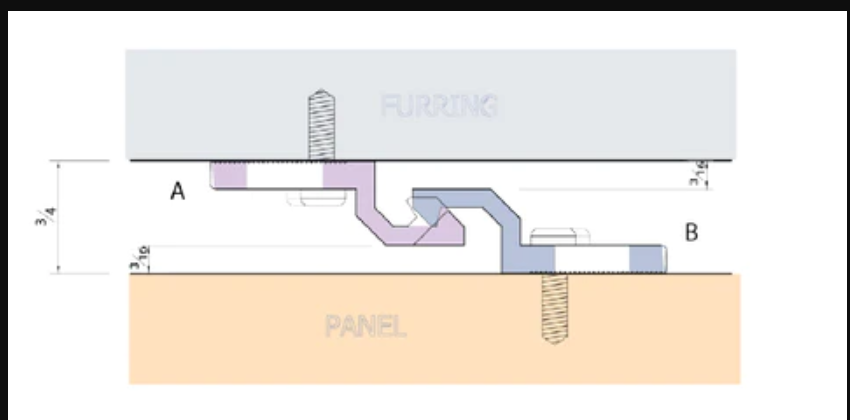

Andy Bertolozzi
Have had success with these in the past.
star zero 510 ceiling clip
View higher quality, full size image (850 X 420)
1/18/23       #5: Architectural Wood Ceiling installa ...
Mike W  Member
Thanks for the feedback guys. Mechanically fastening through the face is not really ideal with most of the work we do, and not possible on plam applications, but I think these star zeroes may be an option. Appreciate it.
