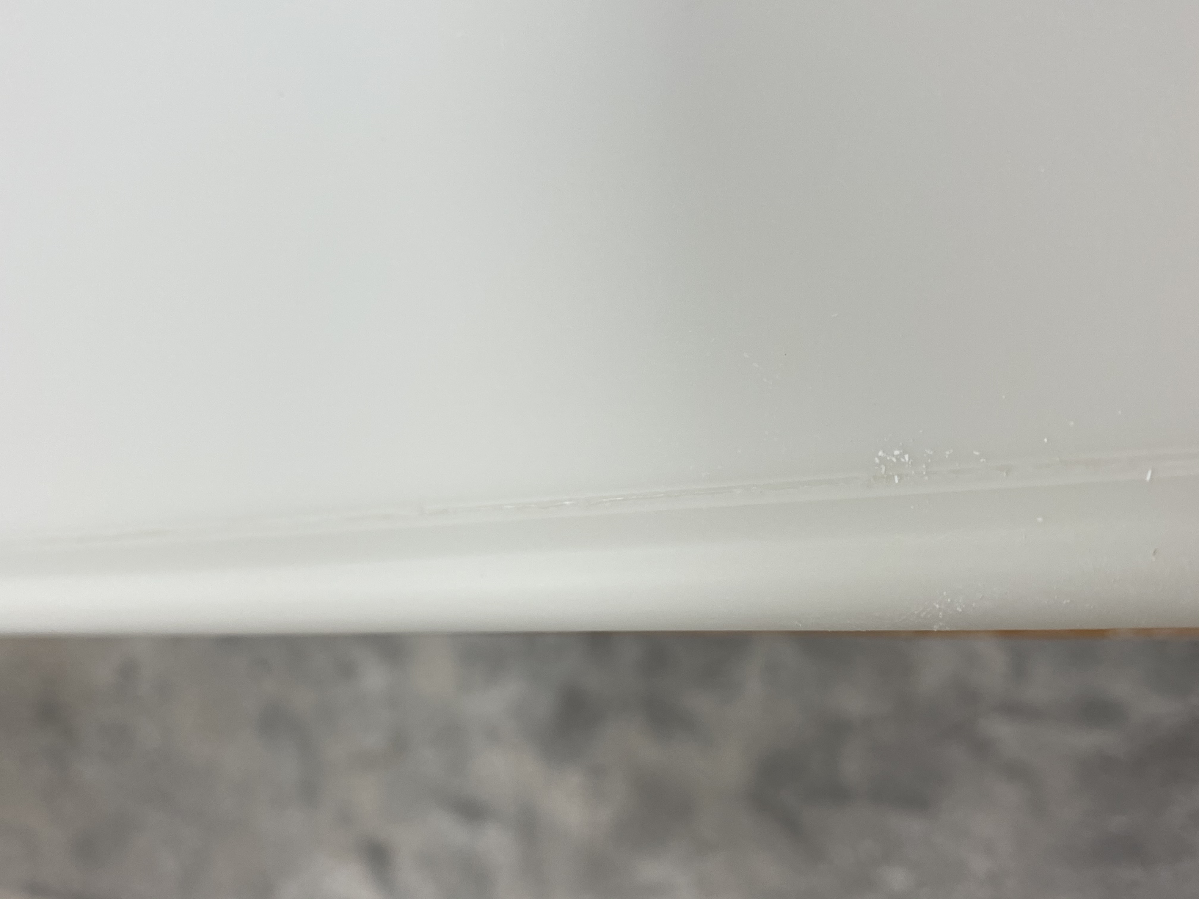

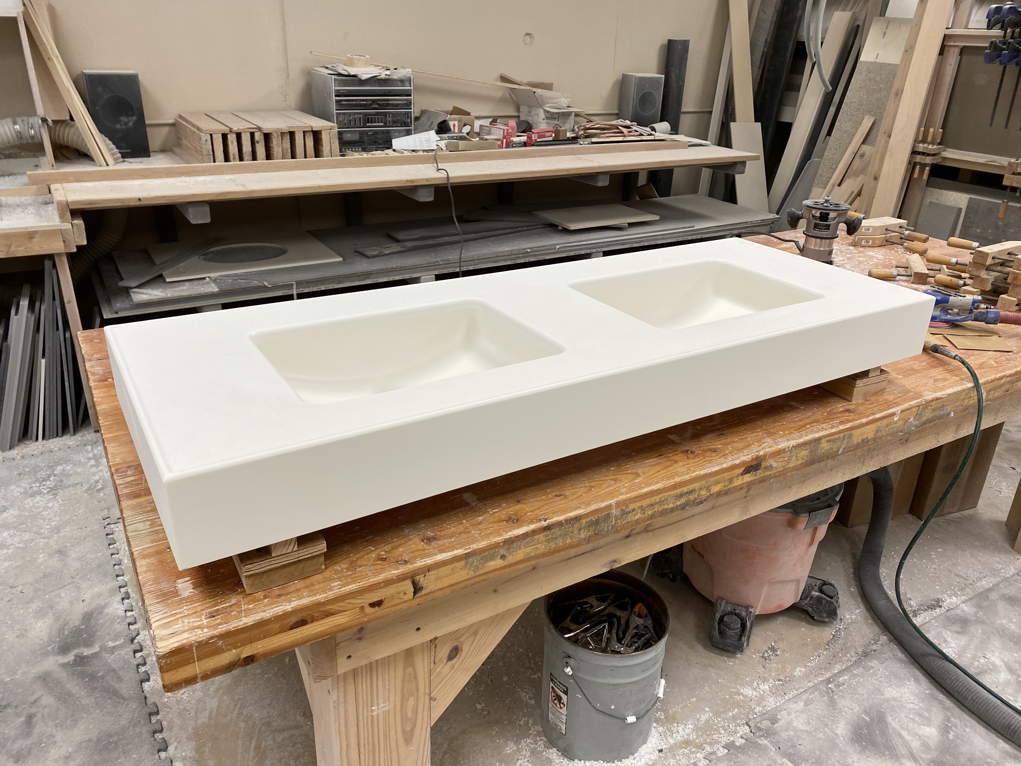

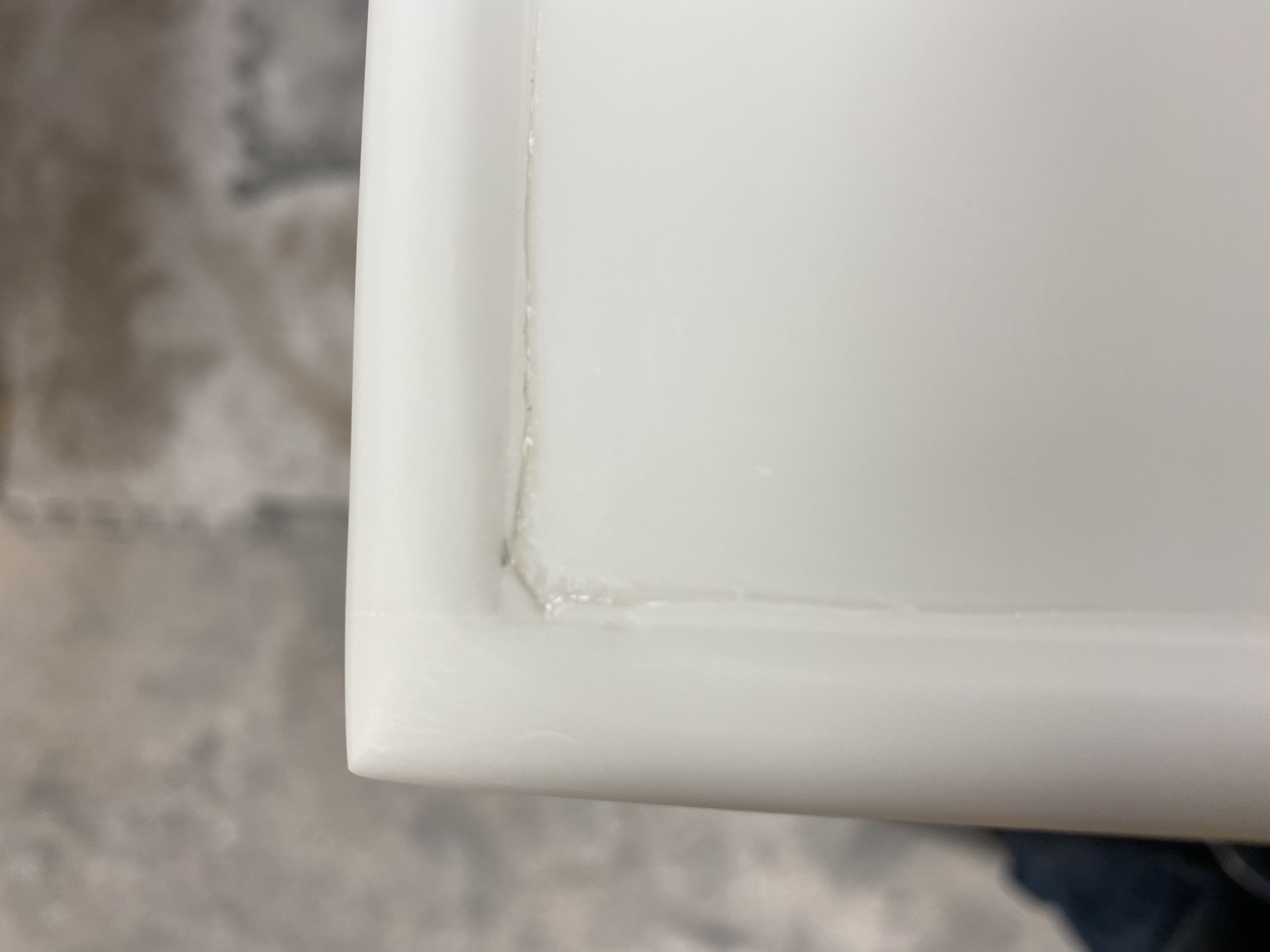

Hello, I am having a problem with a product I make infrequently, and every few months when it comes around I experience the same frustration. I know there has to be a better way.
This is a no drip edge for a sink. The joint is made with 1/4" proud of the surface and then rounded over with reverse bullnose bit. The problem I have is sanding and finishing that inside edge and the inside corner. What or how are you all handling this?

If I did these on any frequency I would be setting up an inside corner cove jig for a trim router with a small ball nose bit where I could just sweep that inside corner right into the 90 until its clean an be done.

If you have access to the continuous joint edge during fabrication (no clamps in the way), run your acetoned, gloved finger down the wet glue line, much like shaping caulk. This should get you 95% of the way there, then the cove sander is the tool of choice. 3m makes small flap wheels in various grits to polish out that fit into a rotary tool.
